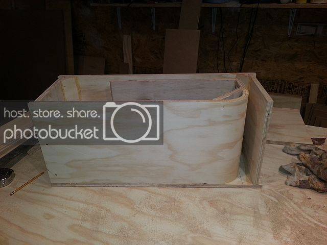

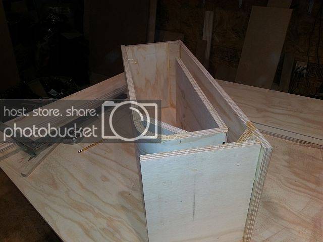

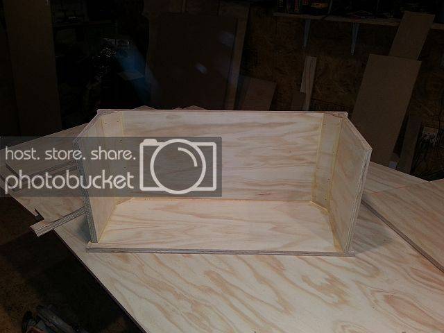

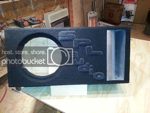

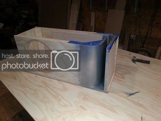

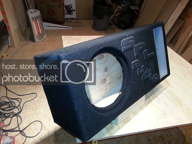

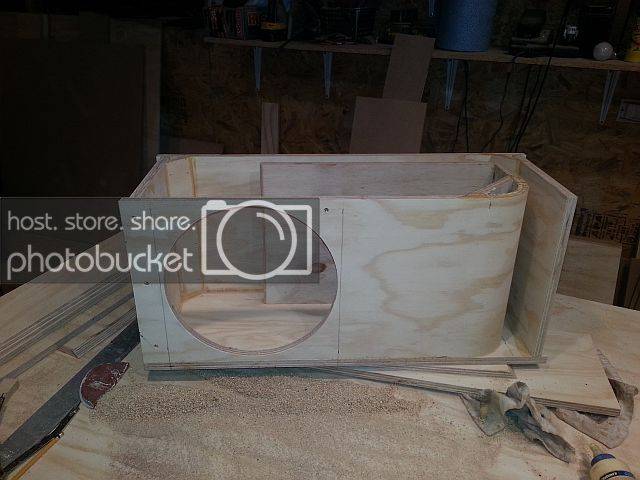

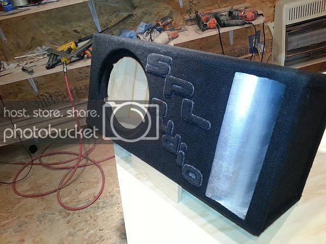

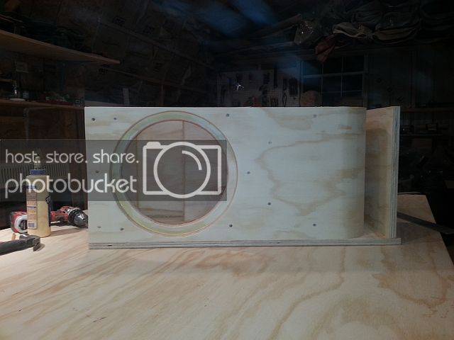

Single 12" RD Sonance that is being re coned by SPL......Flush mount...kerf port...silver accents.....black carpet.....SPL logo.....1.5 cubes net.......32hz........Arauco construction
Looks sick man cant wait to set it up, waiting on some parts splaudio had to order looks like things are coming together really nice and going on my cadence daytona dca 1000.1. i know i am getting top notch build quality when it comes to starr mountain sound

i went ahead and upgraded to arauco with my box as well. cant wait to see how yours turns out. might be adding accents to mine before double07 starts it. box looks nice.

looks good!
yea i ran out of 12" 4 spoke baskets but should have tomarrow.
looks like tax time started early im slammed with sub working late in the nite to get them out in 3-5 days....
looks good!
well worth the wait for top notch quality. good things come with patience. no taxes for me stupid fiscal cliff has put me on hold because of my deductions have been delayed
i can tell thats a daily box.
i have played so much with slot ports.
flaring front few 10th
flaring rear of port few 10ths
making outside corners 45 degree loose few 10ths
rounding over the ports inside 90 degree bend over a db!
add a pvc pipe cut in half rite after flare on the outside of the box from .8-1.2dbs my experience.
