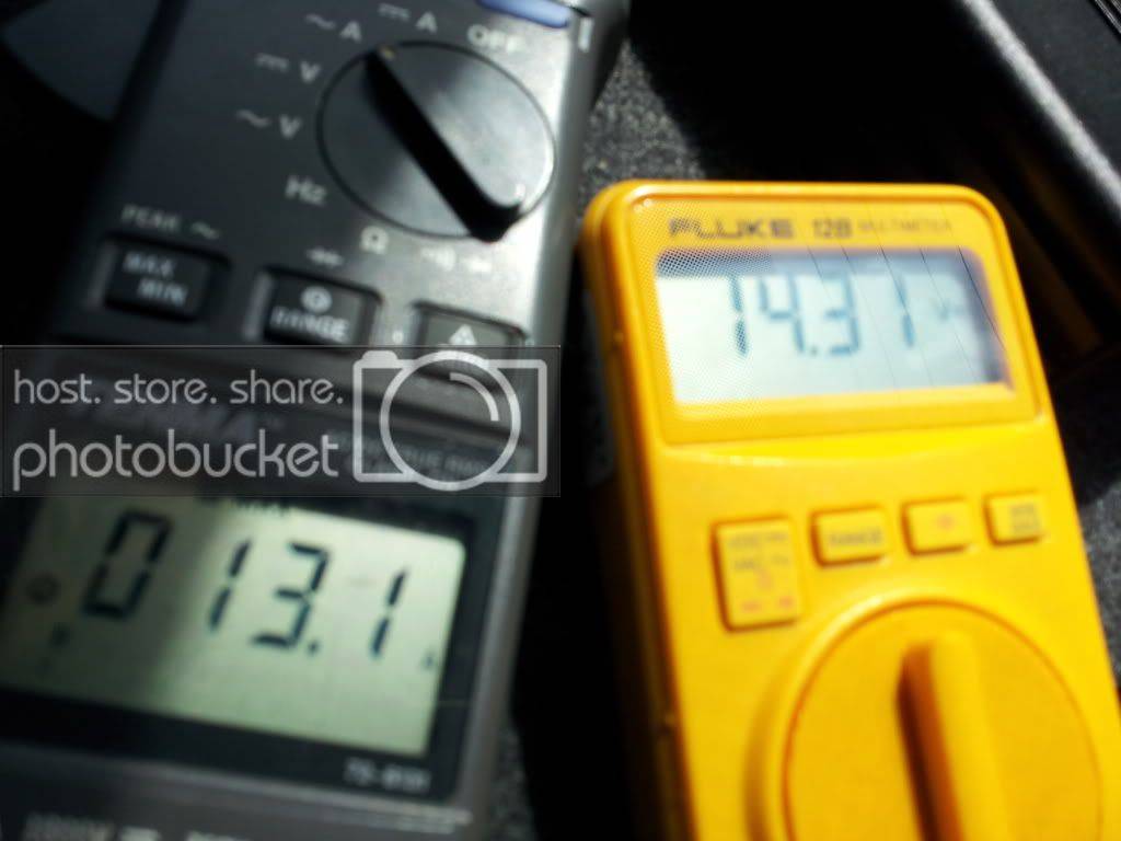

This was done in a 06 cobalt with no electrical upgrades ,note the battery's factory location is in the trunk. voltage was noted at 14.3v with the car idling. voltage dropped to 13.7-13.4 during burps. The gain on the amp was set to max. volume was adjusted at the deck until clipping was observed at the amplifiers output.
voltage at idle. Ignore the amp meter.

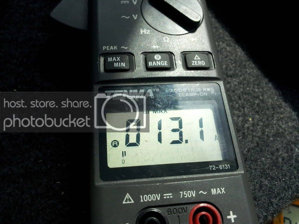

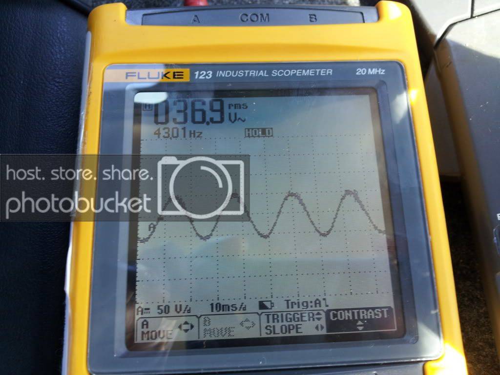

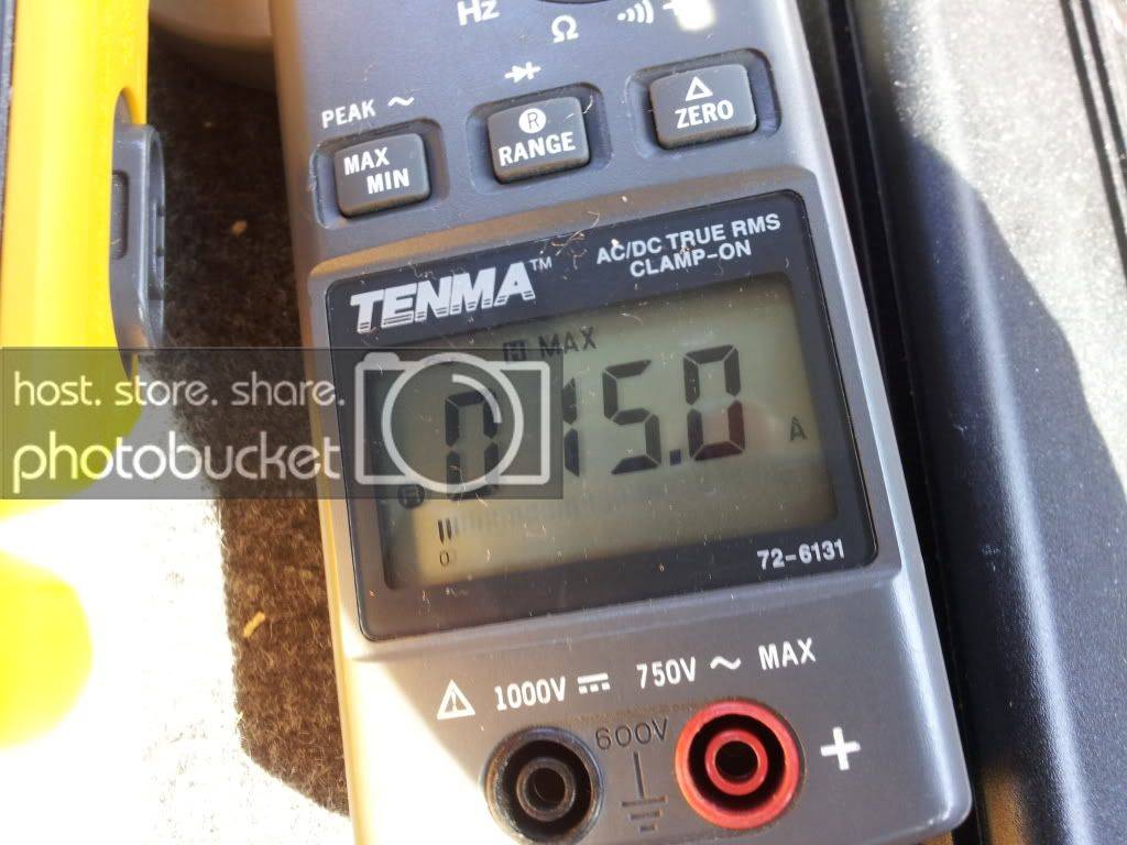

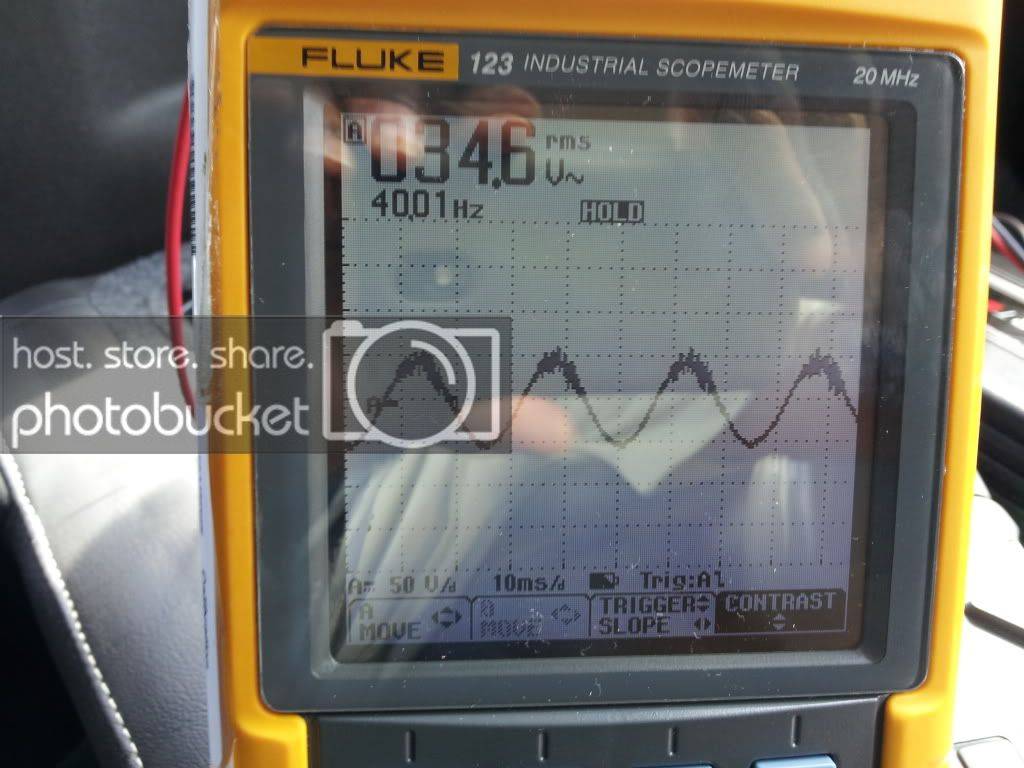

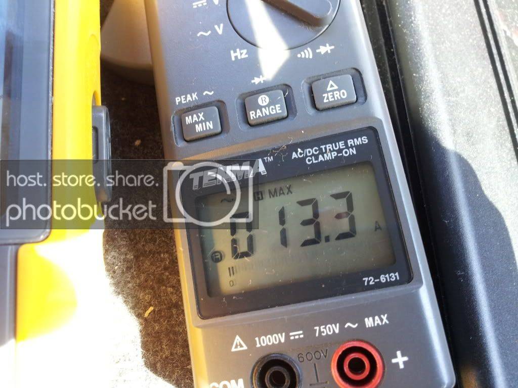

voltage at speaker terms at the amp 34.6v the load was 2 MTX 4500's wired to 2 ohm.
At 40Hz .
34.6 x 13.1 =453.7 watts RMS @ 2.641 ohms
(If you take 34.6v and put it into an even 2ohm load the math comes out to 598 watts. )

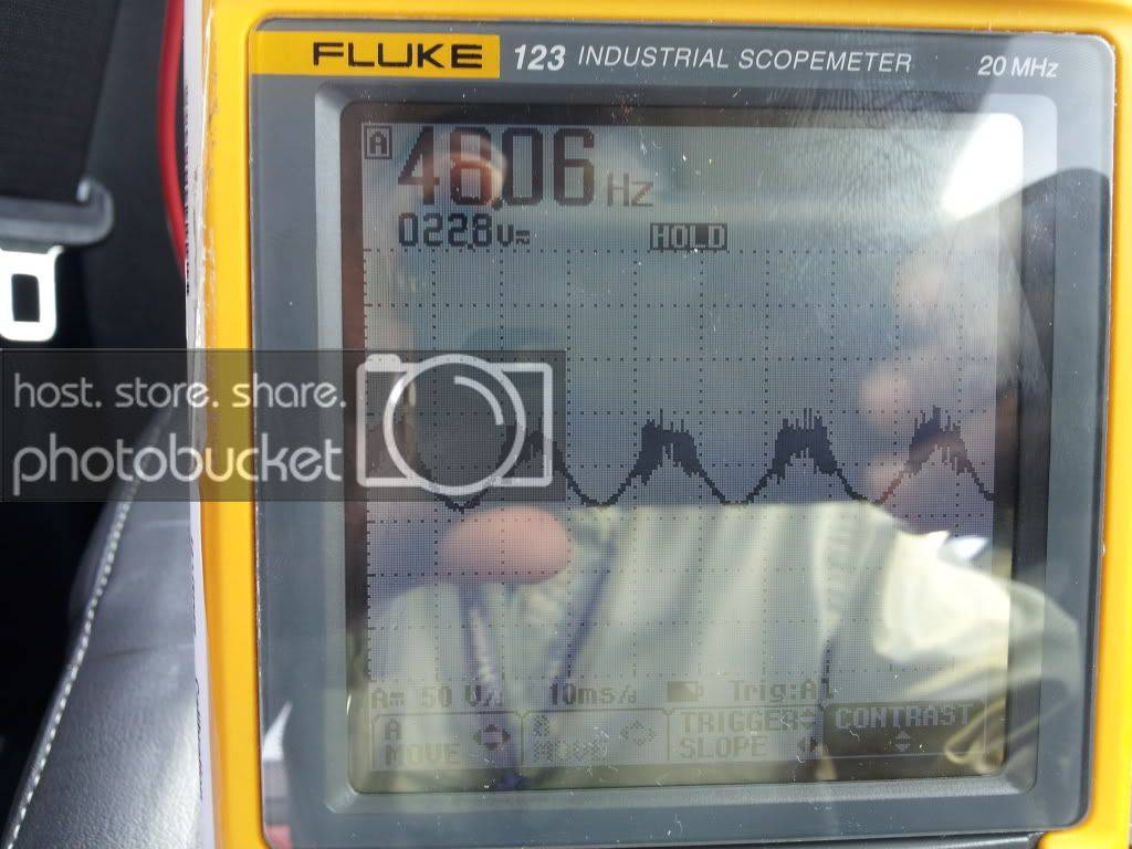

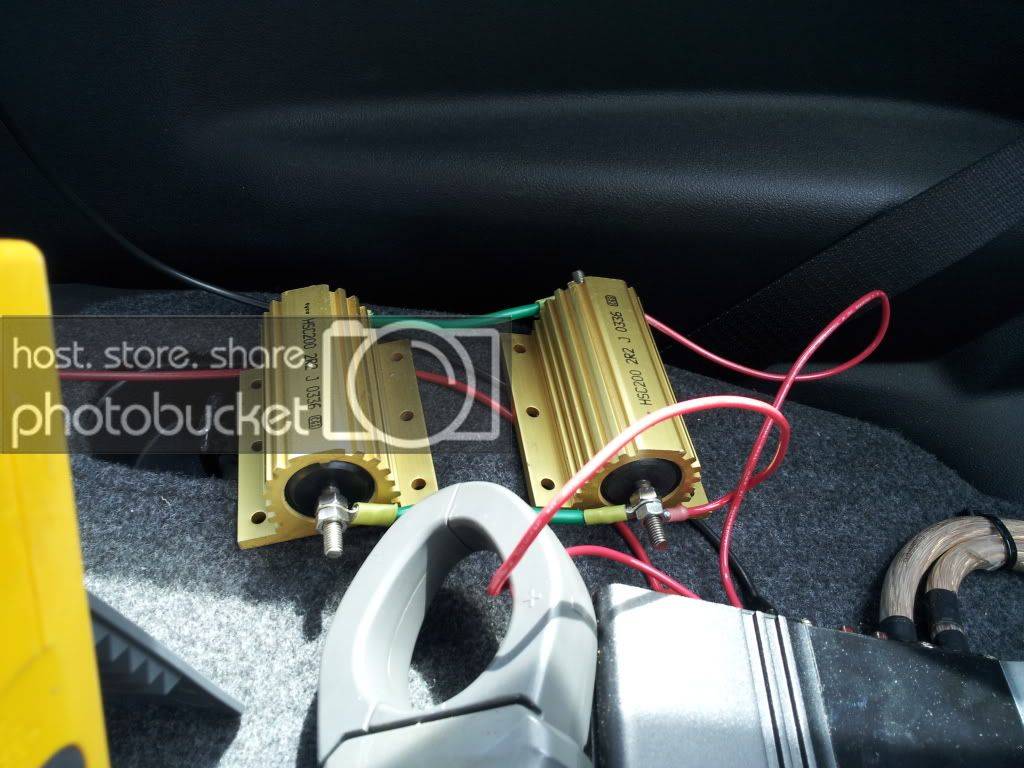

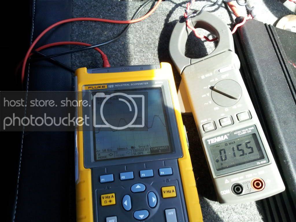

I tried this at 1 Ohm using resistors. I also did this with the car off and at 48hz the amp started to make an audible hiss from the chassis as the signal began to clip so i stopped i may try again at a lower freq with the car running i didn't have time play with the setup today(lunch break ended)
22.8v x 25.1A = 572 watts rms @.908 ohms... i think this may be due to the voltage drop with the car not running, that or the amp just cant do rated power at 1 ohm.
Id also like to note im using a line level converter , my next task is to see if that noise is due to my setup of produced by the amp.
Yeah... I'll take a look at the input sig Tomorrow. Keep inmind that this amp is imbetween entry level and the onyx. Im curious as to why noise is only present onthe top half of the sinewave
Ok so i went back out checked my source, and its surprisingly clean. so i checked the ground for the amp. cleaned the contact patch and re torqued the ground and the noise seems to have gone away.
I was able to get 643w @ 2.66 ohms(42Hz) (corrected to 861wrms @ 2 ohms,which would be mean the amp is under rated. but as you can i had to drive the amp into clipping to achieve this. so that corrected number is a little misleading .
492 watts @ 2.77 ohms(43 Hz) (corrected to 684wrms @ 2 ohms)
553wrms @ 2.46 ohms (43Hz) (corrected to 680 wrms @ 2ohms) not sure what caused the impedance shift ,maybe heat?)
