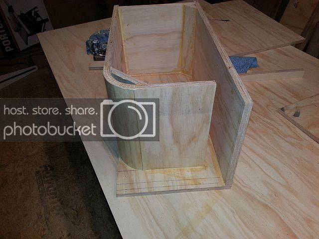

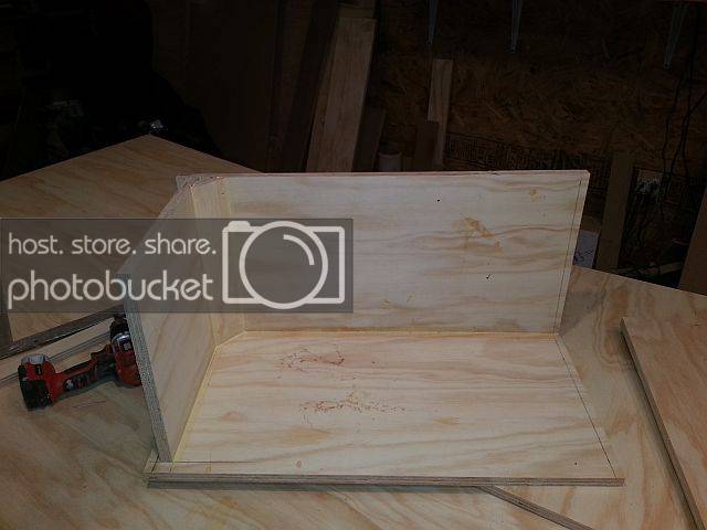

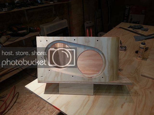

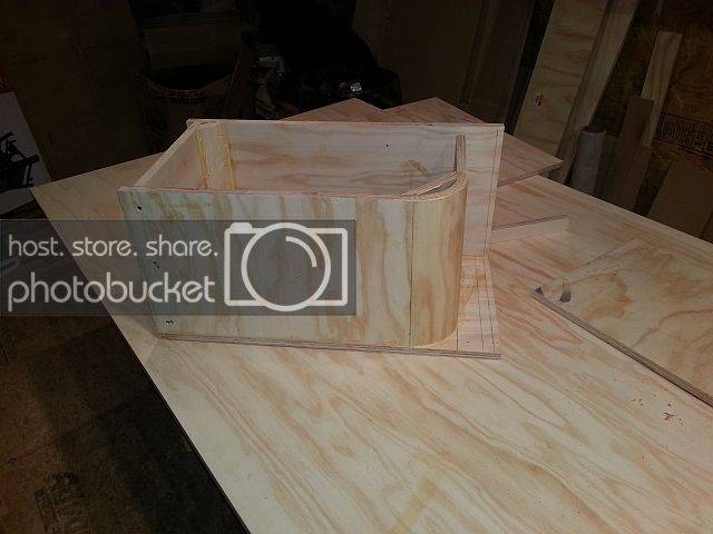

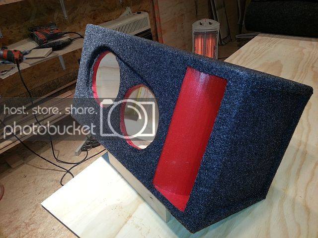

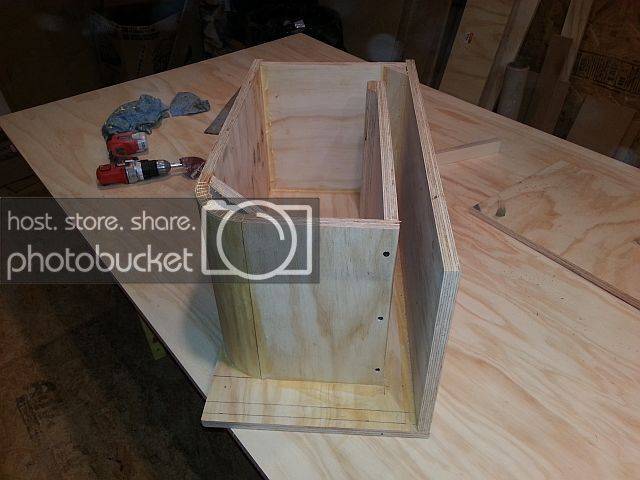

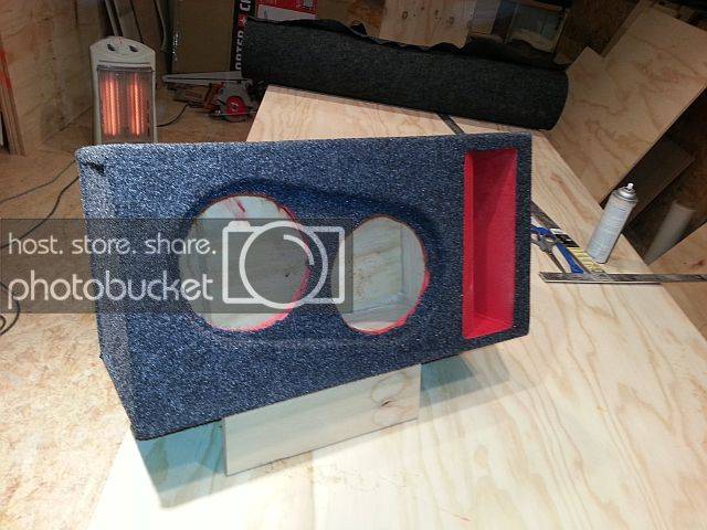

Pair of SPL 8s ......1.26cf net....32hz....kerf port....flush mount.....Arauco construction....
its for 2 SPLaudio 8's. and black is fine for the port. :)
Matt
Edit: a darker metalic green would look cool, but idk what colors you have available and i dont want to add to the cost.
hell yea. cant wait to get it and put it in the car!
which end did you make thicker for the amp? it looks like the port side, but i want to make sure.
Matt
Matt
the opposite end from the port is the thicker end......Its an 1 1/4" thick....
thats what i cant wait for honestly. i was going to just get a barebones ported but decided to spoil myself a bit and make it look nice. i cant wait to get these subs in a propper enclosure. i will definatly be posting pics as well as a vid if i can.
