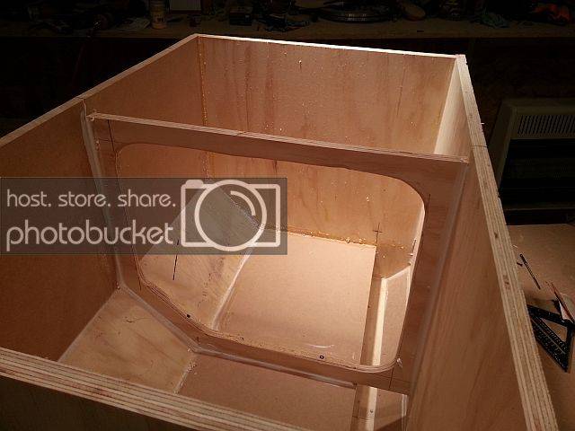

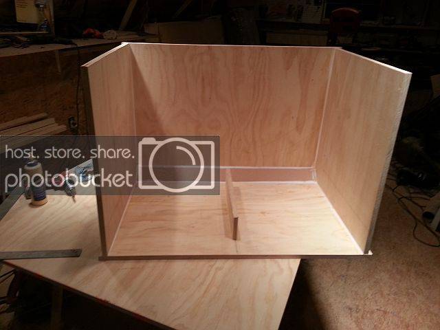

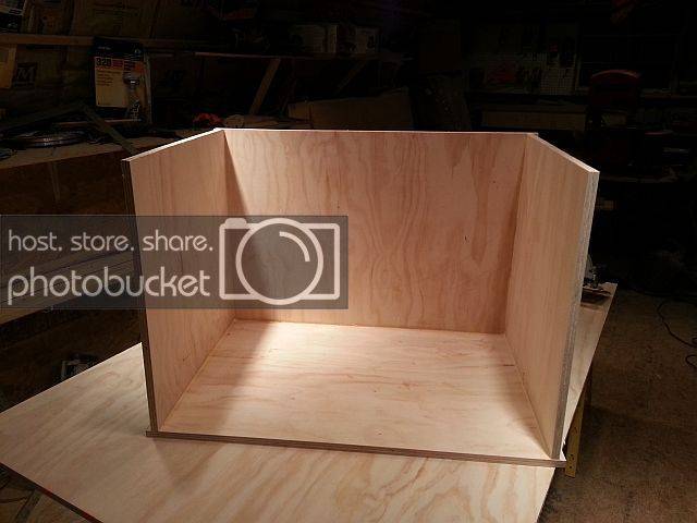

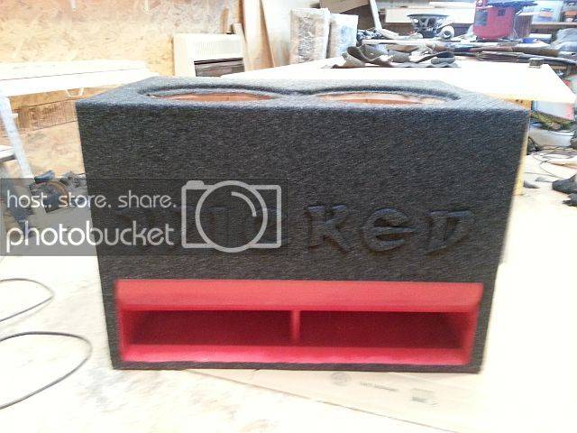

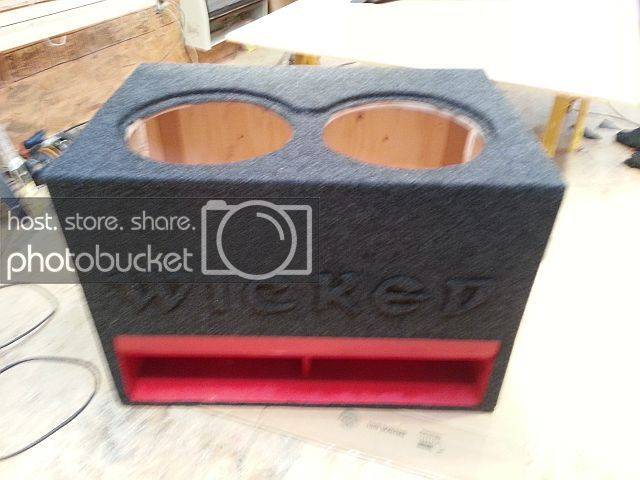

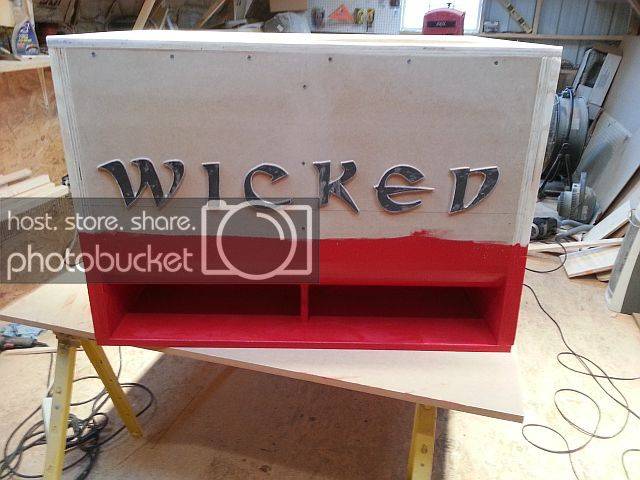

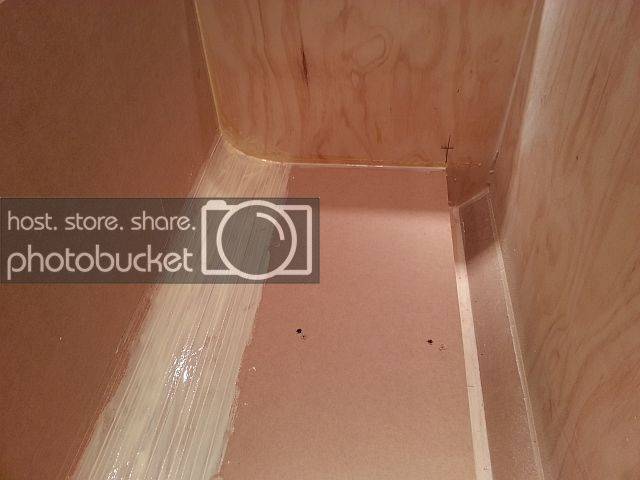

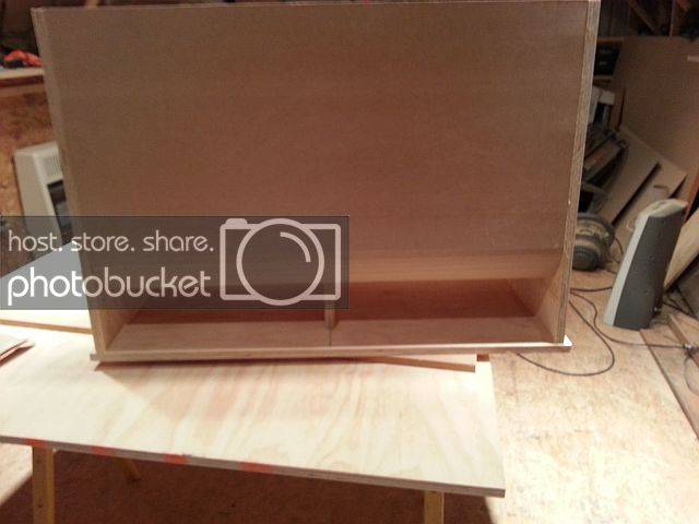

This is going to house a pair of X-Con 15s....Subs up/port back...8 cubes net...33hz.......Going to be wrapped in dark charcoal carpet, cherry red kerf port, raised lettering above port "Wicked" and custom double top baffle.......Enjoy

looks nice..what wood is being used?birch?//content.invisioncic.com/y282845/emoticons/biggrin.gif.d71a5d36fcbab170f2364c9f2e3946cb.gif
Thanks.....The main enclosure is Arauco cabinet grade ply and the port wall is MDF...The mdf is just a little bit easier to kerf than the Arauco......lol....when I am done with my bracing he won't tear it up....lmao
Thanks guys for the compliments....The shipping is all on Caddie.....He called his shipper before I started the build with a size and weight so hopefully they quoted him accurately.....
