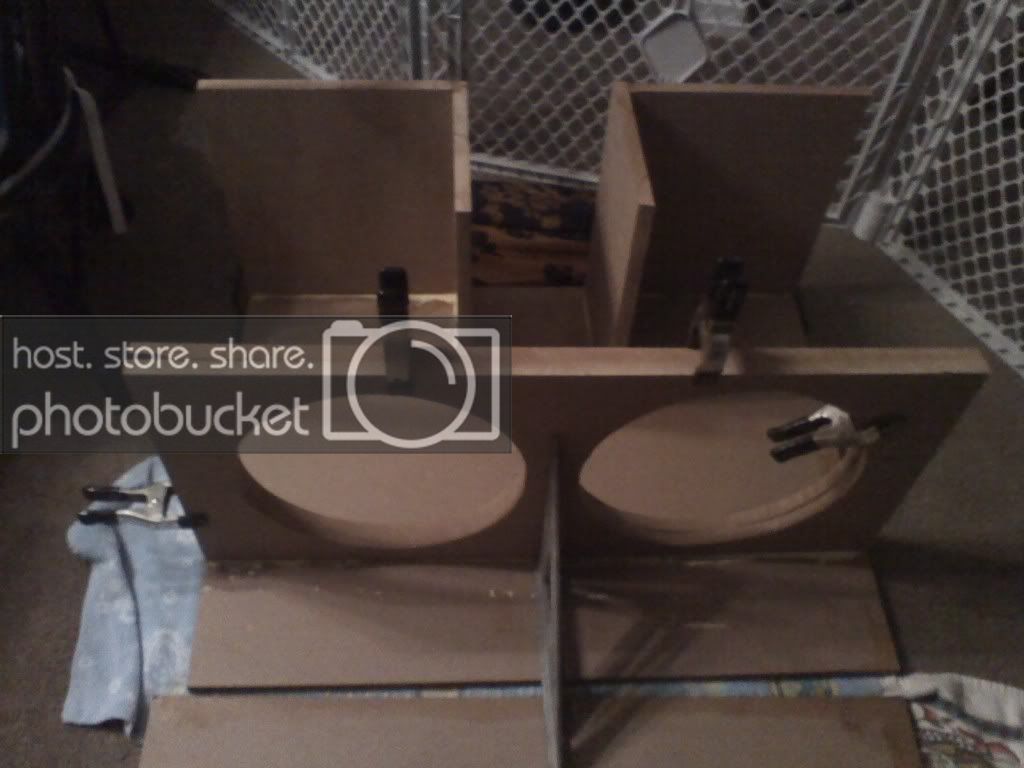

4th order bandpass designed by 80 inches
38 wide
27 deep
18 tall
sealed chamber is 2.52 cubes and the ported chamber will be 5 cubes after port and sub displacement, tuned to 59 with 132 sq in port (16.5x8)

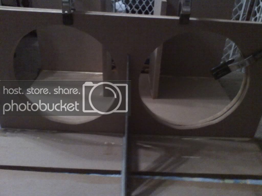

double baffled subs facing sealed chamber.
on to the pics.....

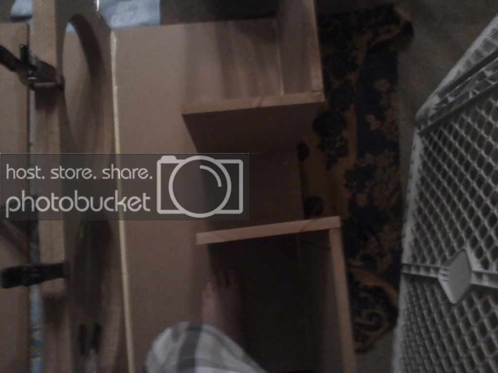

saw bit a piece of it off here //content.invisioncic.com/y282845/emoticons/crap.gif.7f4dd41e3e9b23fbd170a1ee6f65cecc.gif

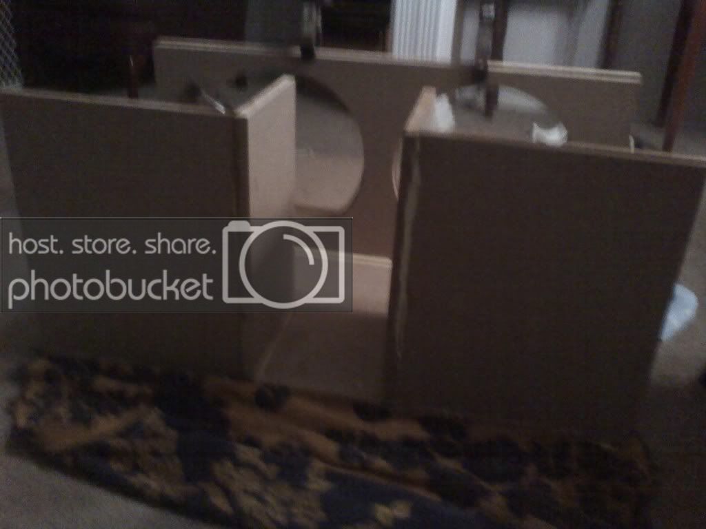

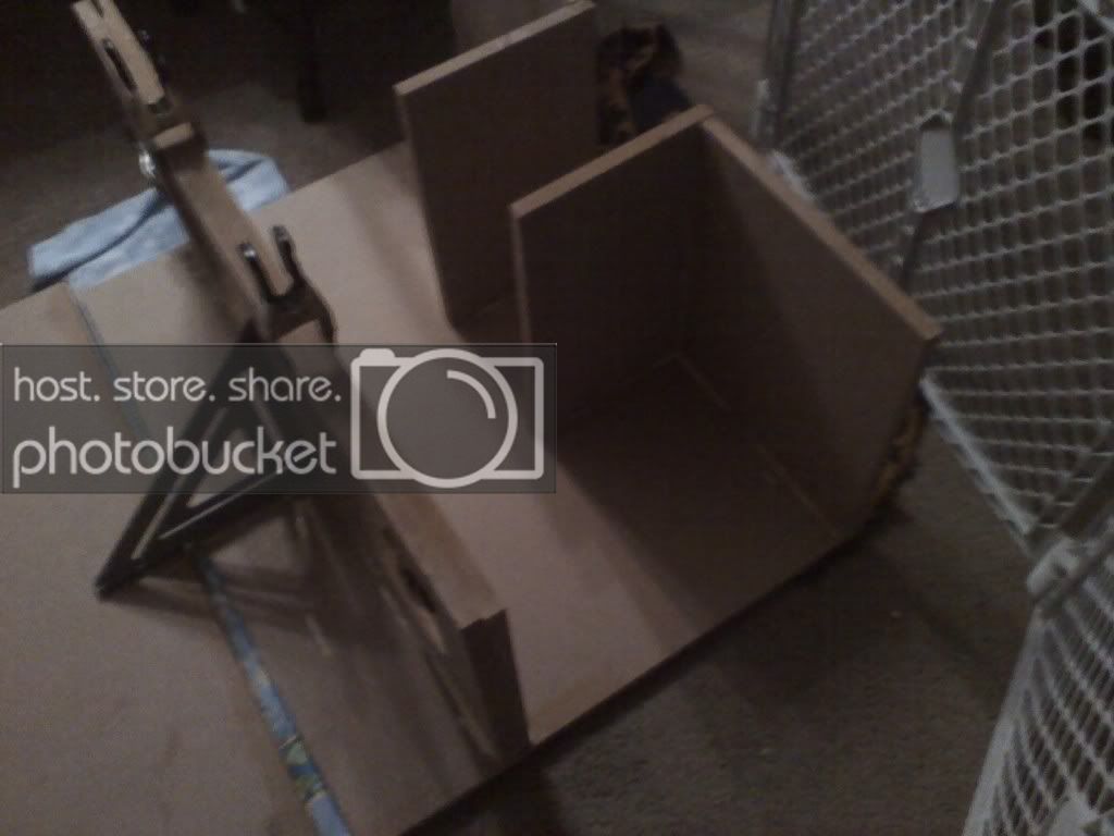

thats all i got done today ill be putting the sides and top on tommorrow.
was too dark to work outside so i had to gate it off from my little sister
looks to be coming along nicely
thanks after i finish my car build which i plan to start next week ill be investing on some better tools... all i got is those four clamps a skill saw and a router used a nail/string/pencil combo to get the circles cut haha
