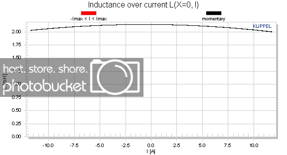

However, it does help greatly with Le(i) variation. First, let's look at the Le(i) data for a motor without copper in that rebate.
It is pretty obvious from that image that inductance is not constant with current (which is our goal). So how would we correct that? Well for starters, let's think about what the problem is: a variance with current. That means the problem occurs with current flowing through the coil. What region of the gap "sees" the coil the most? Easy answer: the center of the gap (since the coil rests there, all movement must start and return to this position at a rate equal to the frequency of the signal).

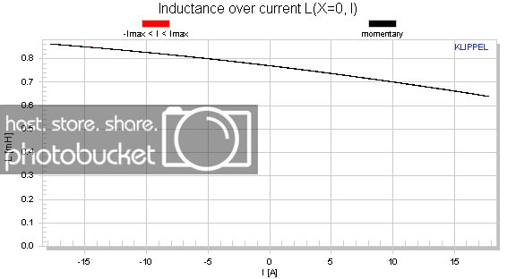

To wrap it up, here is an Le(i) plot for an XBL^2 driver with copper in the rebate:
Certainly a far cry from the old Mag. I have to wonder why it even retained the same name.
