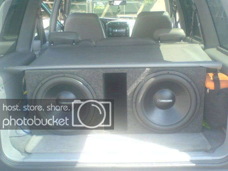

I used to have a sealed box around 5.2cf before displacement, was probably around 4.4cf after displacement and wanted to see how they would sound in a ported box, so i had one built and wanted to share a couple pics. The sq in this box is just as good as my sealed if not better only difference is the higher frequencies need to be eq'd in a bit. What a difference in spl, much louder while still sounding good. Box is 7cf tuned to 30hz. Sorry about the bad pics, using my phone and it sucks but i wanted to get some pics up anyways.

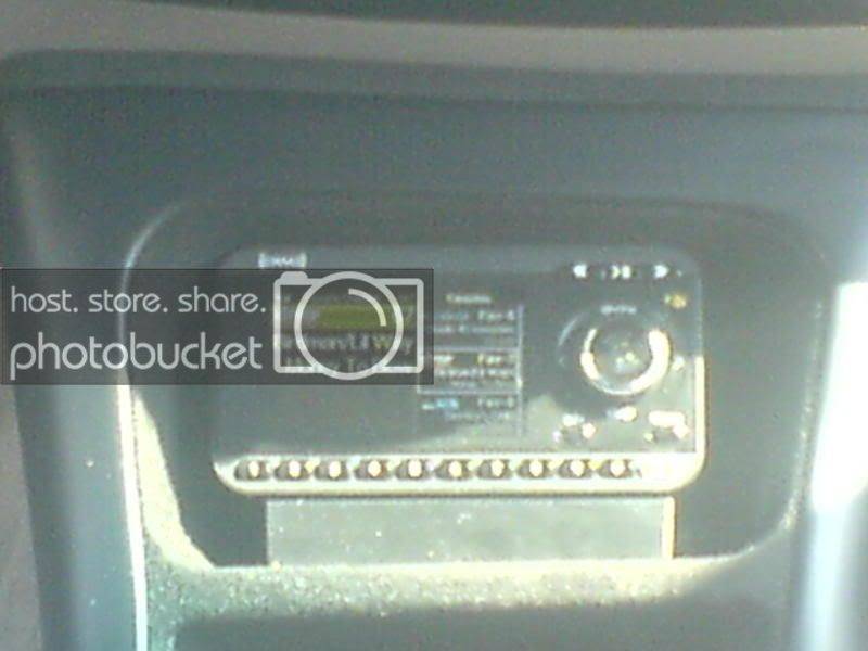

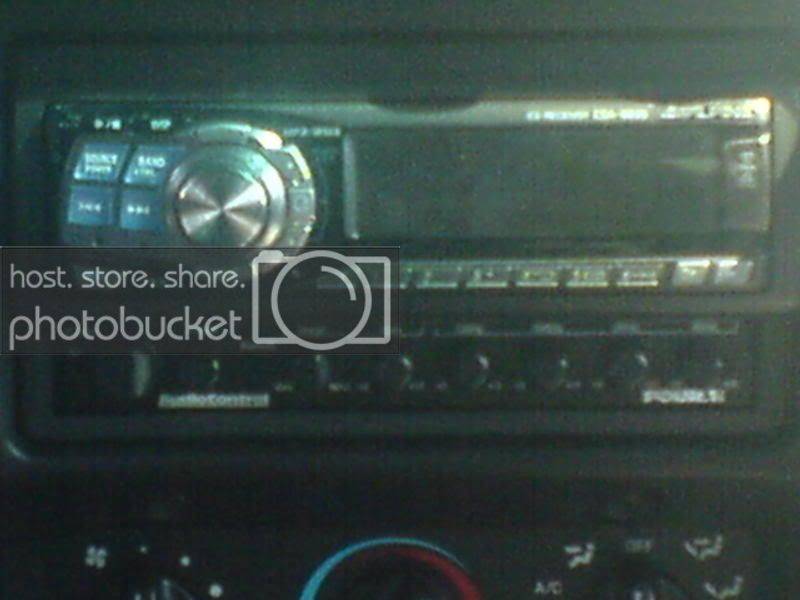

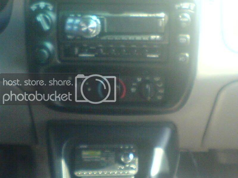

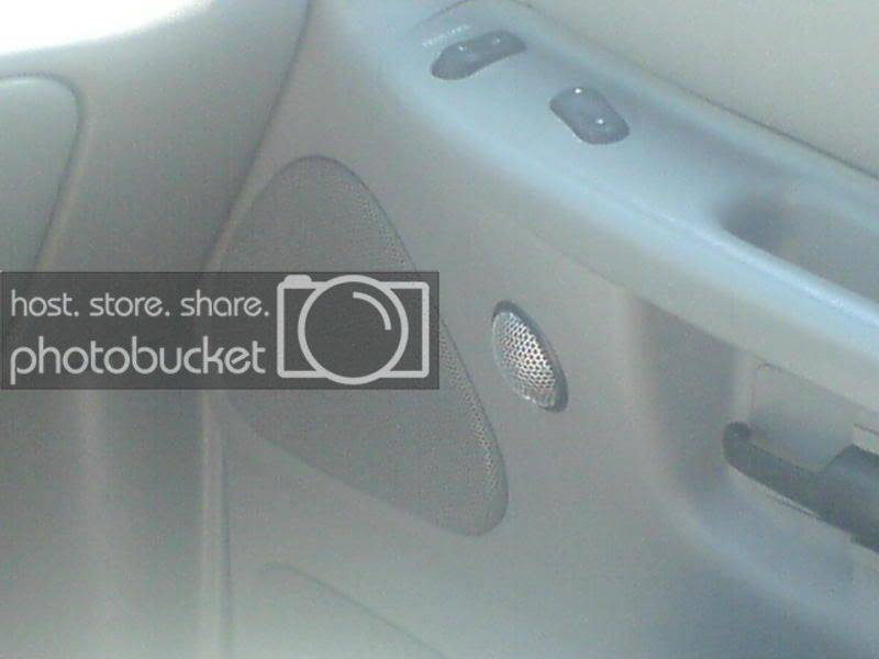

and a pic of my head unit, eq and xm radio and my hertz mlk 165's tweeters, mids are in the factory location behind the grill. head unit is the Alpine 9835 and eq is Audio control 4.1
