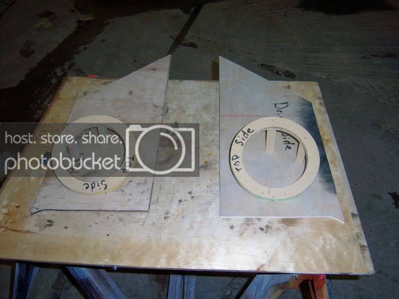

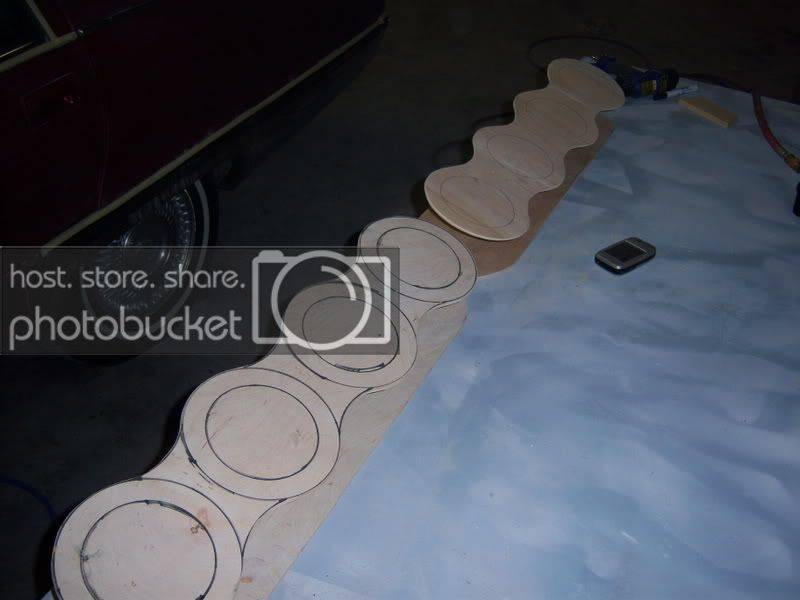

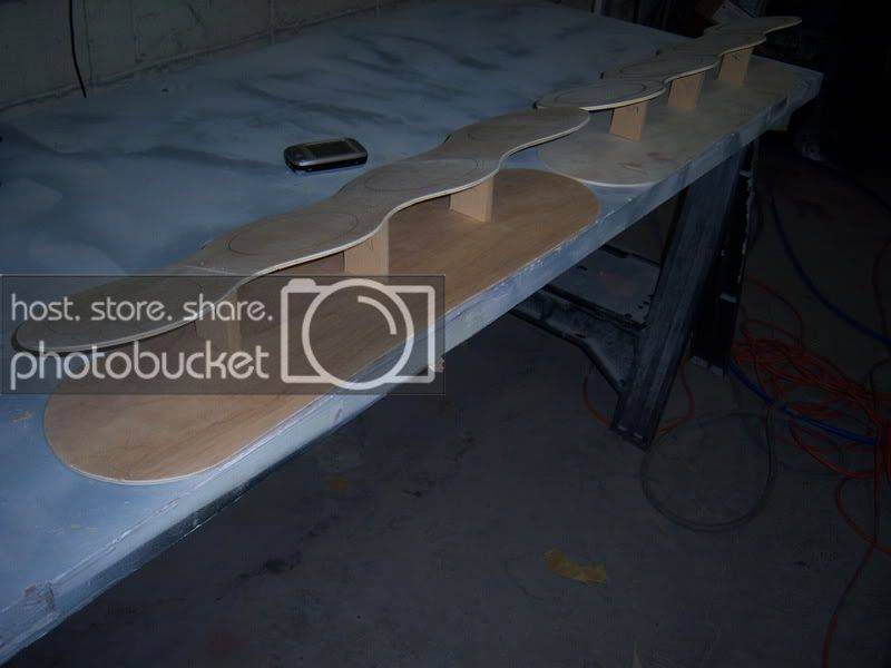

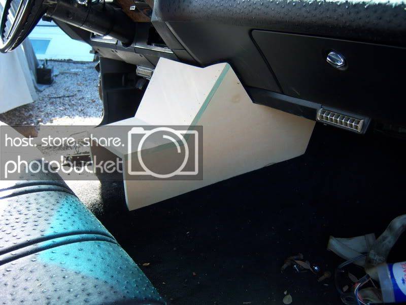

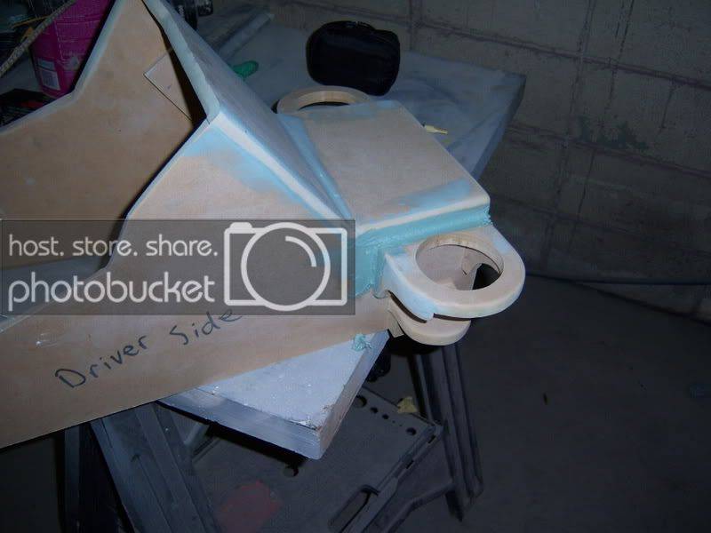

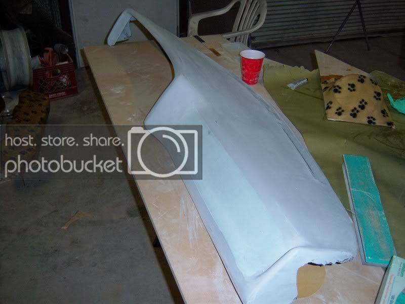

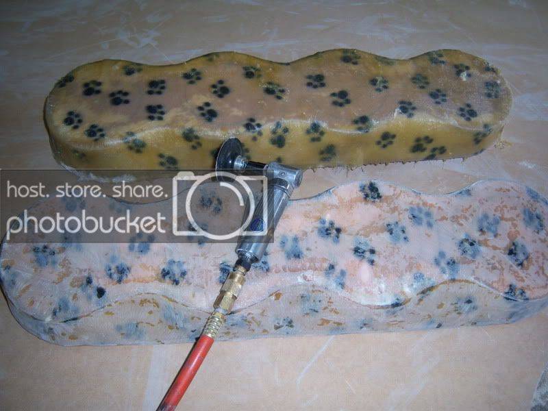

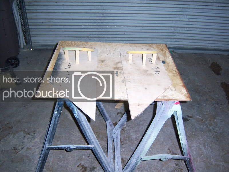

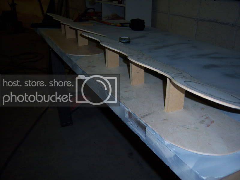

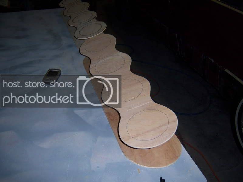

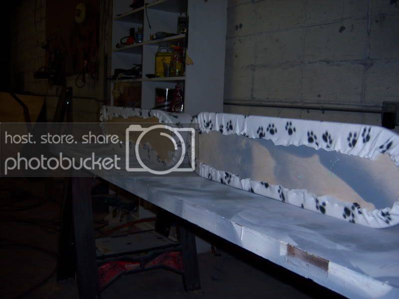

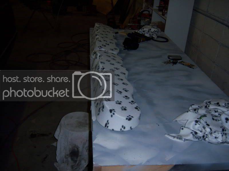

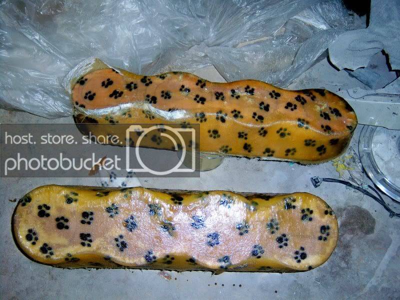

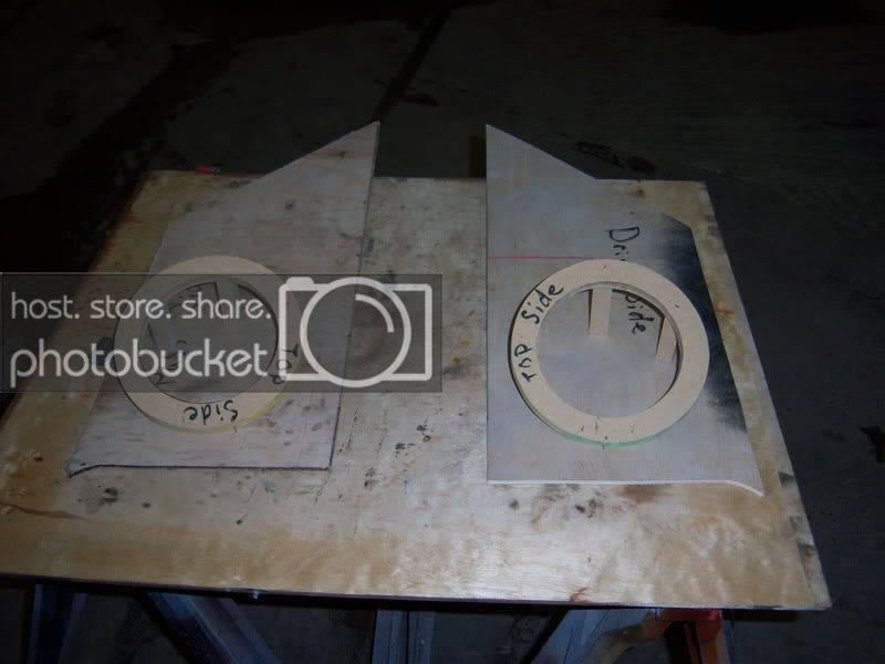

made some fiberglass door pods for my freind, pix
slapmaster

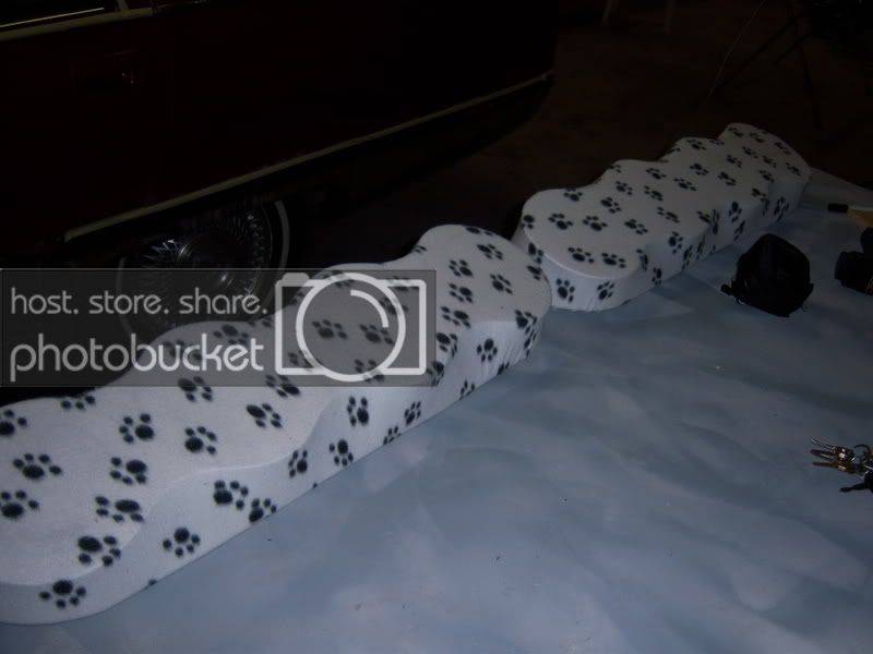

these will be going in an 72 caprice. still under contruction.
i think we going to paint them the same color the car will painted.
looks good so far but what size drivers are you putting in them? That appears to be .25" material for the baffle which seems very thin for that application.
6 1/2"s , once i glass them they will be ok to hold the speakers.

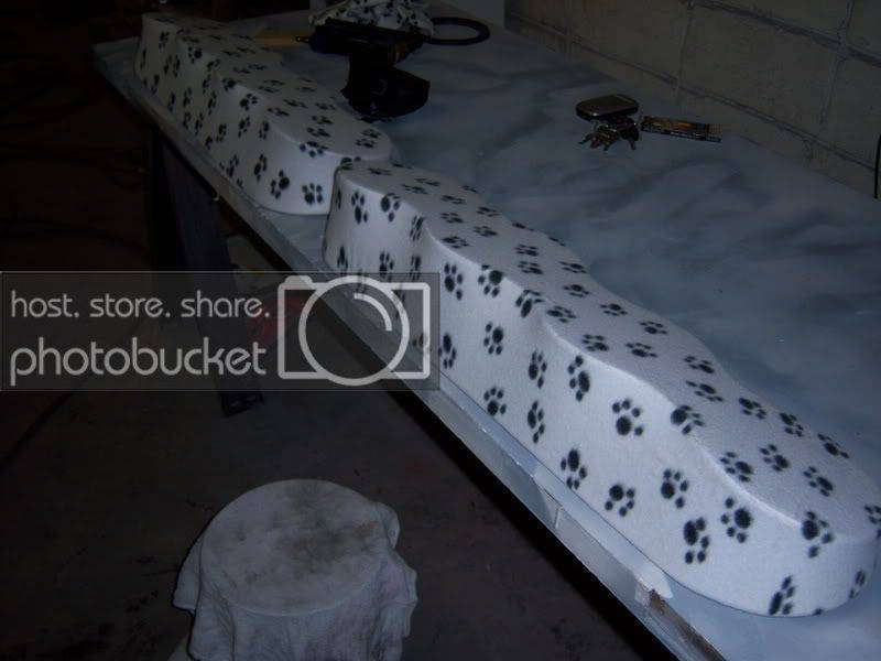

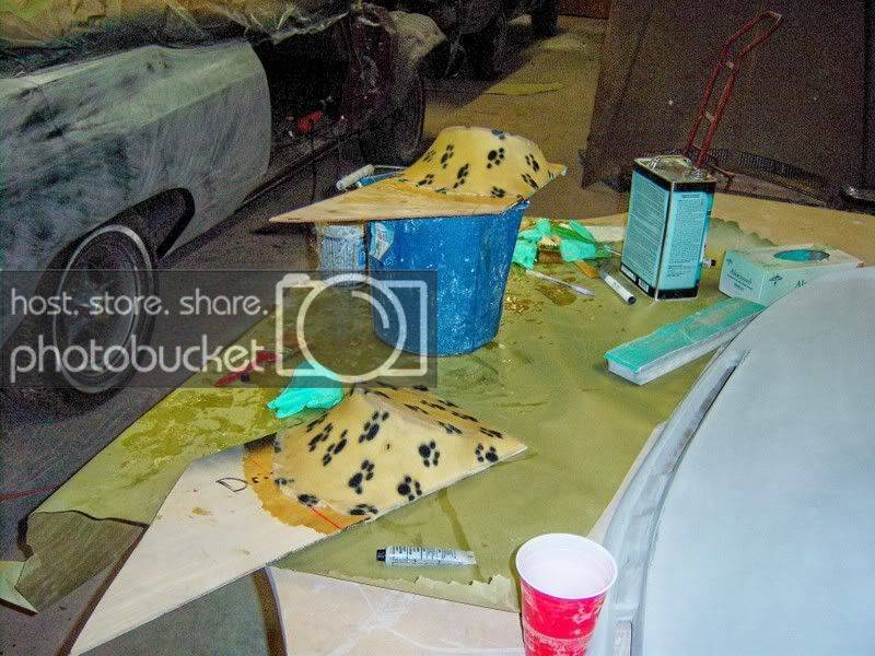

looks good but your in for a lot of sanding and priming son ummmmmm i love the smell of primer and resin in the afternoon
lol, yah i know. and it's gooding to need to be super slick, because we are going to paint them. thought i was the only one that likes the sweet smell of auto paint.//content.invisioncic.com/y282845/emoticons/crazy.gif.c13912c32de98515d3142759a824dae7.gif

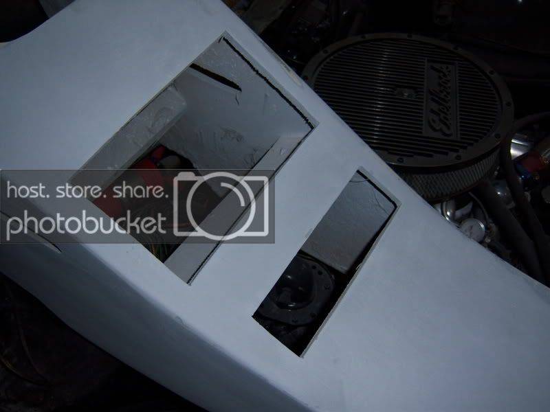

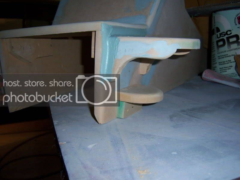

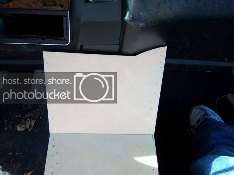

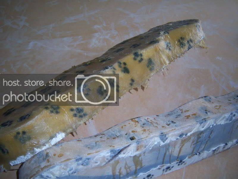

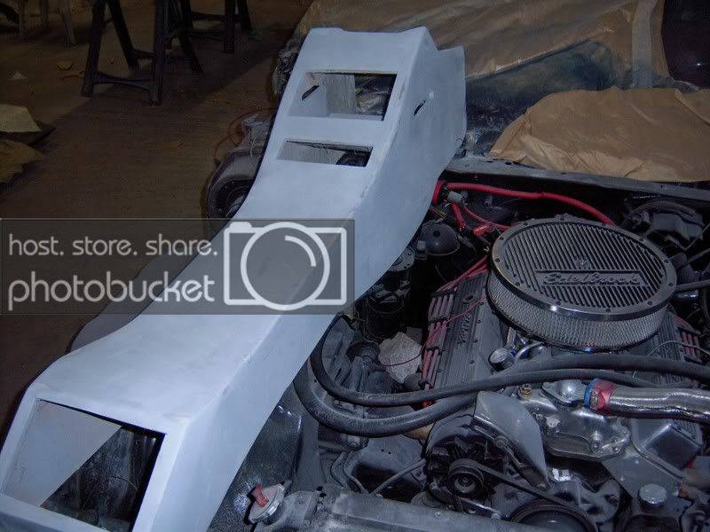

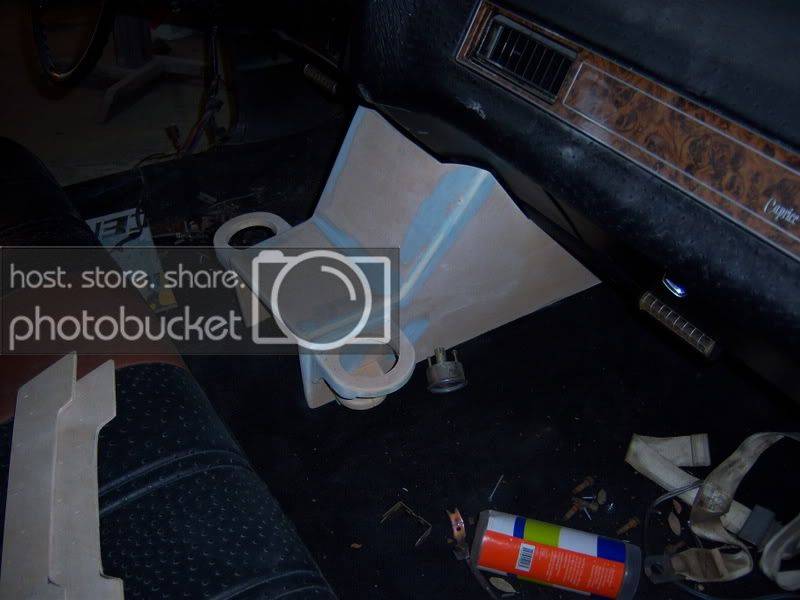

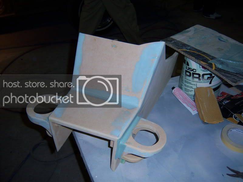

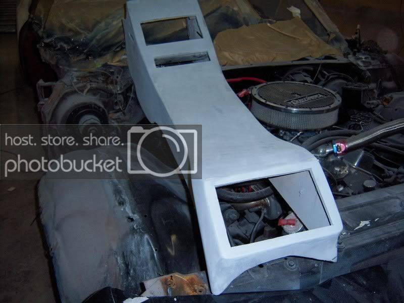

we desided to go a little ferther with the inside, so i made a center console today. got some more peaces i'm working on that i'll be posting pix of as i go.
in these pix the seat is unbolted and moved back. That is the only way we could moke-up the console. When installed the seat will be right up aganst the console. We are going to add billet pop out cut holders to the sides and glass the whole console so it will be slick. Don't know if we are going to put a doubble din in it or put gaiges in it.
don't you wish your girl was willing to get down and dirty with you.//content.invisioncic.com/y282845/emoticons/smile.gif.1ebc41e1811405b213edfc4622c41e27.gif
