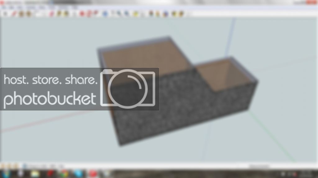

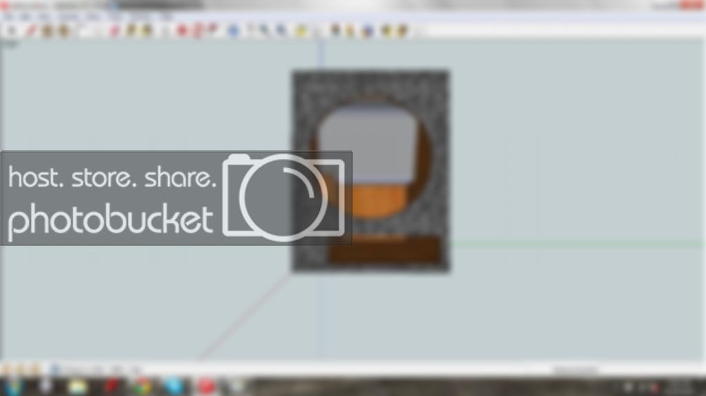

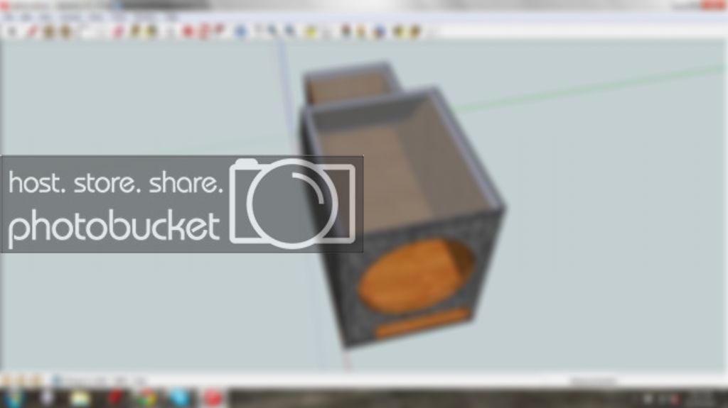

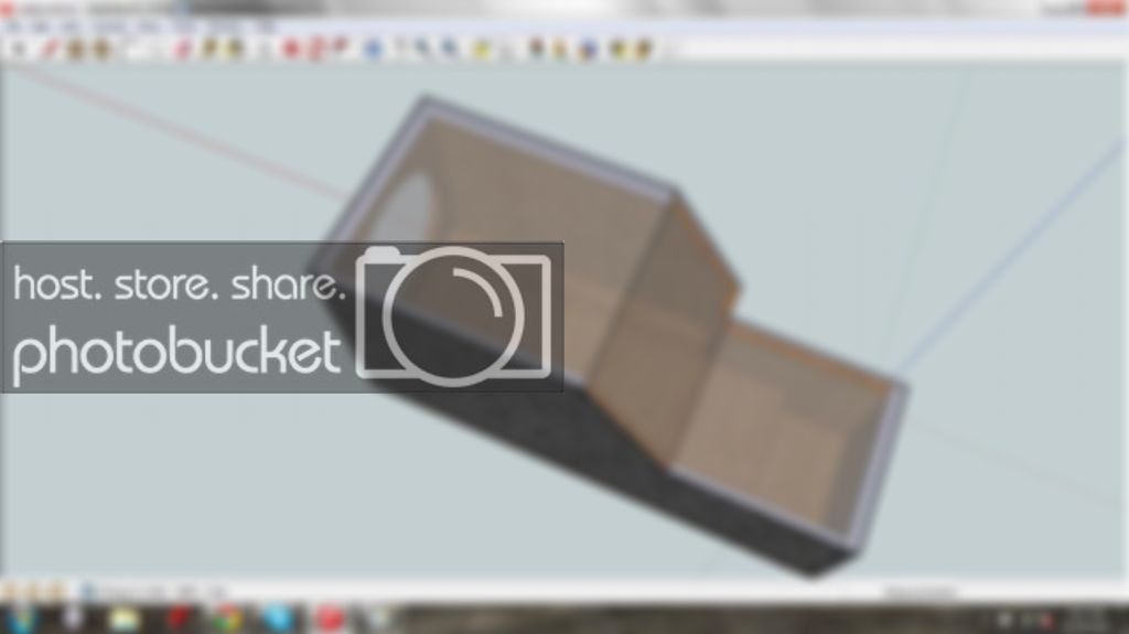

So I have been asking and asking about console boxes for my F250. I finally went in sketchup and this is what I came up with. I have 2 or 3 more designs but I think this one is the closest to what I want. It is still a little bit big for My Sundown Z v.2, but I am only running it on a sax1200d. Do yall think I should add some things to the inside to get volume down, just leave it as is, or do a whole other design?
I hand calculated the volume and got 2.38 ft^3 after sub displacement and port displacement.
The port is 10inches wide by 2.5inches tall by 28inches long which puts this tuned right at 30 hertz I think.
I don't mean just 45 those corners delete them all together you know what I mean. Think ramp the Wales leading to port need to be as smooth as possible no where for air to get trapped or slowed down.
like 45 then glass over?

What size sub?
12inch sundown z v.2 d2
