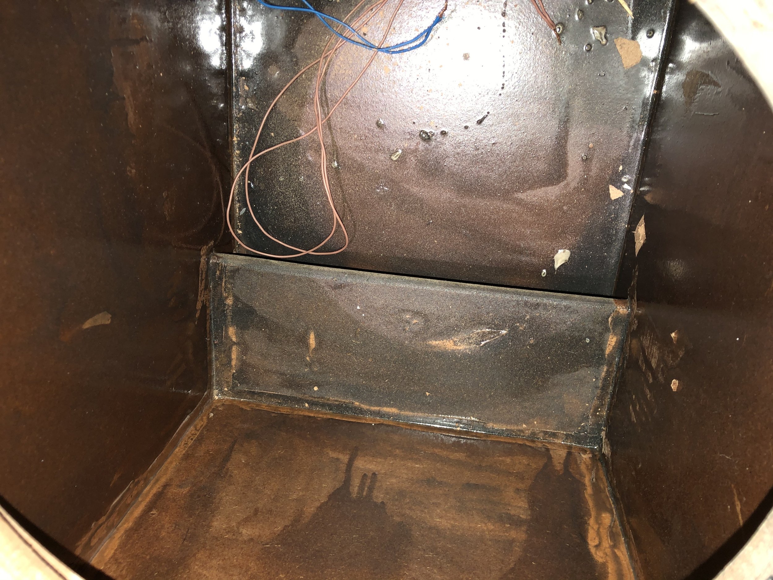

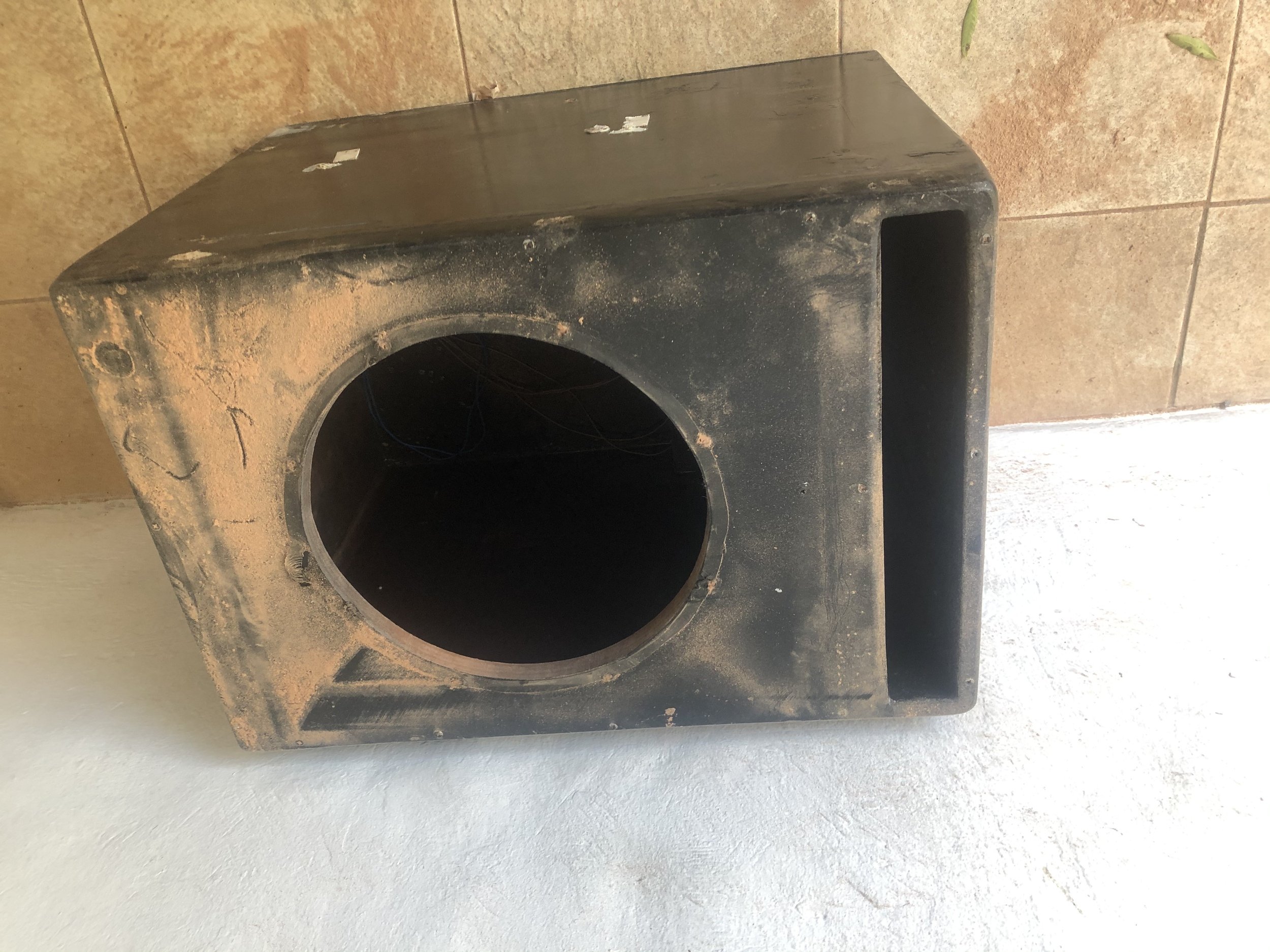

So I have a fully completed resined box that i would like to lengthen the port on it any tips to do so ??
Im looking at that and making my mind up that the best way to deal with that enclosure would be:
A- Seal up the existing port
B- Convert to an Aero-Ported enclosure
Thats just me..you can get it tuned the way that youd like by doing an Aero-Port.
Im sure others may have a different opinion.
i think you can possibly utilize the enclosure provided the sub fits and possibly tune yourself by doing an Aero=Port.
