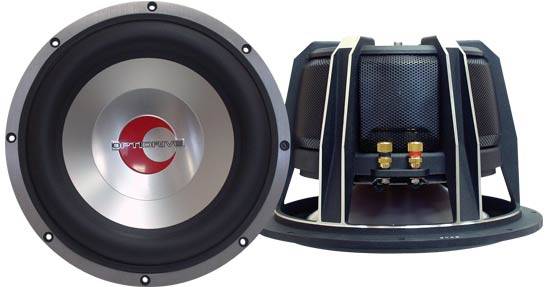

that sub says 2ohm dvc, each coil is 2ohm. your drawing is showing a 4ohm final load.
i have two of these subwoofers i am trying to run them at 2 ohms so how i do that when on the rockford fosagte website it looks like i am wireing them right
[/img]
[/img]
and can can i wire my 2 subs this way to my mono amp and will it still be at a 2 ohm load and my subs are in seperate single boxes
[/img]
Yes, that's fine. Your coils are in series making each sub 4 ohms. Subs are parallel at the amp making the final load 2 ohms.
