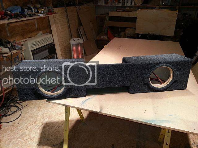

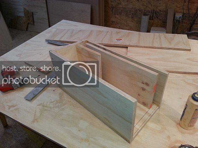

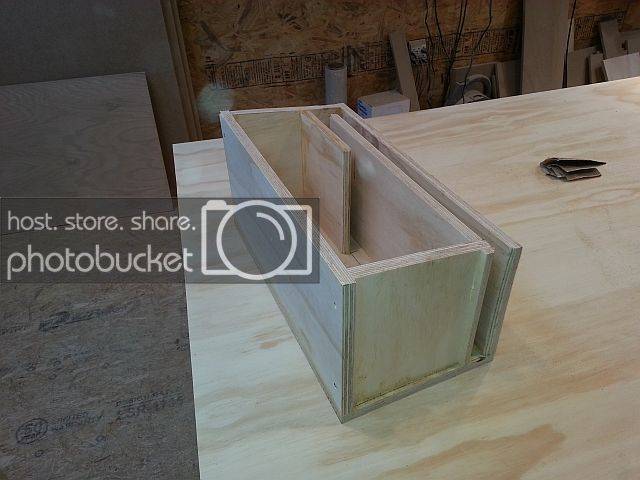

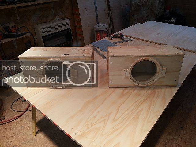

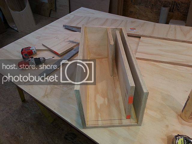

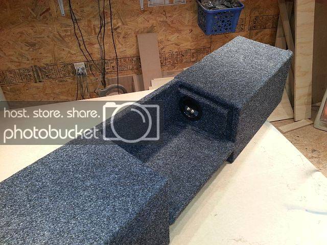

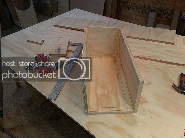

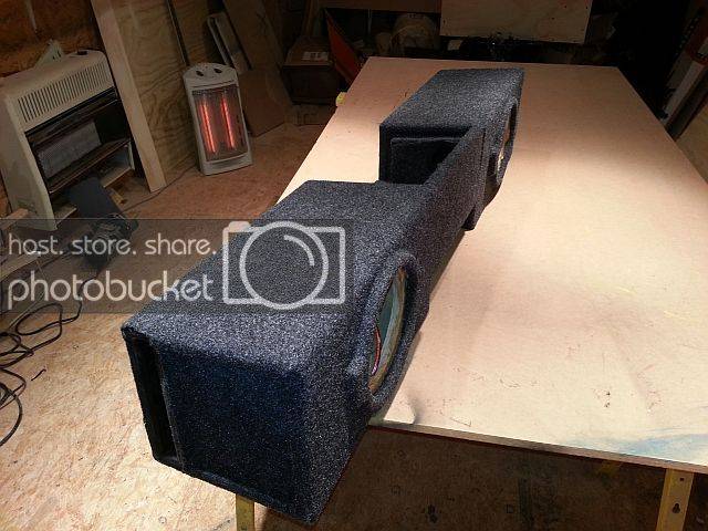

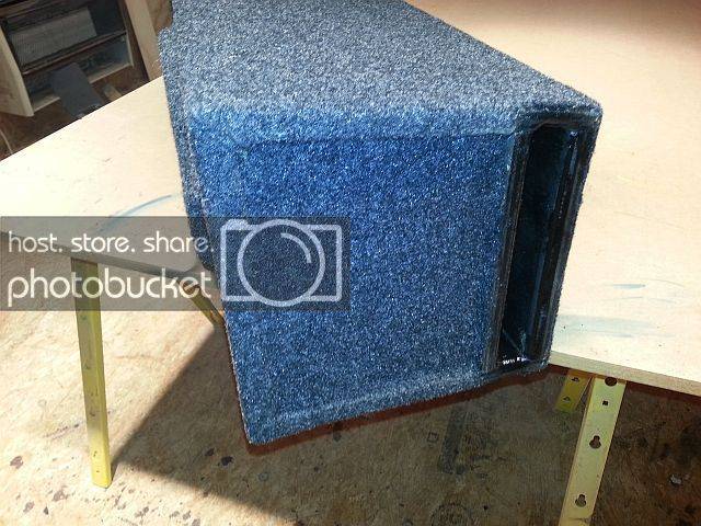

This is going under the seat of a Nissan Titan that has been raised...It will be two identical enclosures connected in the center with a riser amp rack board.....each box is .62cf net @ 33hz.....will be flush mounted with area carved out around subs for LED lighting...
