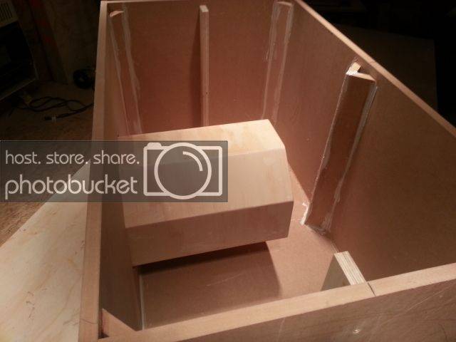

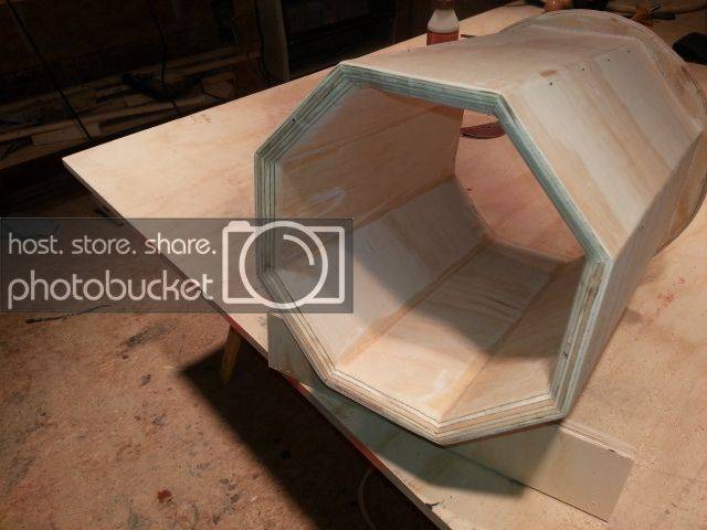

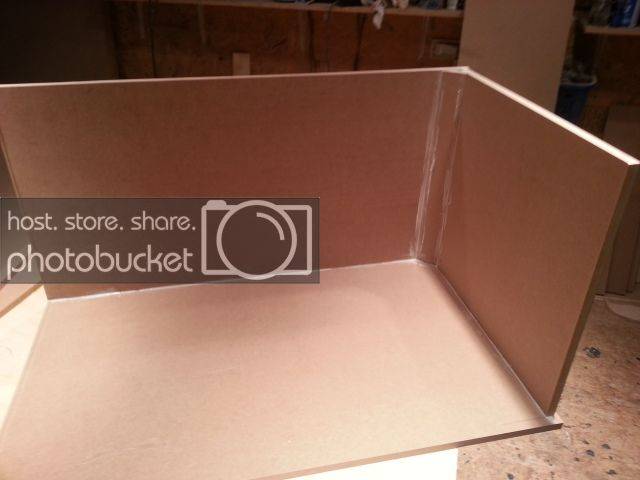

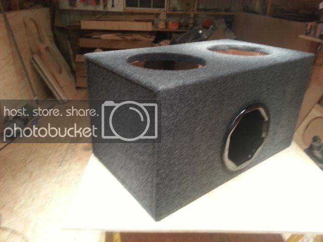

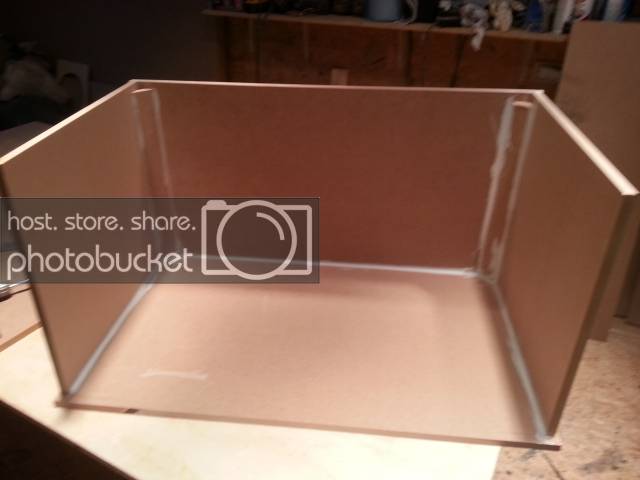

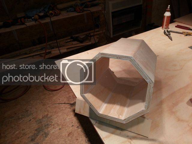

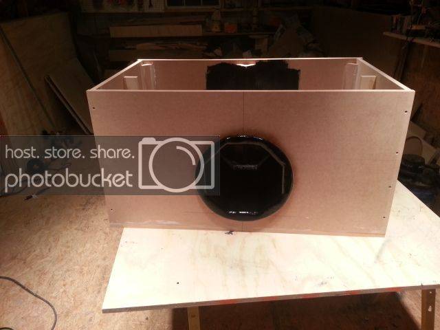

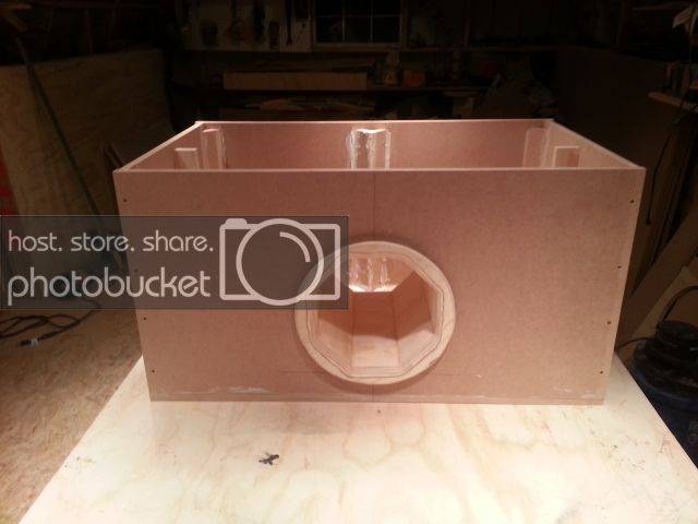

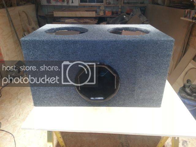

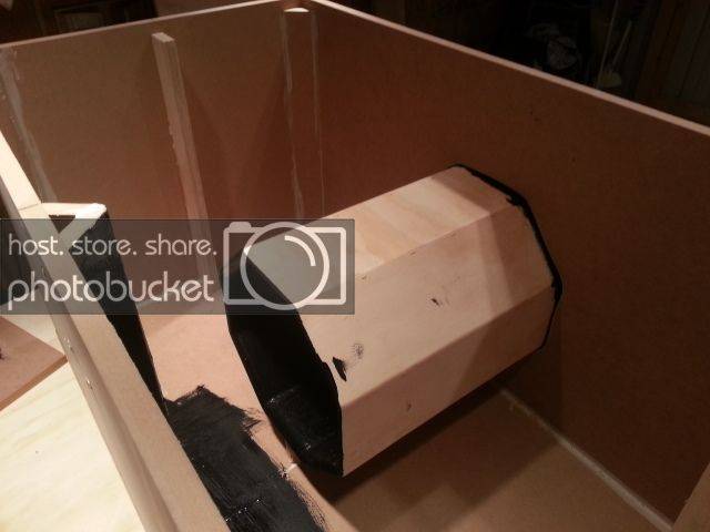

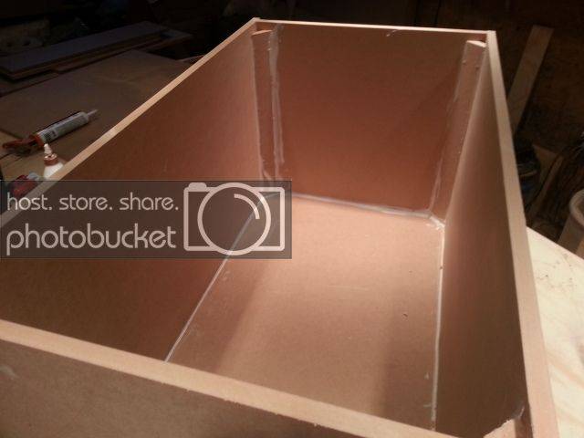

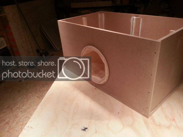

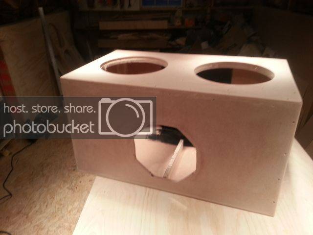

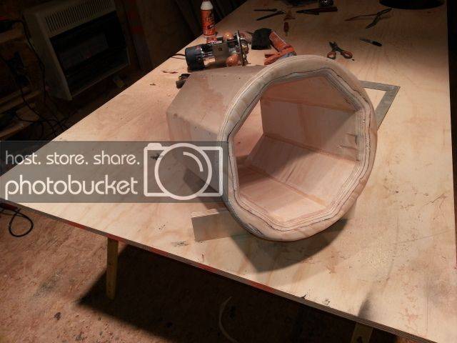

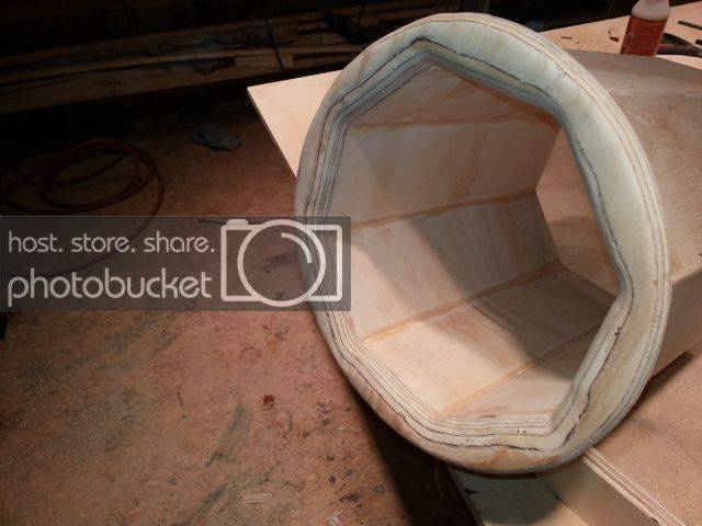

This is for a friend of Kramer's......two 15" FI BLs.......Subs up.....Custom Octo back.......Box will be constructed with MDF and Octo with Arauco......7.5cf net @ 33hz........Double top plate for strength....
So far I just have some octo work done.....
