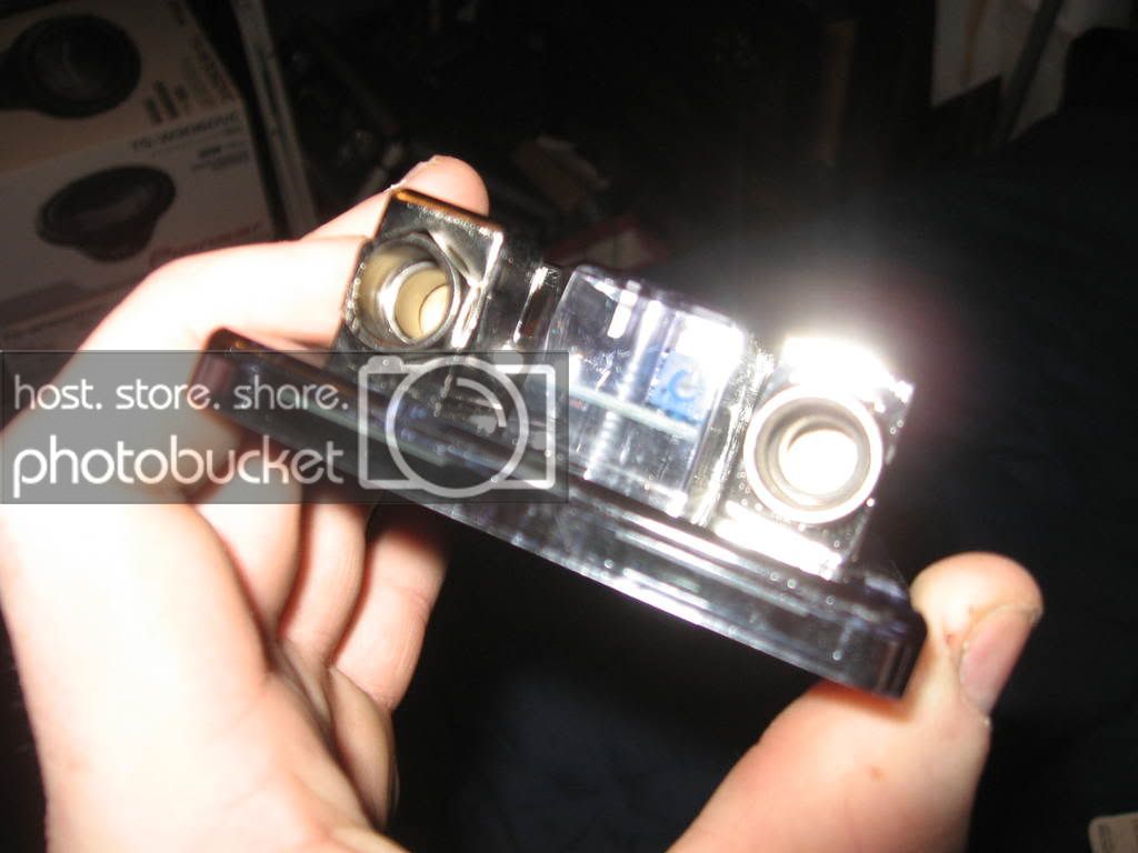

Alright guy's just opened my distro block from Knukonceptz. and im kind of confused how this would work even on the reciept it say's 1 1/0awg in and two runs out. Well i looked on each side and there is 2 holes is it because one if just for the 4awg and since im just using 1/0 awg for first run in just use that one? then just go to the two runs of 4awg like normal. sorry if this is a newbe question.
yeah DB drag SPL. Im just trying to figure why would there be 2 holes on each side . when on the reciept it even says One run of 1/0awg in and two runs of 4awg out.
Rich B please explain what do u mean?
If you need a bigger sized hole, try removing the set screw and see if theres a lining in the hole.
When I bought a Kicker 4ga dual amp wire set the dist block has a lining inside that fits 4ga, but it has a liner inside that can be removed for use with larger wire.
That kind of design saves the company money from making two seperate types of dist blocks.
Edit: Compression fittings also work the same way.
it has 2 inputs because they are the new style blocks which give you more options. the input side should have the solid block off the inputs as where the outputs are separated from each other on the other side.
Oh ok i get what your saying Rich B i will check right now then put up pics.
They might have sent you the wrong one since you said (and I missed:D) that you only needed one in and two out, but usually two in are tied together anyway, so just using one input shouldnt be a problem if your wire fits.

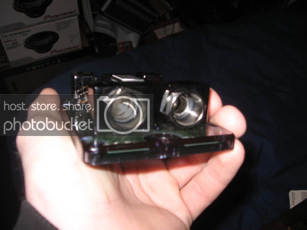

I think i got how it works now guy's kind of a diffrent setup. but here is how i think it works on one side there's the 1/0awg and 4awg fittings . This is on the same side so u put the 1/0awg in still on the same side of the block put in the 4awg . But still don't make sense cause that is only one 4awg run and not two? and also looks like the one side is just 8awg.
It just comes with the one in the distro block already. which is 1 1/0awg , 1 4awg and 2 8awg. but this i found on the website which i didn't know.
**The KND-23 is a “common” block, meaning it has no true in or out as there is no required direction of flow
