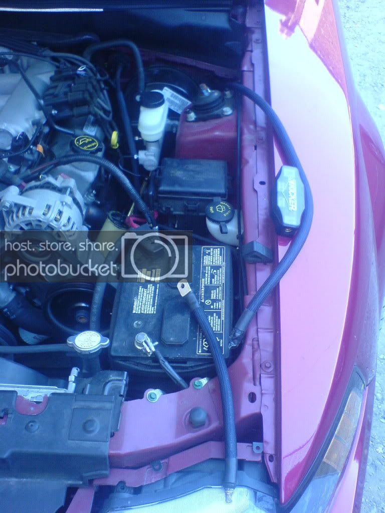

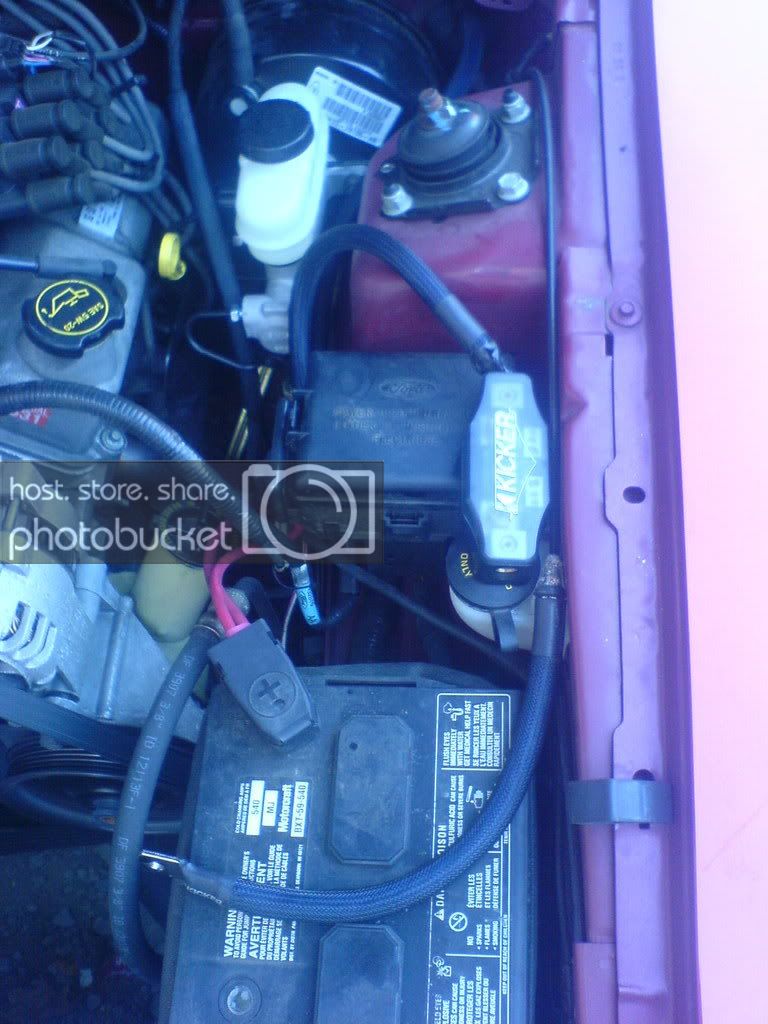

I finally got my car back. Here is the before the horrible incident pic:All i did last time was ziptie it down,...
This is the part that the loose pos wire came into contact with: Note this is the new replacement part;

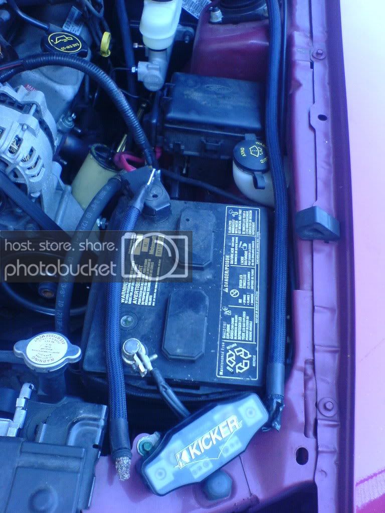

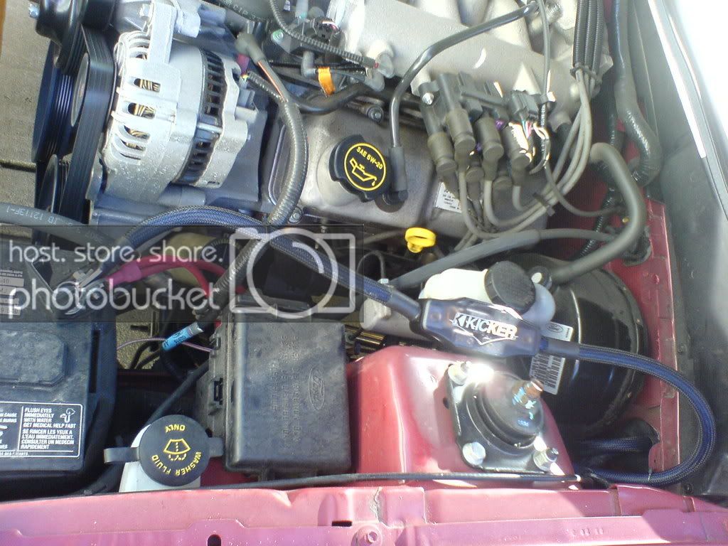

This is what I have to work with. Any ideas on where to mount? I had a tough time finding a place to bolt the fuse holder down with nut and bolt.

all you need to do, is trim back that wire so its not all shaped like a carrot on the end, you want the bare wire a uniform thickness into the holder. get the right sized allen wrench to tighten it down, and ziptie the wires to anything thats in the engine.
i would mount the fuse block to the fender wall right there in this picture;
http://i155.photobucket.com/albums/s295/drwang84/car%20audio/DSC00559.jpg
just turn it on its side, and get a pair of self tapping screws and just screw it to the sheetmetal. the wires can go down the side just like they do, and then plug into the terminal on the block. ziptie or whatever your wires down as they go.
