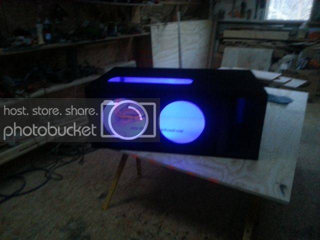

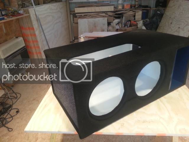

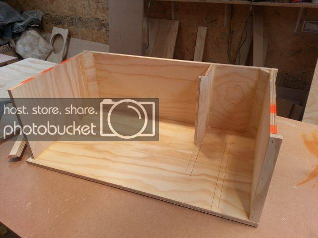

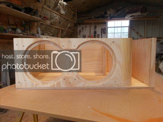

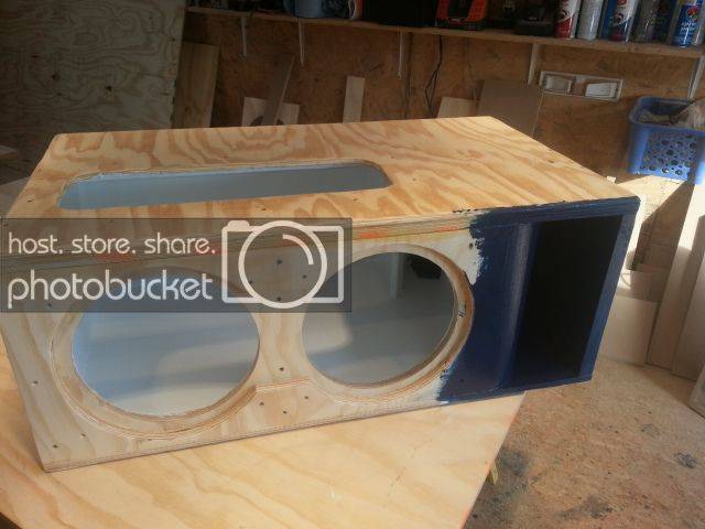

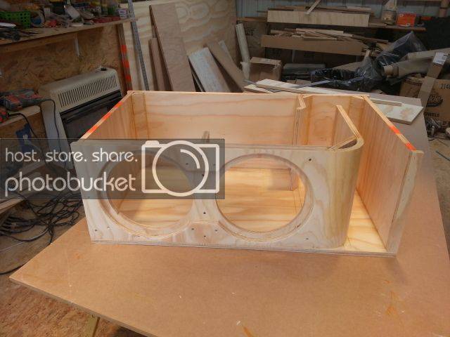

Pair of IA DR 12s.....4.2cf net @ 33hz......Arauco....custom blue kerf port...white interior with blue LEDs.....double baffle with flush mount....plexi window on top......
