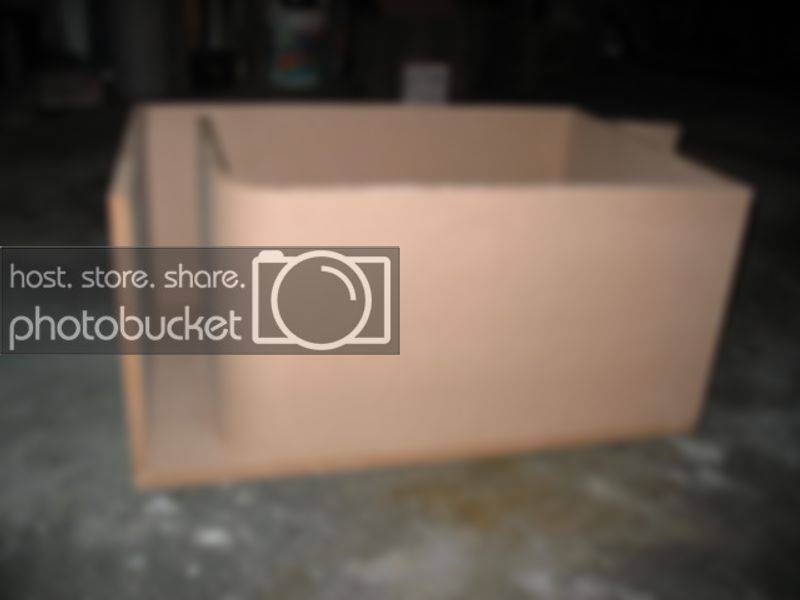

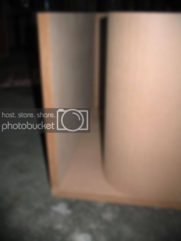

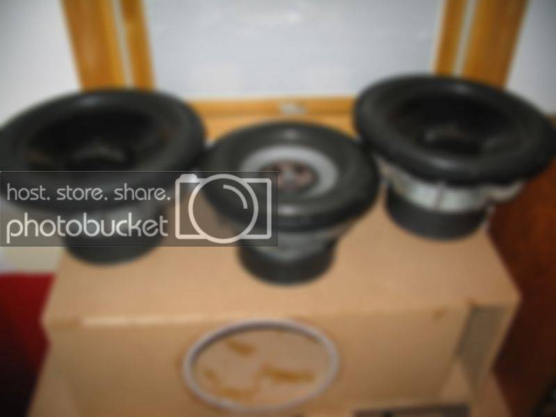

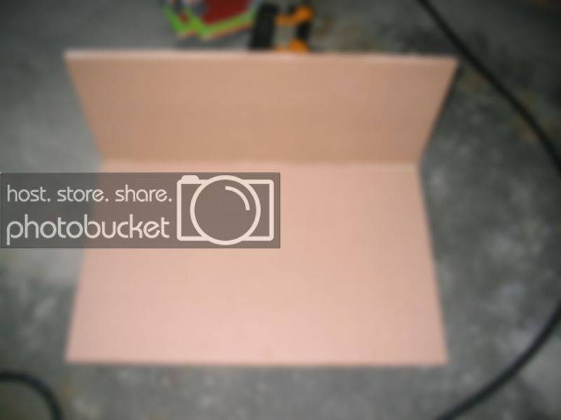

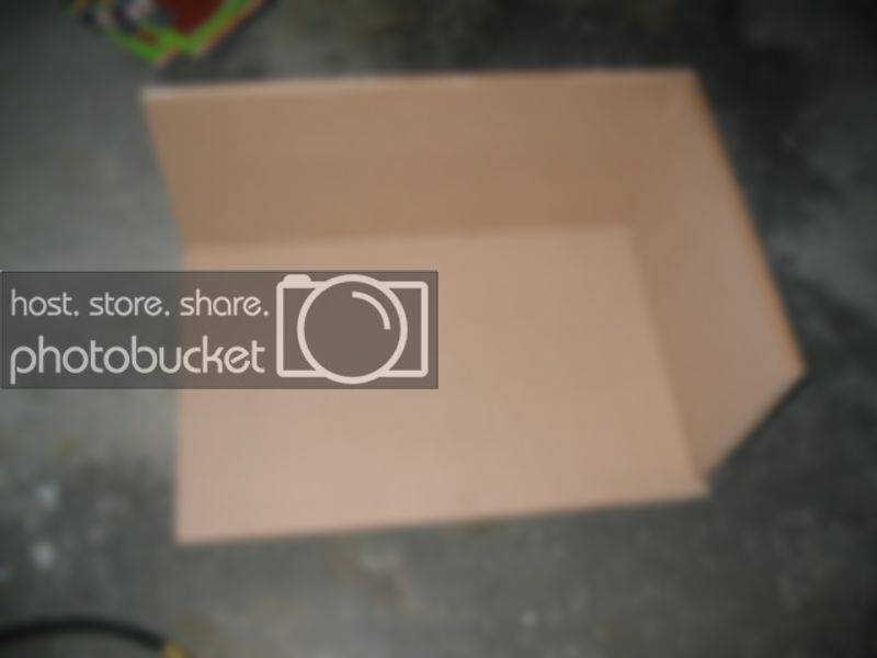

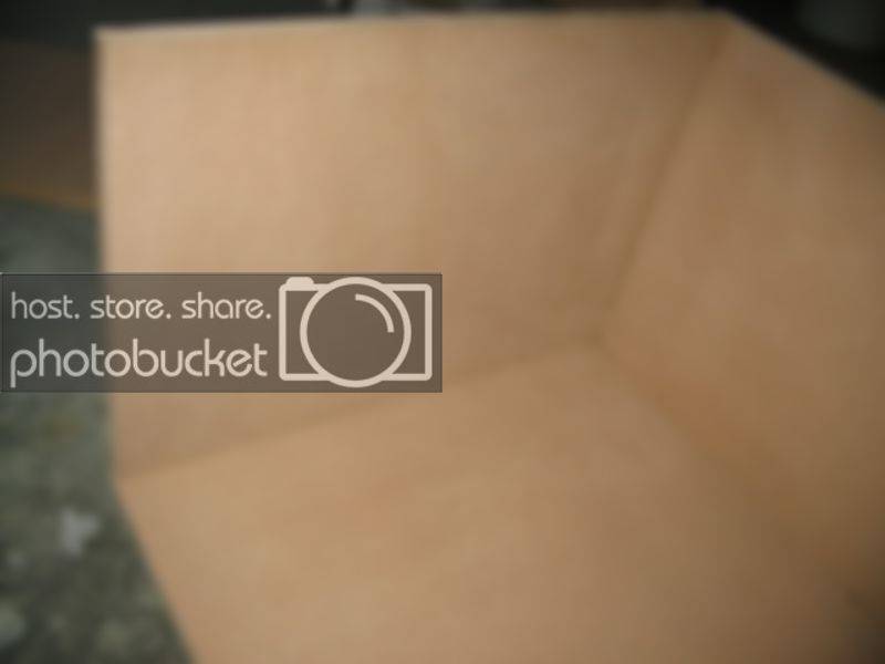

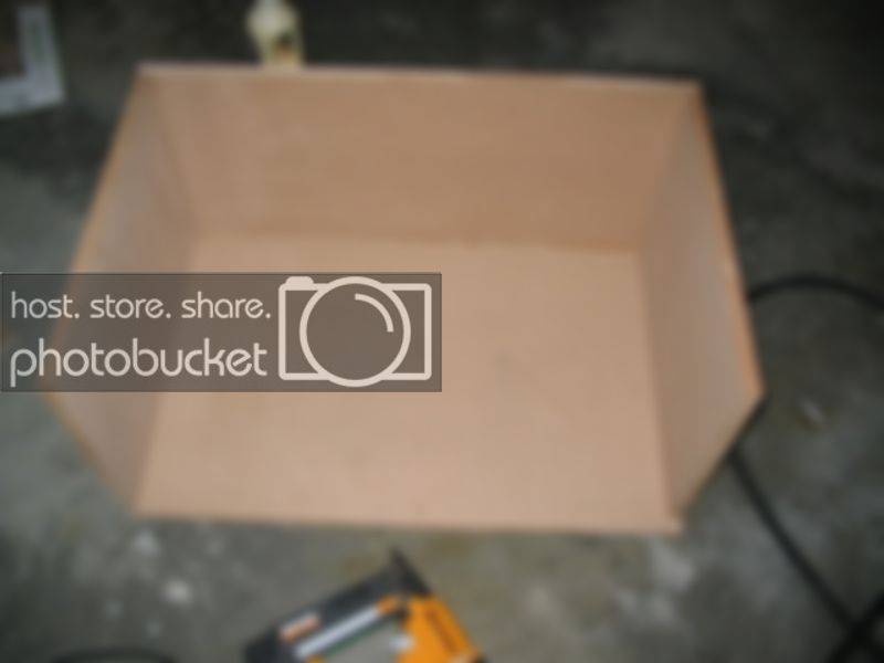

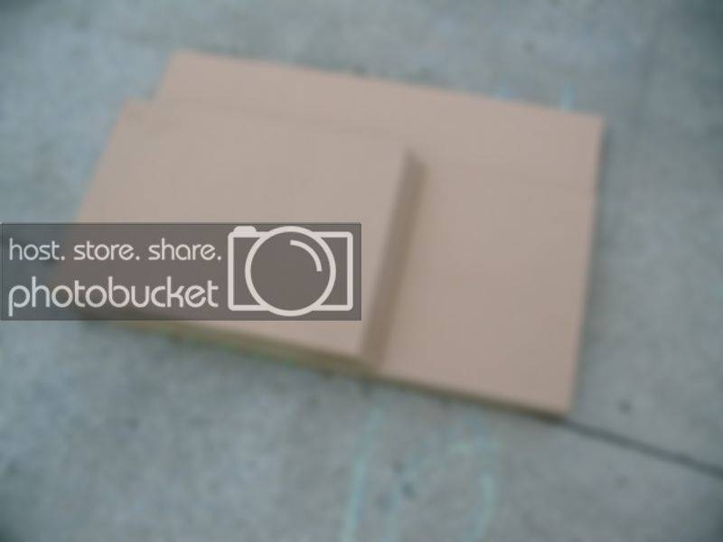

ok this enclosure is for my room sub. its a mint lightning audio x1 12. this was made back in the day when lightning audio was actually a respectable brand lol. it even uses a tc 3hp variant. the enclosure comes to 2.5 cubic feet tuned to 32hz. its gonna be painted gloss black and i hope to get a real nice finish on it. anyways, here are the pics so far...
will have more as it happens.

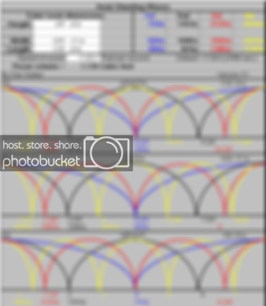

Calculator is only for rectangle rooms so I'm going to take an average of those back walls. 13 ft should be good.
Uploading a pretty little graph for you now //content.invisioncic.com/y282845/emoticons/smile.gif.1ebc41e1811405b213edfc4622c41e27.gif
Don't worry about the second, third, and forth axial standing waves. Basically, the first one is like a 1/4 wave and so on and so forth. Obviously since half, 3/4, and full length waves are crazy long, the boost is moved up in the octave scale. You obviously don't need to worry about those as your low pass filter will be set around 60-80Hz anyways.
As a side note... you can see the lowest frequency that you will see gain on will be 43Hz and you'll get a few peaks in the upper end too. I would suggest stuffing with poly-fil and have the port it's own width away from a solid wall to give it a nice loading effect and add some "theoretical" inches to your port line.
