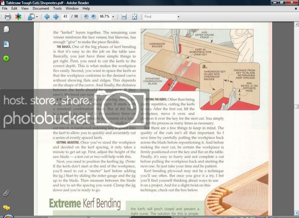

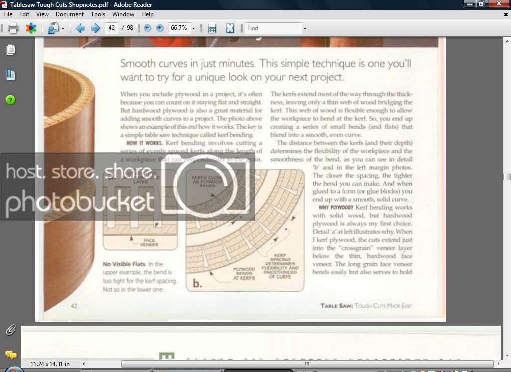

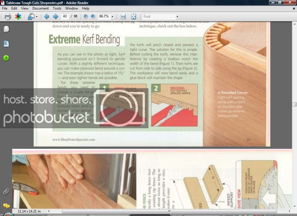

I've used this method before a good while back, it's really easy and gets the job done. //content.invisioncic.com/y282845/emoticons/smile.gif.1ebc41e1811405b213edfc4622c41e27.gif Looks nice too.
I've seen it done on a radial arm saw but I don't have 1 //content.invisioncic.com/y282845/emoticons/frown.gif.a3531fa0534503350665a1e957861287.gif but I do have a massive 12 inch commercial table saw so this will work awesome, thanks for the info man.
