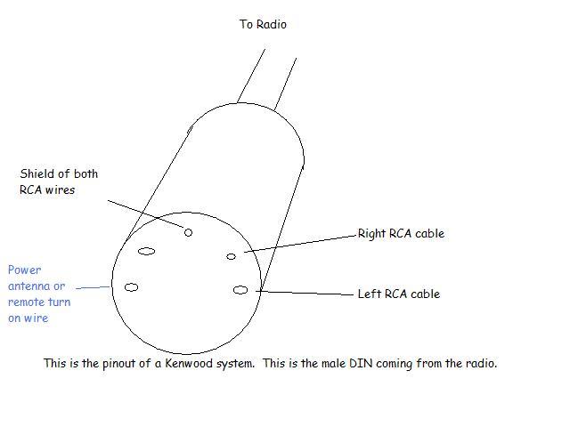

This is exactly what I've been looking for I have no idea how old this post is but I'm trying to find the eight din pin cables to RCA so I can set up a vintage Kenwood equalizer with some vintage Nakamichi car audio if you can help add me forever in your debt
Pretty sure it's super easy to make. Just buy a din male connector on ebay and a basic rca cable.
