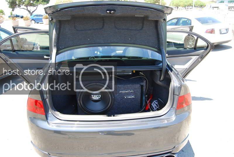

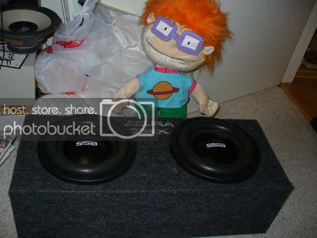

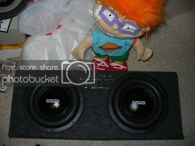

My 2nd box build. This time it's sealed, came out fantastic imo! Slowly mastering the carpeting

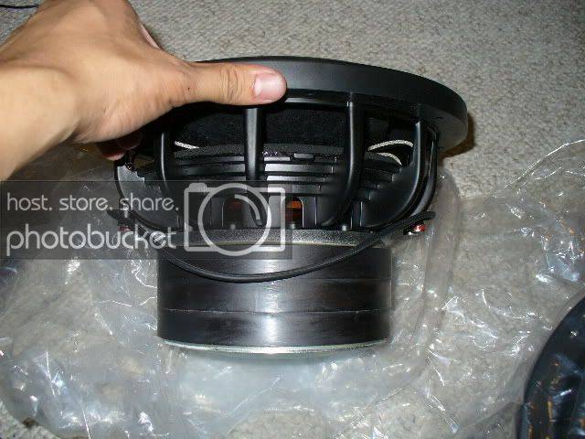

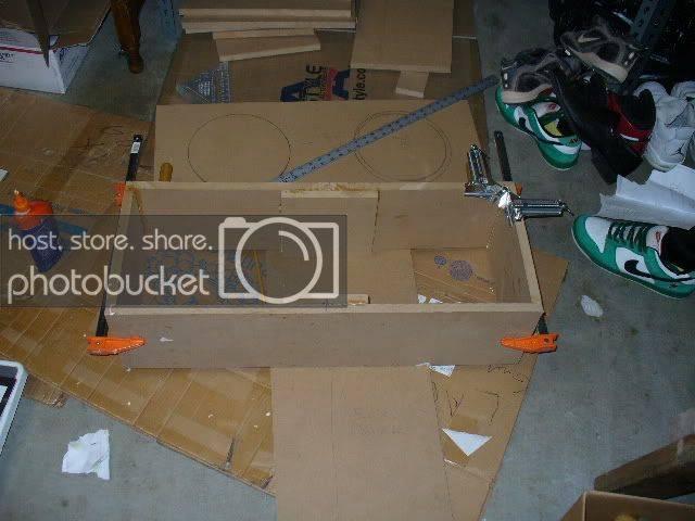

The middle two pieces was for extra bracing since these 10's are heavy as shit. I did take the space taken by those to account.
SSA reccomends .85cu ft per 10.
Box is 1.8 cu ft after sub displacement, with 1.25lb of polyfill (may take out, just gonna test it first, read that it should go lower)
Just gotta finish my amp rack now!
Here's the first box I made. Not bad, but I'm looking to actually have a trunk this time around so I went with sealed. I'll actually have all the wires hidden (hopefully) this install, sinec it's summer!

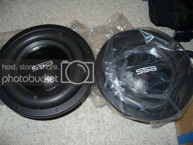

10" Dual 1's!
can't wait to get these bad boys in!
The box actually is to optimal spec. I just threw a bit of polyfill in there to try it out //content.invisioncic.com/y282845/emoticons/thumbsup.gif.3287b36ca96645a13a43aff531f37f02.gif

If you already have it to spec, then there's no reason for the polyfill. But to each their own //content.invisioncic.com/y282845/emoticons/smile.gif.1ebc41e1811405b213edfc4622c41e27.gif
