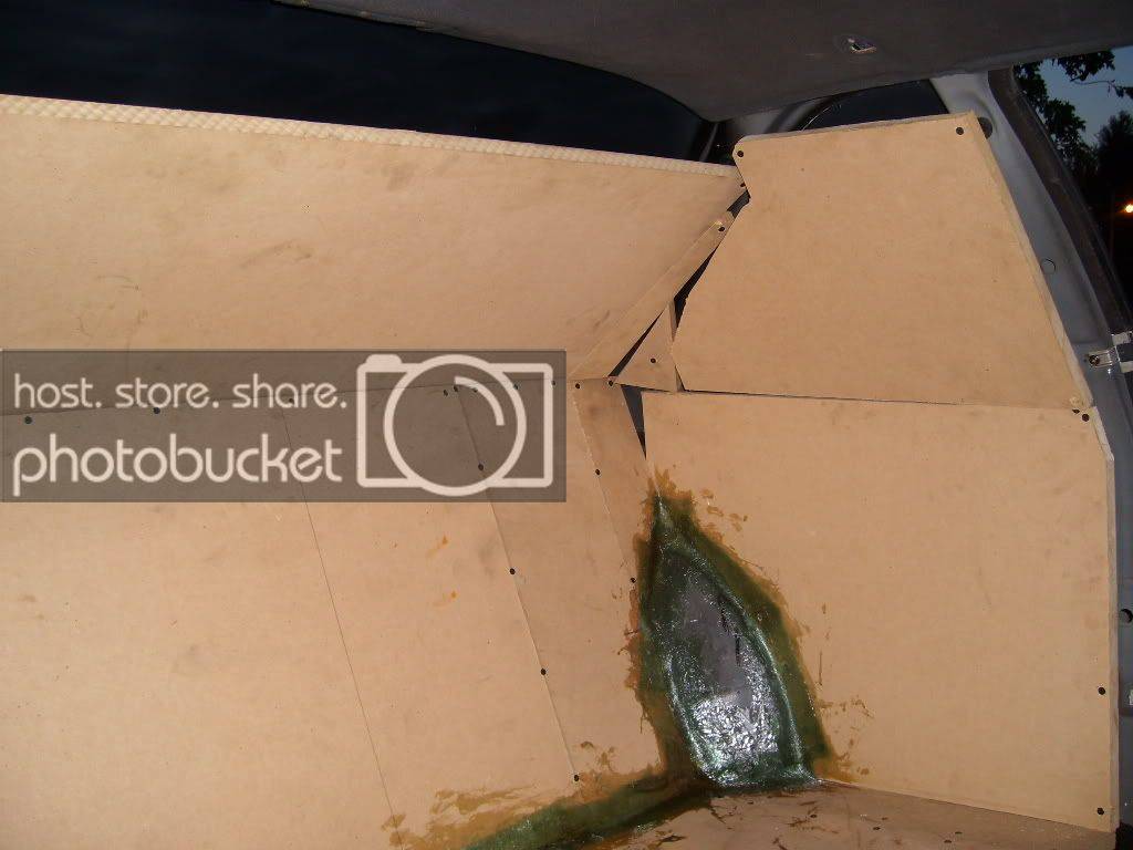

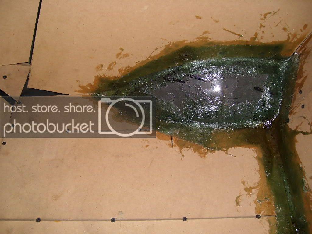

ok, so i started my wall build today, the back wall, and floor are braced with 4 2x4's glued & screwed, its going to have a double baffle, and tuned to approx 38hz
the entire inside will be fiberglassed for extra strength, along with internal bracing, every panel with open space behind, below or above it will be filled with expanding foam, i dont think this box is going to budge much....hopefuly...this is my first attempt at a wall, any constructive critisism is VERY welcome, if your just going to be negitive.....get the **** out of my thread....
