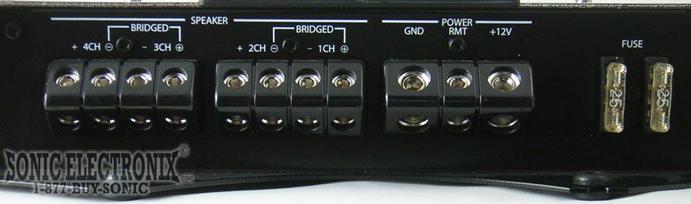

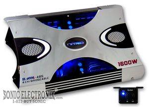

If this is your amp
it should look like this on the side?
is there a wire coming from the RMT on the right?
