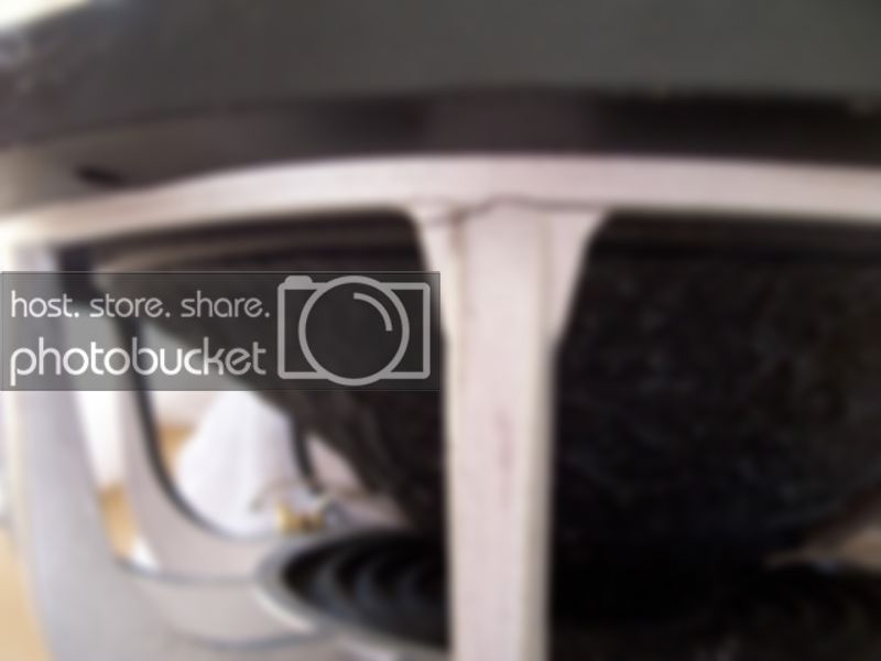

hello everyone. i just received a used AA Atlas in the mail and well i found it has a crack through 1 of the spokes of the basket. i began playing around with the sub and am contemplating about applying 2 part high strength epoxy to the crack then use a clamp to fix the spoke into position. would that would fine?

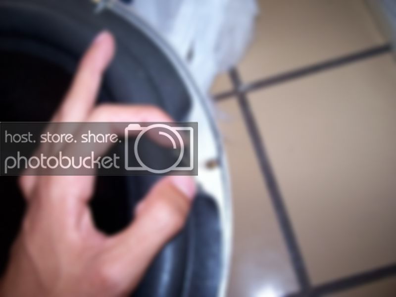

it is the only crack on the basket and nothing else is wrong with the sub other than an area near one of the mounting screws where the surround is coming un-glued. which is an easy fix.
so do you guys think it would be fine to just glue the crack solid?

Id be very concerned that a JB Weld type of fix would not hold. That frame will experience alot of stress and vibration. It might work, just dont mount it on the side where frame stress would be at its greatest.
did you buy the sub damaged like that? if not id be pissed and would ask for 150 bucks for a recone //content.invisioncic.com/y282845/emoticons/smile.gif.1ebc41e1811405b213edfc4622c41e27.gif
Epoxy would bond the two pieces together, but it really should be welded. Epoxy isn't going to be as strong as a weld and it isn't going to last a long either.
the sub was not cracked. it got cracked as the sub shifted in the box it was sent in. as for positioning the sub when mounted of course i would set up so that 1 spoke is south/downwards so there won't be any stress pull on it.

oh and the surround coming un glued was no from the shipping and isn't even on the side of the crack. it seems that the screws used had twisted/pulled the surround off.
If it's cast metal you'd need to have it brazed, but would risk messing up the sub with the heat involved.
I'd think JBweld to hold the joint together then more applied around the cracked area. Build up a nice thick layer. I've drilled/tapped the stuff before, so it's pretty much like steel when cured. As mentioned just make sure the basket is CLEAN before you apply it...
i wouldnt use jb weld or epoxy. find someone in your area that knows how to silver solder and do it that way. but you have to be very careful not to burn the speaker up.
