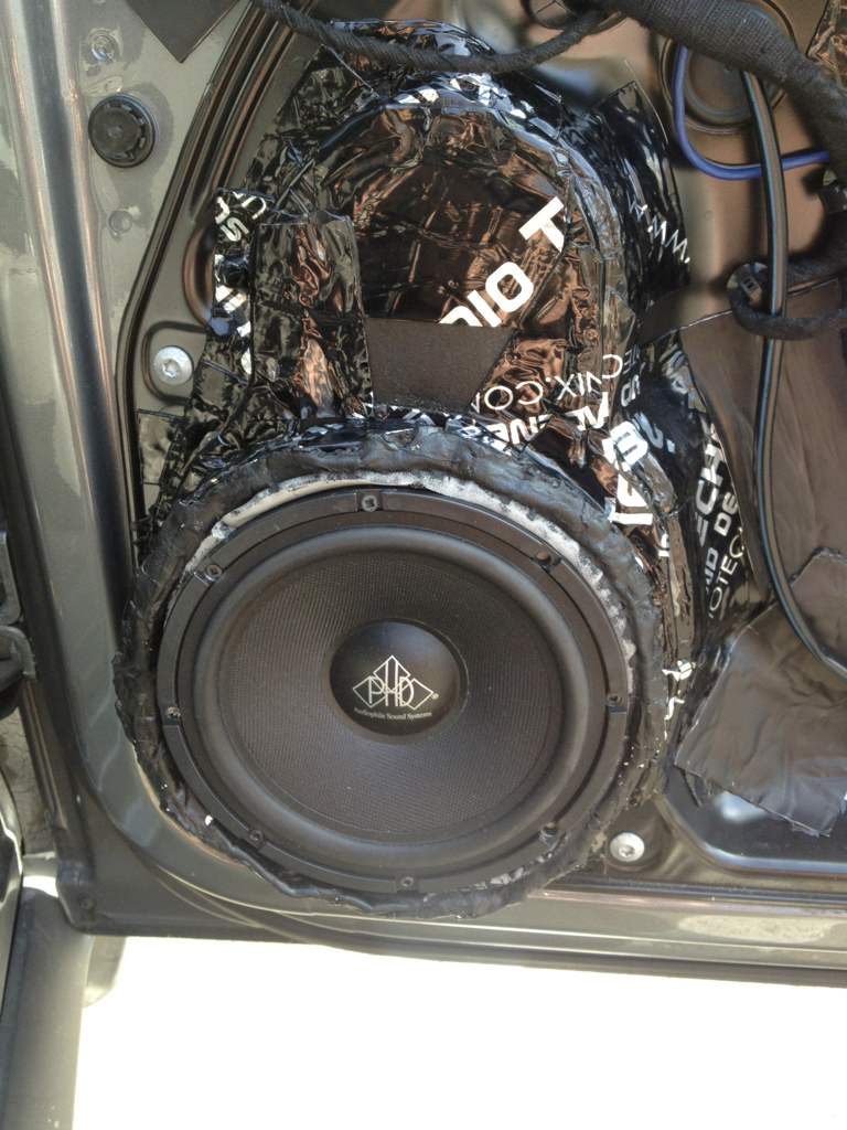

Congrats bud. Looks like a pretty sweet system there. I would focus the majority of that sound deadener application to your front doors since the MS comps will receive the biggest benefit from good application of deadener. As for the foam around the surround, here's an idea for the sealing Trumpet was talking about:

Thanks for the images. So you used foam spray stuff around the edge of the outer speaker ring to the door panel then deadened around it? Also did you use anything else besides the dampener and foam? Like butyl rubber weather strips or anything? And inside the door where the mid goes in did you do anything there with foam or just deaden on the back door panel?

I used these three items for esssentially everything:

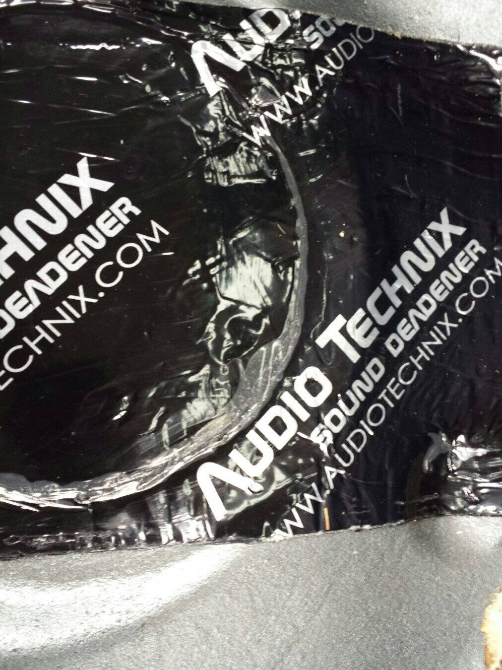

1. CLD - I had 10sqft of AudioTechnix that I got in a giveaway as well as a bunch of Second Skin Damplifier Pro. The Damp Pro is head and shoulders better in quality. The top layer of that AT is actually plastic. Here's what happens when it sits around for a while (this is under my rear bench):
That clear part is where the butyl started sagging and separating underneath, leaving the plastic on top
2. High Density Foam Weatherstripping - Found at any hardware store and used for going between the underside of the basket and the mounting surface and decouples the speaker from the baffle. Holds its shape really well
3. Sponge Rubber Weatherstripping - Found at any hardware store. Use enough layers to reach your door card plus just a little. It will compress with the door card attached and keep your midbass from leaking all over the inside of your door card
Doing #2 and #3 were probably the biggest, most immediately noticeable improvements, so if you're on a severe budget, those would be the first steps I'd take. As for the CLD, I've already shown you why I would NOT recommend AT. It does not hold up to the heat nearly as well as they claim. I had strings upon strings of stray CLD when I pulled my door card off to do Step #3 this week. The Damplifier Pro, however, is AMAZING. @Vertex Audio ; can help you with ordering some of that.
