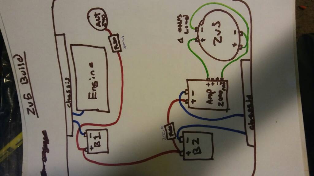

Just for verification on my first real subwoofer install...
Working on my first install where i have to beef up the electrical and wanted to just make sure im not missing anything as im very new to the car audio game. Heres a sketch up of what i think needs to be done. Is there anything im missing or does this look about right? I know this is simple to most of you guys but we all start somewhere!

Sundown Zv5 18 and a sundown 2000

Ok then, you have your subwoofer wired wrong in the diagram (I am assuming you have the Dual 2 ohm config)
You want to connect the positives together and then the negatives together.
That will give you a final ohm load of 1 ohm
if for some reason you have the dual 1 ohm config then more discussion is needed as your choices are either .5 ohm or 2 ohm final load

Oh ok gotcha. Yea i have the d2 and plan on running at 1 ohm. Appreciate the help like i said im a noob with this stuff
