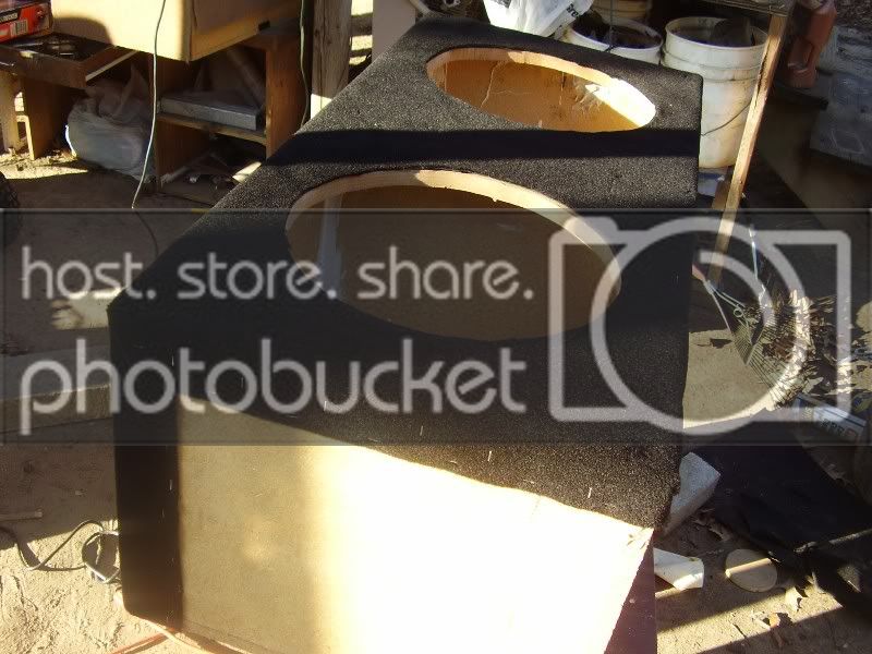

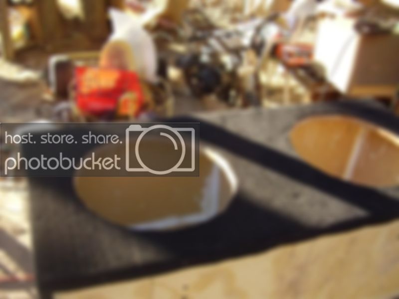

So i just finished building my first box. Its 3/4 fiberboard and mdf ( yes fail i know i used fiberboard due to price and its a practice box). i secured it with 4 inch decking nails, I used gorilla glue in all the seams then on the inside i went around all the edges with a ton of liquid nails to ensure its sealed good.

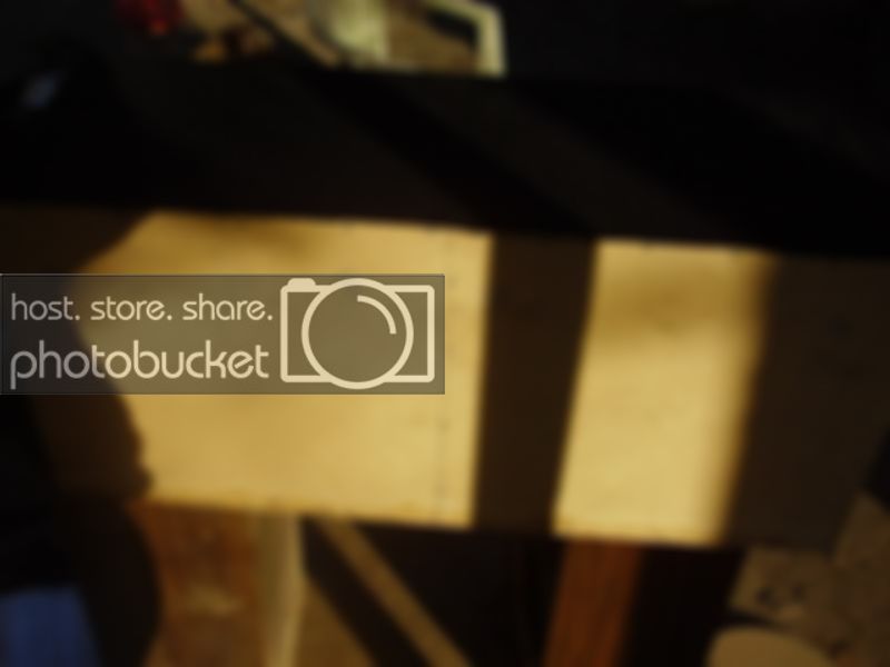

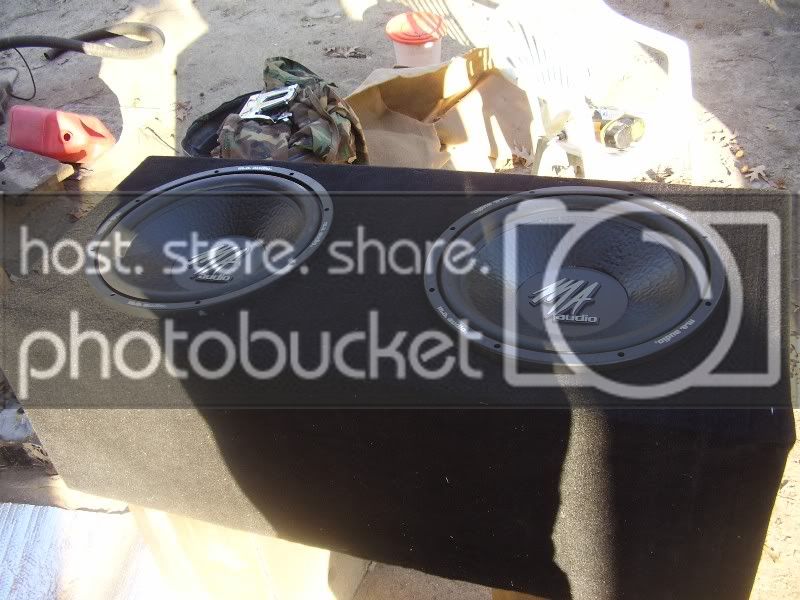

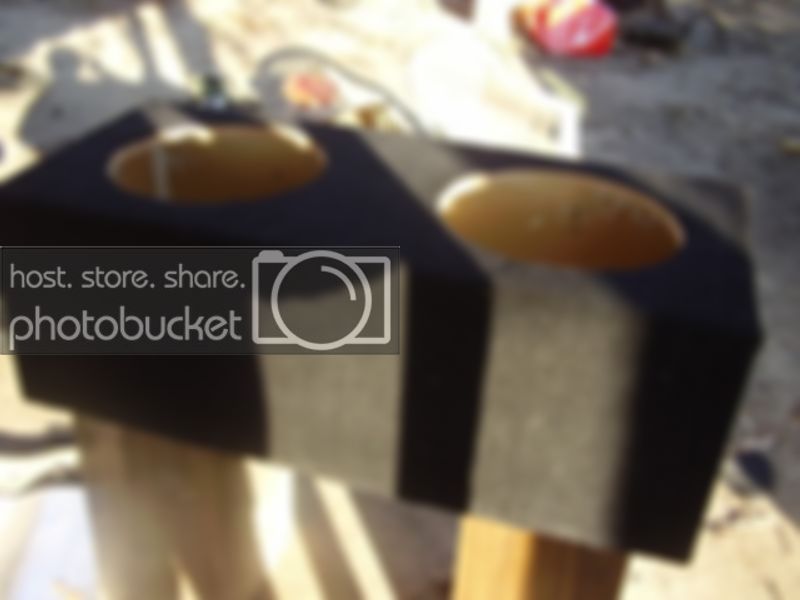

This was my first attempt at carpeting too. I layed down some adhesive and used staples to hold it in place. I didnt have enough carpet to finish it but the front/top of it is done which is what you will see anyhow. Im gonna paint the remainder of the box black with a couple coats just to help it look better. The box is 2.25 net per chamber which is perfect for the subs i have.

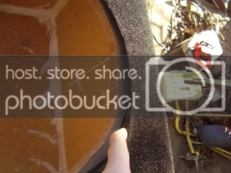

I was wondering though, when you guys carpet a box, do you have carpet in between the sub and the box when its mounted? or do you cut the carpet around the mounting diameter so the sub seals flat to the box? In the last pic youll see what i mean, i outlined the sub then put down the carpet, but im not gonna cut it if i dont need to. And do you think i should use speaker terminals? I was just gonna run my wire (12g) through a hole and seal it up as it seems thatd get the best connection. //content.invisioncic.com/y282845/emoticons/confused.gif.e820e0216602db4765798ac39d28caa9.gif Also feel free to flame about what i did wrong so i can learn for the next build //content.invisioncic.com/y282845/emoticons/smile.gif.1ebc41e1811405b213edfc4622c41e27.gif

For your first time it's not bad. Leave the carpet the way it is so it'll sit between the sub and the box. You shouldn't ahve to use staples to hold it in place though. Use some 3M spray glue and it will stick into place immediately.
I know this is a practice box, but make sure to use MDF next time. It's much easier to work with. The 4 inch nails isn't the best idea either. Use 1 5/8" drywall screws. Also, I've never actually used gorilla glue to glue my boxes together, but since it is somewhat of an expanding agent, I would think it would loosen the seams. There is no reason not to use wood glue - it's more than strong enough if you use screws and clamps to hold it together while its drying. As for going around the edges to ensure an airtight seal, use silicone instead of more glue.
Terminals make quick disconnects easy and give you more than an adequate connection. Just make sure to silicone them in place, as they're usually weak spots in a box. You could also buy some special connectors that resemble screws with terminals on both sides from parts express - that would be your best choice.
I **** at carpeting, so I'll let someone else help you with that. Although I do know that putting the sub on top of carpet is actually a good idea, as it helps to ensure a seal. Also use spray adhesive instead of staples.

Titebond III is about the best glue I've ever used. I've had the wood tear or splinter before the glued joint itself gave away. I think its a good idea you practiced first with the particle board. At $10 a sheet you can screw it up all day long and be out alot less $$$ I'd say practice a couple more times with that cheap stuff 'til your comfortable then switch to the MDF. You can leave the carpet or cut it away and seal your subs with a foam tape, silicone (redneckin' it), or buy some tape just for sealing speakers from a place like Parts Express. You're decision, but for now i'd just let it go. Enjoy what you have and keep on plannin' for your next build. You did a pretty decent job for your first time I look forward to seeing your future projects.
