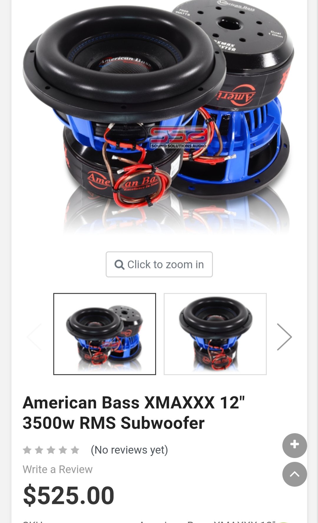

Look at this sub. I'm not sure if it matches your criteria though.
