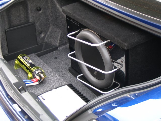

I questioned the ventilation also, but i keep my back seat pass-thru open all the time, and this is how its setup:

Low voltage + your trunk is probably really hot.
If the voltage was low wouldnt the voltage display on the cap be bottoming out? Like i said it never drops below 12.0. And where the hell else could I put the amp where its better ventilated? It cant be better to run 6ft of wire to the amp in the passenger compartment???
