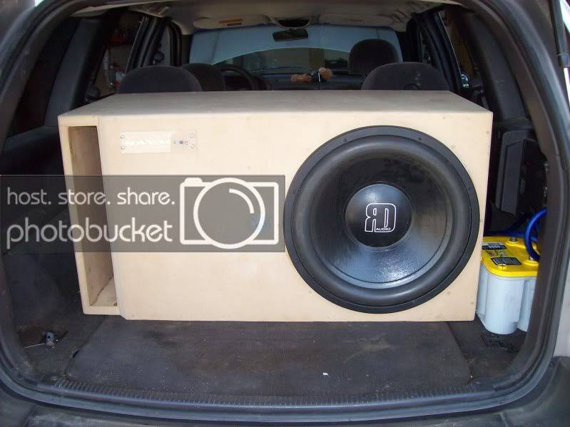

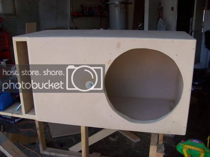

Install includes :
1" MDF box , double baffle (2") , .5" all thread , 6.4cuft @34.5hz
RD Audio Alpha 18"
RD Audio 3250.1D
2 Yellow top optimas
Kicker 1/0 wire kit
more pics soon
real similar to my old 18" box..... //content.invisioncic.com/y282845/emoticons/sneaky.gif.7189749b3a3f769e8815b47e8ae87f88.gif
The best cure for those rattles though is just taking down the headliner and filling the ceiling rails with liquid nails. Also, you should probably fill the entire back door hatch with expanding foam (which is what I did too) ...got rid of alot of rattles and even improved my score just from doing that. Oh, and new rear door hatch seal should be replaced if yours is leaking.
I did the build for a friend but well be looking into those mods I havent droped the headliner yet , do you have to put alot of liquid nails into the rails ? like how many tubes ? and the tail hatch thing will definitely get some foam then.
