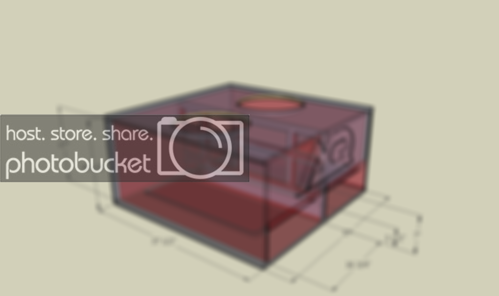

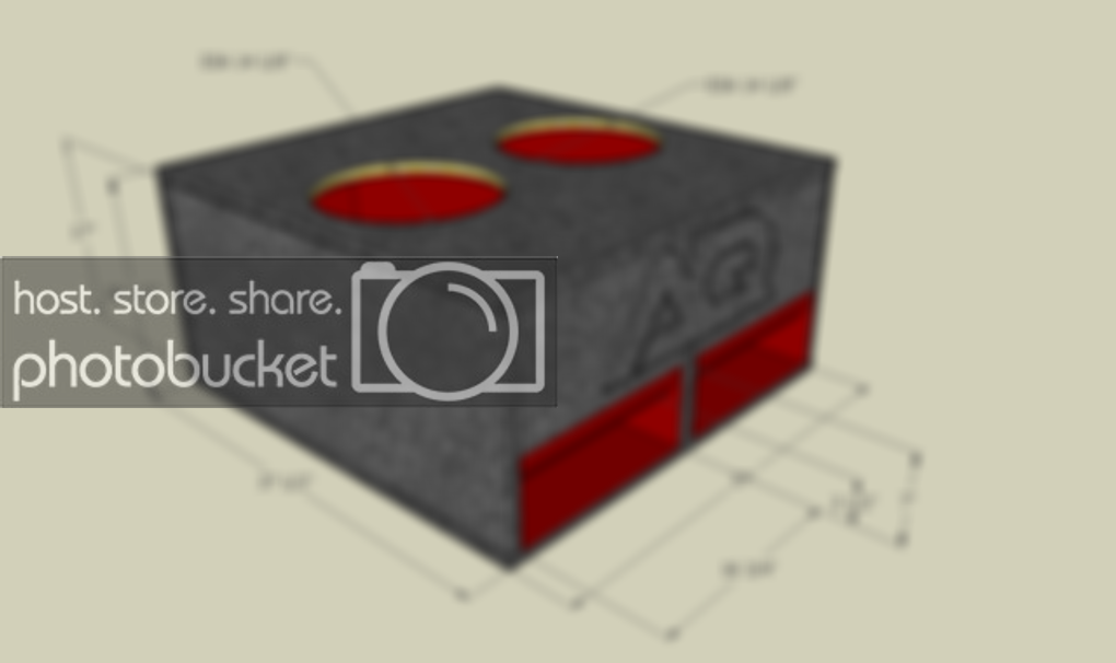

This is just a prelim sketch for size reference...
BJ Fisher hates me....
Nice work.
Looks kinda like a smaller version of this one I designed (I borrowed the logo idea from Dylan //content.invisioncic.com/y282845/emoticons/smile.gif.1ebc41e1811405b213edfc4622c41e27.gif).
That's a big mamma jamma.
Window bracing works very well for strengthening the overall structure //content.invisioncic.com/y282845/emoticons/wink.gif.608e3ea05f1a9f98611af0861652f8fb.gif
yes it does.....it makes the over all structure very sturdy
but it also effects the way the woofer cups the internal CF3
and causes turbulance everywhere around it
simple physics...if air has to go around it there is friction and turbulance applied
and if the window bracing cut outs do not exceed the woofer cone area you
will get a bandpass effect inside the enclosure
thankyou everyone thinks window bracing looks cool and all that .. but it really hurts the box as well as helps... ya its bracing but its also turbulance..... just make it solid.. if its going down the middle of the subs.... i dont use that bracing at all thow i just use standard pieces of wood that are arranged correctly to support the box ... which is a lot better then air tring to go throw holes and find its way around
Bracing on this particular project would not be for "looks." So thats certainly not why it is like it is.
I will not argue design aspects, because thats not my area of expertise.
But from a structural standpoint, I dont think there is any other style of bracing (per cubic inch) that provides better support than window brace.
Would you really notice any difference other than on a mic?
