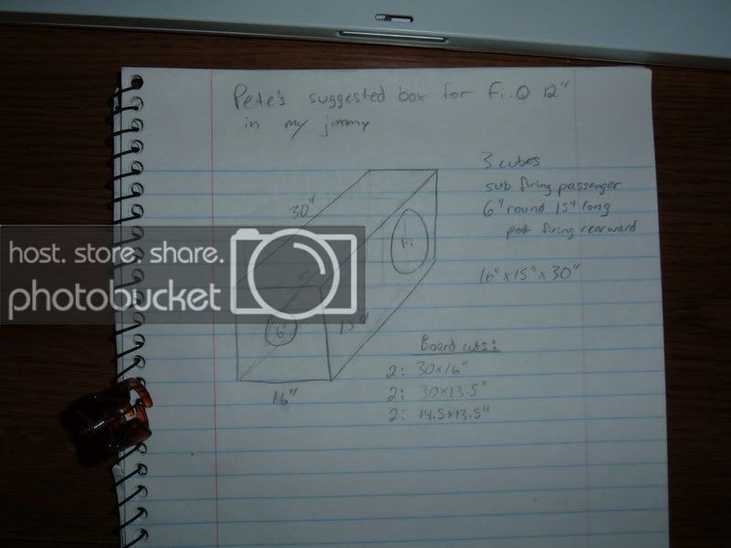

is this too big for my cvx?
95BlazerLT4wd
someone from another forum built a box to these specs for his 12" Fi Q. he said it sounded amazing in it. Since the cvx and the q are similar in recommended specs for port box cubes do you think this box would be to big for a 12" CVX?
kicker recommends 1.75-2.25 cuft
fi recommends 1.8-2.5 cuft
