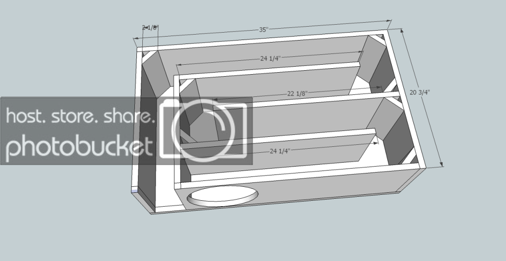

please dont, you are just screwing up every other noob that might stumble across this thread. Its a labrynth slot port Basic port. T line has to be the same port area throughout. What you have is just one big chamber and a long port, not any resemblance of any real T line. Its WAY too small to be a T line as well. IS A BIG DISRESPECT to T lines when you call that piece of abomination a T line.
This is proper T-Line there WAS NEVER a short T line. What you are doing now is basically equivalent to telling people to buy amps based off peak and max power...
See how ITs EVEN throughout the whole line? Thats what makes it a Transmission line. Just because some idiot on amazon uses a marketing gimmick doesnt mean you should mislead others too, thats a very shady and underhanded practice.

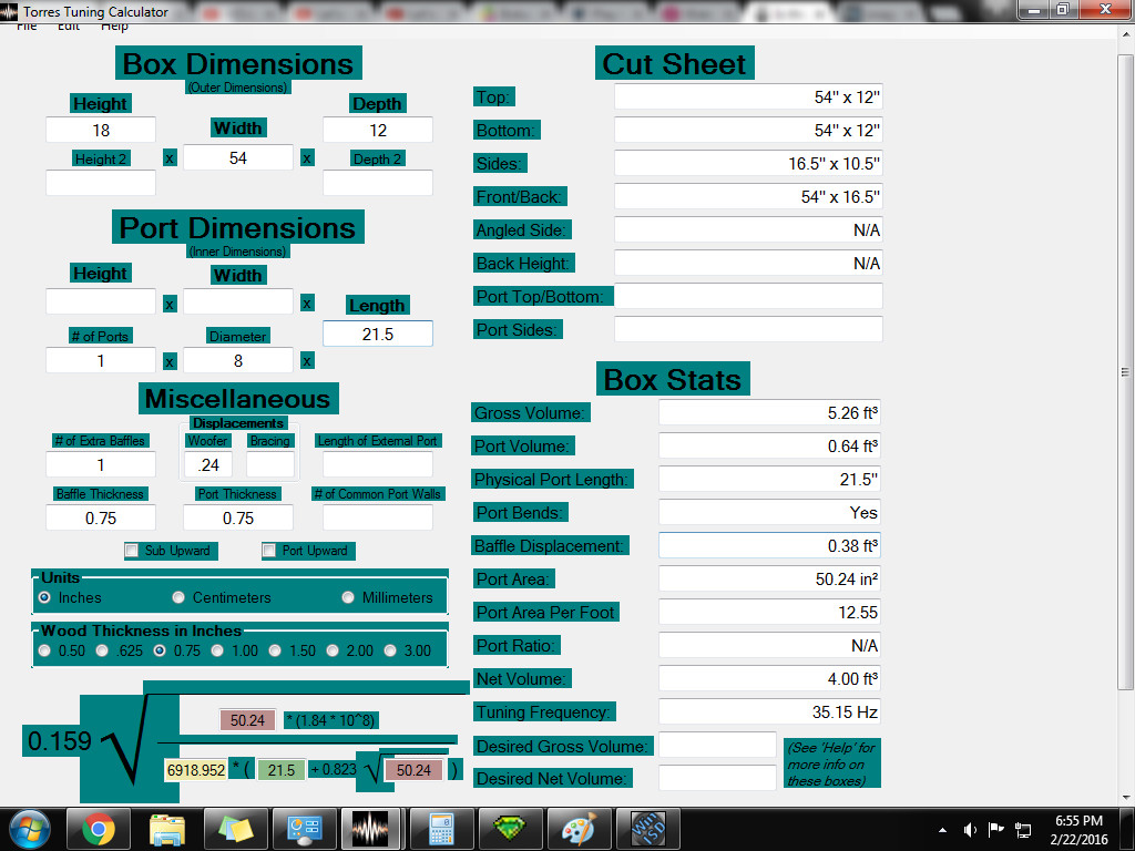

54" max width , probably 14" to 18" height and depth as lean as possible , I'm basically trying to stay as low and shallow as possible by taking advantage of the width.
2 cubes isn't going to be enough for 2 12's.You could just make a 4th order and throw all your family stuff on top of it. Subs won't get damaged because they'll be inside the box, and you've got a van so should have a decent amount of room.
Allow me to correct myself , I meant 2cu each so 4 cu total
