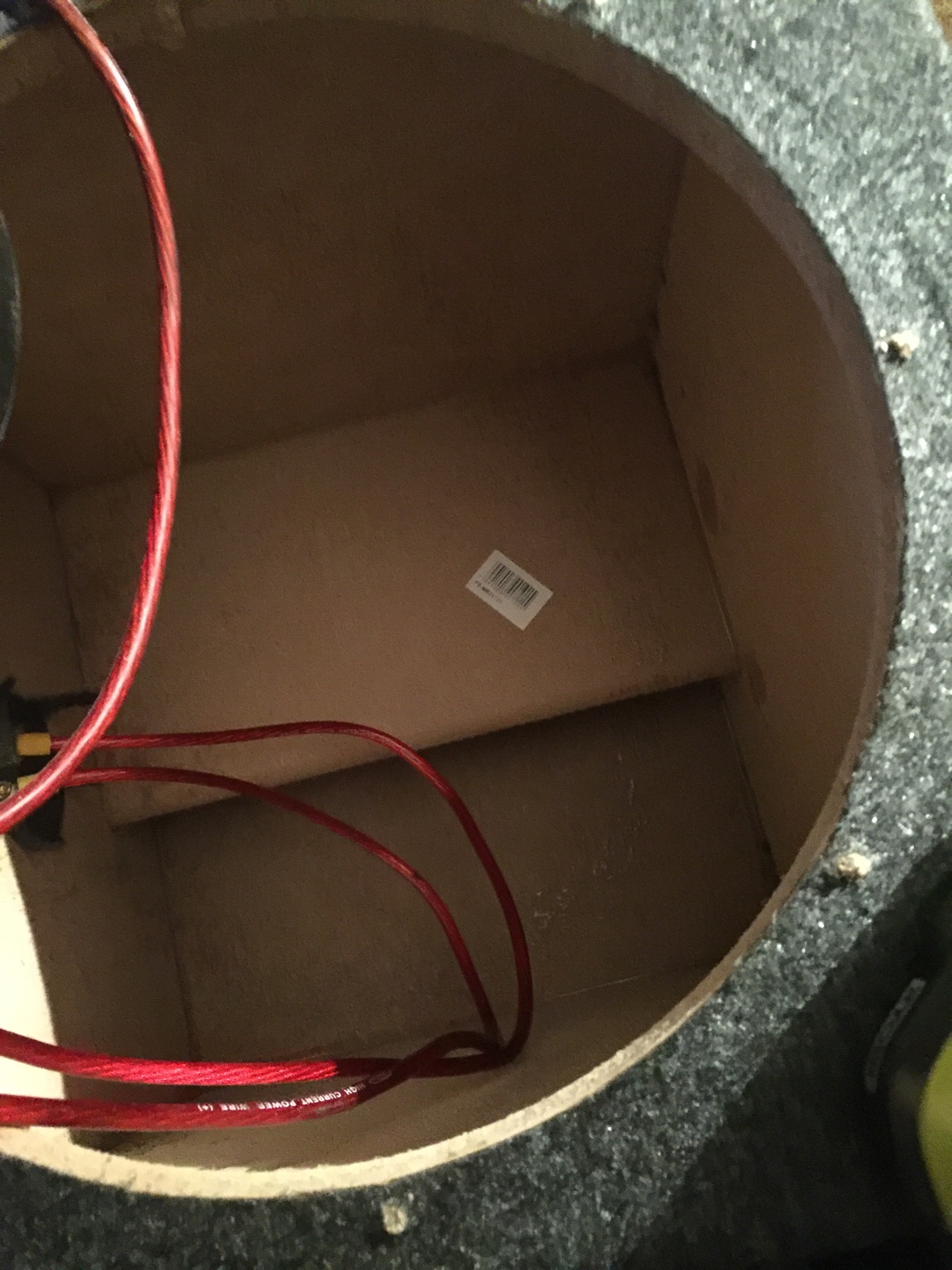

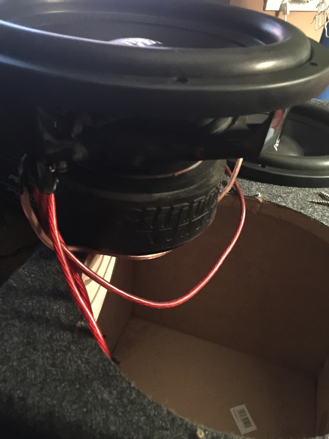

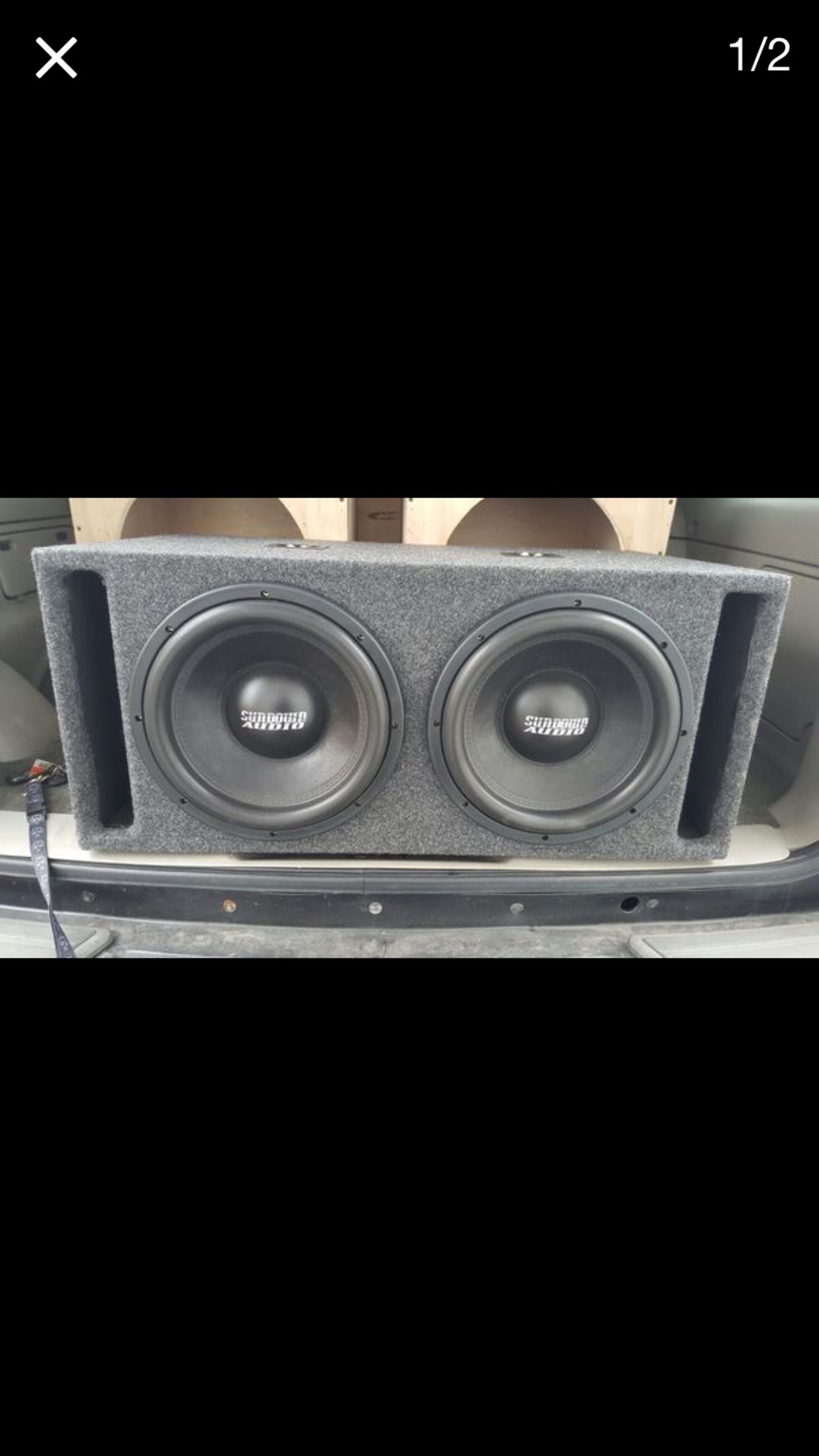

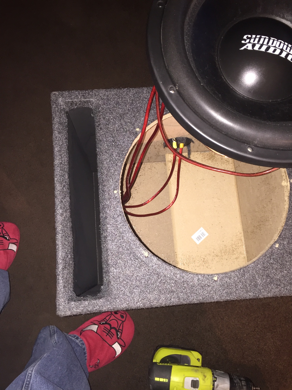

250$ for these and it's In a prefab. Should I take it ? Box is new and subs are still stiff - excellent condition
Maybe not custom as I thought but a t-line . Heavy gage wires , not too bad so far. Gonna set it up and listen to it shortly.
It's a short t- line - it's not an L-port . And I know the eBay crap, it's all over the flea markets, this is better than that but not a custom as I originally believed.
you are deluded, ITS NOT A T LINE its just slot port labrynth style. ITS A CHEAP PREFAB you get on ebay, cheap prefab ebay company called RT enclosures on ebay do that slot ported design a lot. A real T line would be triple the size of that current box. If you have no knowledge on how a T line is designed, dont try to prove a point in which you have no authority to prove. T line is subwoofer specific based on the cone area and FS of the sub and that is no where near enough sq inches of port area.
I don't know if it would really be considered a true transmission-line box. Just ported. I get that the port is folded back, and not just an L. Folding the port back again doesn't make it a t-line box. They're much longer. I forget what wavelength or whatever makes them technically a t-line
