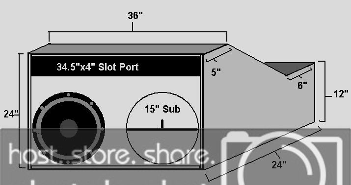

Okay, so im crunching numbers to try to have the loudest (while still having sq properties) 240sx in existance.... I came out with a box with roughly just over 8 cubes internal volume.... I want to have 4 4" aeroports or possibly a slot vent, tuned to 35hz. Would this be overkill for 2 MAW-15's?
well, I can gaurantee you arent going to be the loudest 240 in existance with MAW-15's.......
Budget permitting. Its why I went with 8 cubes, so that when I can splurge on better subs, theyre going to like their home. Theyre jsut going to be placeholders. catch my drift?
I wouldnt think 4 4"s would be enough, thats what..~50in^2? Why not get some 6" from PSP and do maybe 4 or 5?
Might as well make myself some 8" ports from pvc eh? LOL
Drew this just a min ago. Everything is drawn to scale //content.invisioncic.com/y282845/emoticons/fyi.gif.9f1f679348da7204ce960cfc74bca8e0.gif
