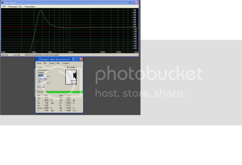

is this curve good or not? pic inside!
Mr Bojangles
Bullhockey
Is this normal or not? It doesn't look right.. In order to get rid of the peak I have to lower the box size but any smaller and there won't be a box! Is the 7db gain a good thing or not??
Sorry.. If you can't see the box volume it's 1.3 tuned to 36.83hz
Driver specs are:
RE = 1.45 ohms
Fs = 38 Hz
Qes = 0.4686
Qms = 9.290
Qts = 0.4462
Vas = 4.34 L
BL = 16.11 N/A
Cms = 50 um/N
what do you mean it's going to be massive in the vehicle? Like too loud? And the only way to flatten it out is to make the box .2 cuft! Thats ridiculous small.. The speaker won't even fit in that..
thats not the only way to change it man...
go with the manufacturers recomendations, like Jim has said. i think you have alot to learn before you start designing your own enclosures.
