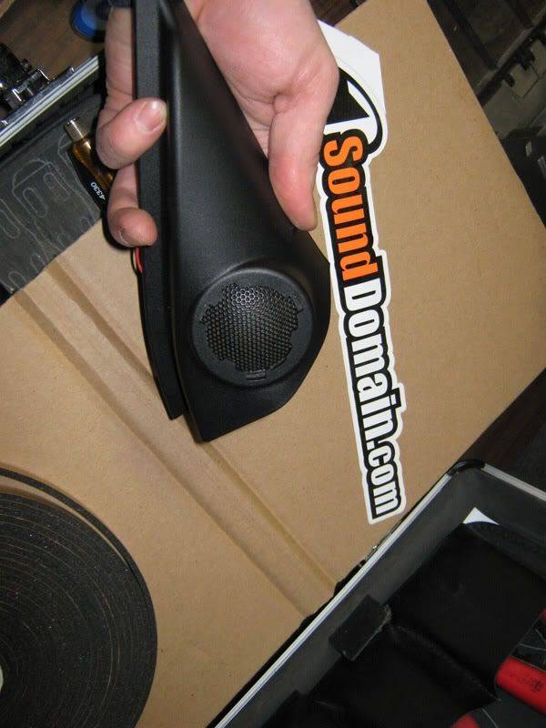

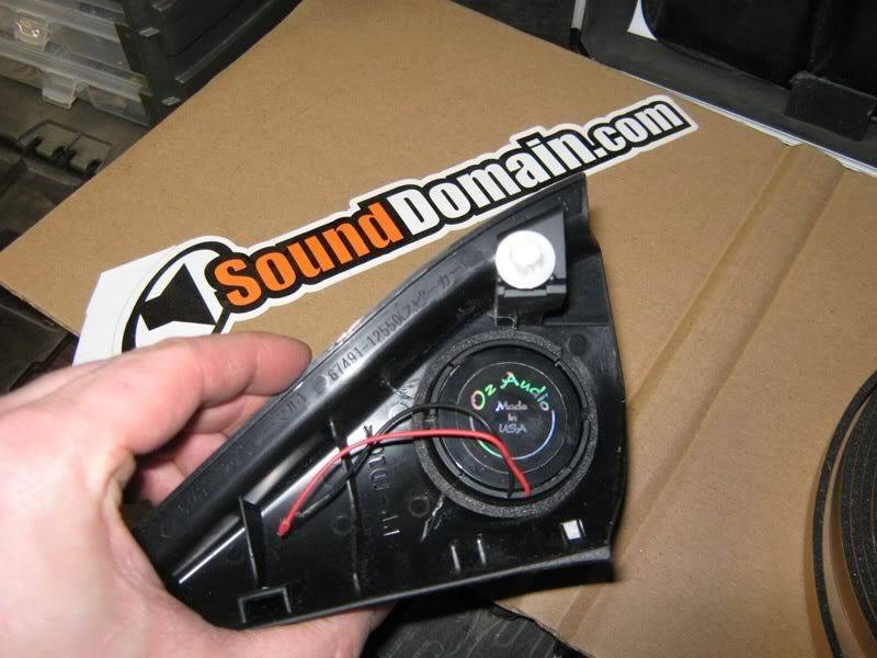

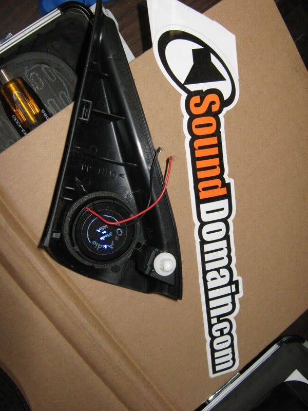

how i mounted some tweeters to factory sail panels of a 2008 Scion xB

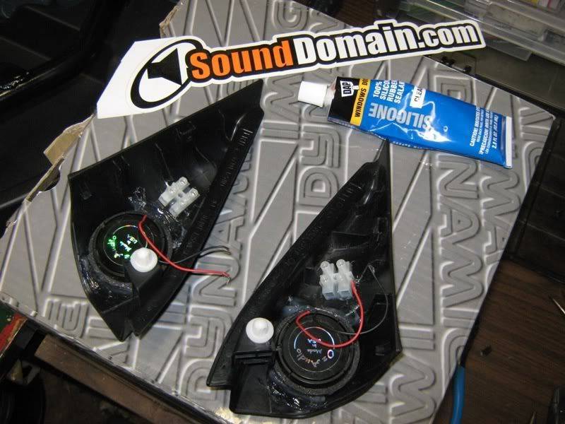

i used weatherstripping foam around the tweeter to create a seal, decouple the tweeter from the housing, and give me something to glue.
then i used silicone to secure the foam to the panel, and also to secure the wiring terminal. silicone sticks to foam, foam sticks to tweeter. all of this is removable if needed.
they sound decent in the xB thanks to the dash layout. the sail panels are a bit lower than i typically like, and the steering column/dash hump interference usually makes them a poor place - you get reflections off of those pieces. i typically like getting my tweeters above the level of the gauge cluster housing.
that said, sometimes it's just easier to reuse factory locations.

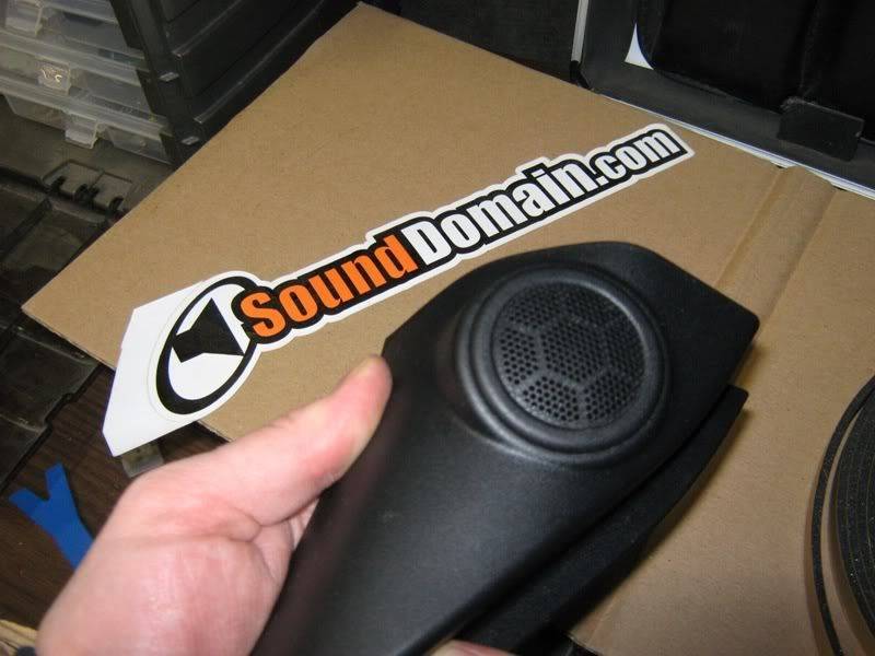

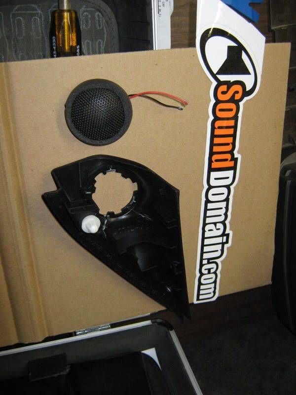

here i reused a factory location in a 2006 Elantra GT - the factory tweeter used a metal bracket with a few screws - so we did the same with a Type-R tweeter:
