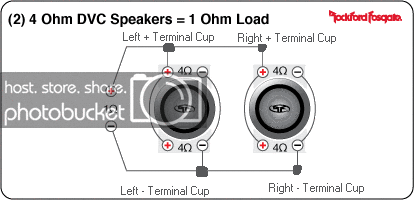

Dual 4ohm subs parallel will equal a 1ohm mono load on a mono amp.

Subwoofer Wiring Diagrams
Look at how to wire your subs. You wire multiple subs together to get your final ohm load for the amp
