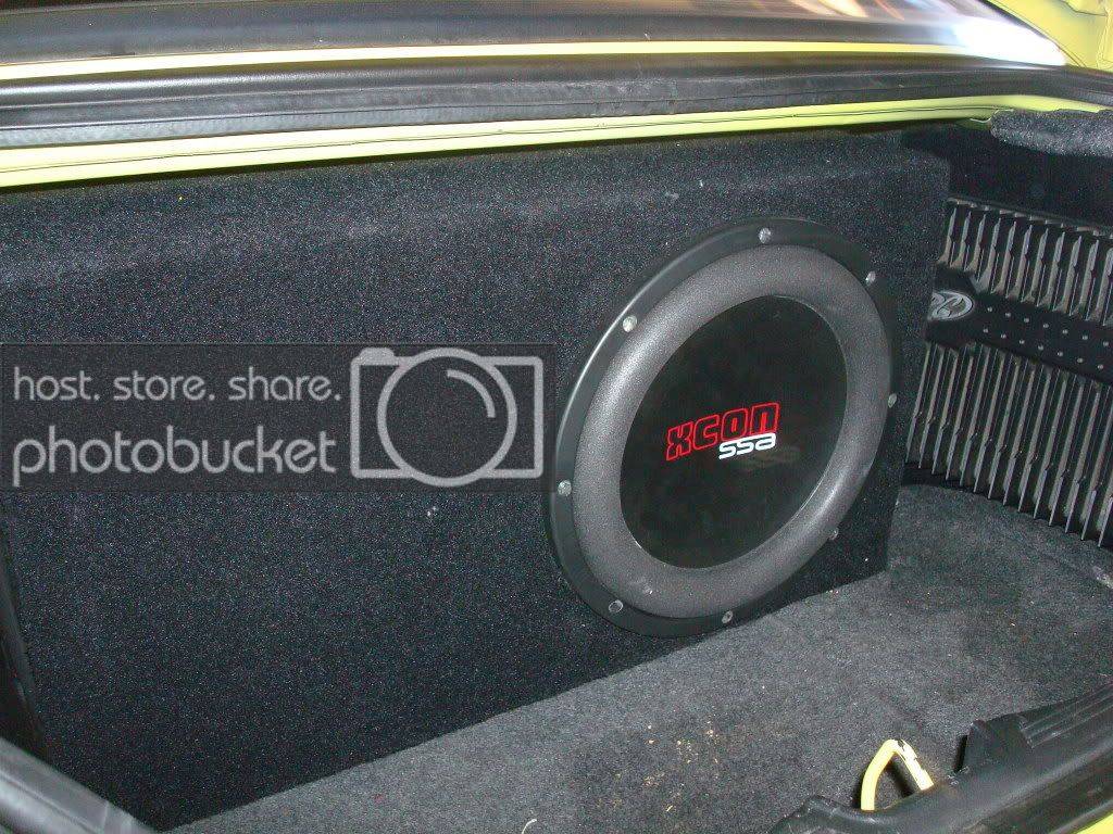

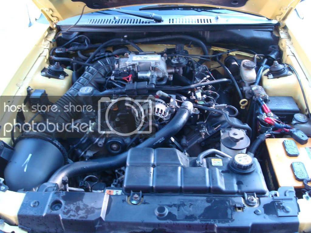

I had more power than that, true rms power, in my 01 GT. I had stock alt and a XS Power batt. I didn't even have the big 3 upgrade. I never seen lower than 13.8v. Your setup definitely doesn't need a second alternator. If you're gonna get an extra battery, get a XS D3400. Here's pics of my setup when I had the Mustang.
