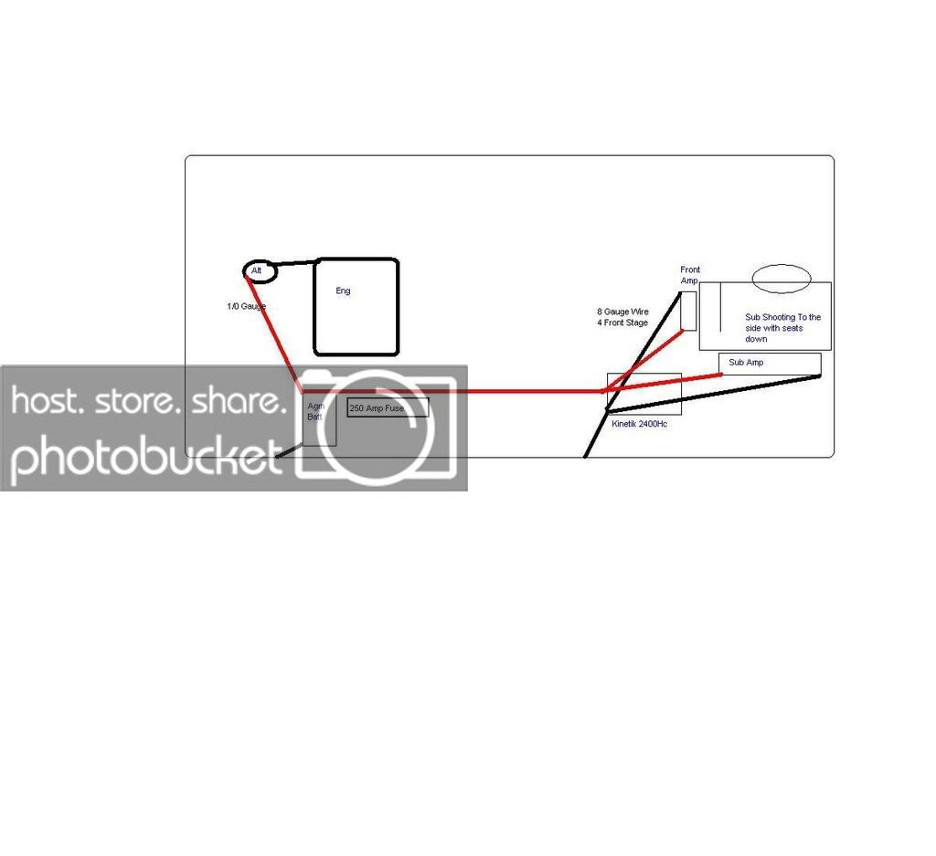

Is all this wiring correct, pic inside
chase008
Is this correct, O yeah btw I forgot to put the Chasisi to Eng Block, Its not on the picture but I did it already.

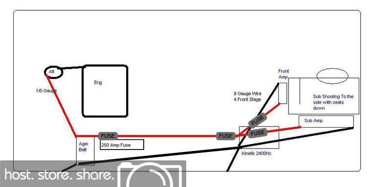

did you put a fuse in between the alt and the front battery and i would add a couple more like from the rear to the front and from the rear battery to the amps or on each amp separately like 100amp to the sub amp and then probably like 80 to the front . and how are you like int agm bat im thinking about getting one but i didn't know if they weer any good or not
I don't need to fuse my alt to battery its only like 5 inches. Same with the battery to amps its only like 4 inches...and my agm battery blows hardcore even with all my subs and amp out of my car my overhead light dims, The battery is a 05 so its prob time to toss it, i'm gonna put a kinetik 600 in the front or a 800... I just like the agm cuz the one I have now is really really good for the cold temps like -20..
you should still fuse in between the amps and the battery cause if say your battery shorts out it could blow the amps . rather be safe and put in a fuse that you don't think you need rather them blow an amp
I ran a system for 2 years with no fuse, lol. Plus I don't want to spend 30$ for a 1/0 fuse right now I prob will in abit but I just took 2 months off work cuz my dad has prostade cancer so money is kinda tite for me
