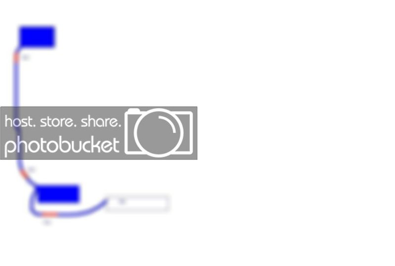

Ok so the positive-positive put two fuses, one on each end?
if you were really worried about it i would put two fuse blocks on each end of the run of the wire. closest to each battery as suitable like 10 or so inches. because you have current coming from two different ends and if one side gets shorted out it will stop the flow of power from one battery but the other one could still be shorting out
man u can use 1 big fuse on the main line, thats all i did
that's not the point, it's to isolate both batteries from the car incase of an accident or something goes wrong with the batteries.
lets say your power wire is running along the passenger trim floor board right next to the doors. you only have 1 fuse up front.
lets say you get t-boned on the passenger side and the impact snaps that wire in the center. the front portion of the wire leading to the front battery will pop if/when the cable grounds itself out.
the other battery on the other hand not having a fuse will still have an active line. what if it grounded out onto the car? could cause a fire or such.
use 2 fuses to isolate the batteries.
i beat you... but you explained it a whole hell of a lot better ha
