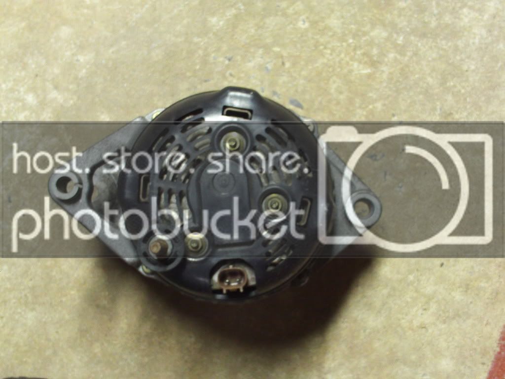

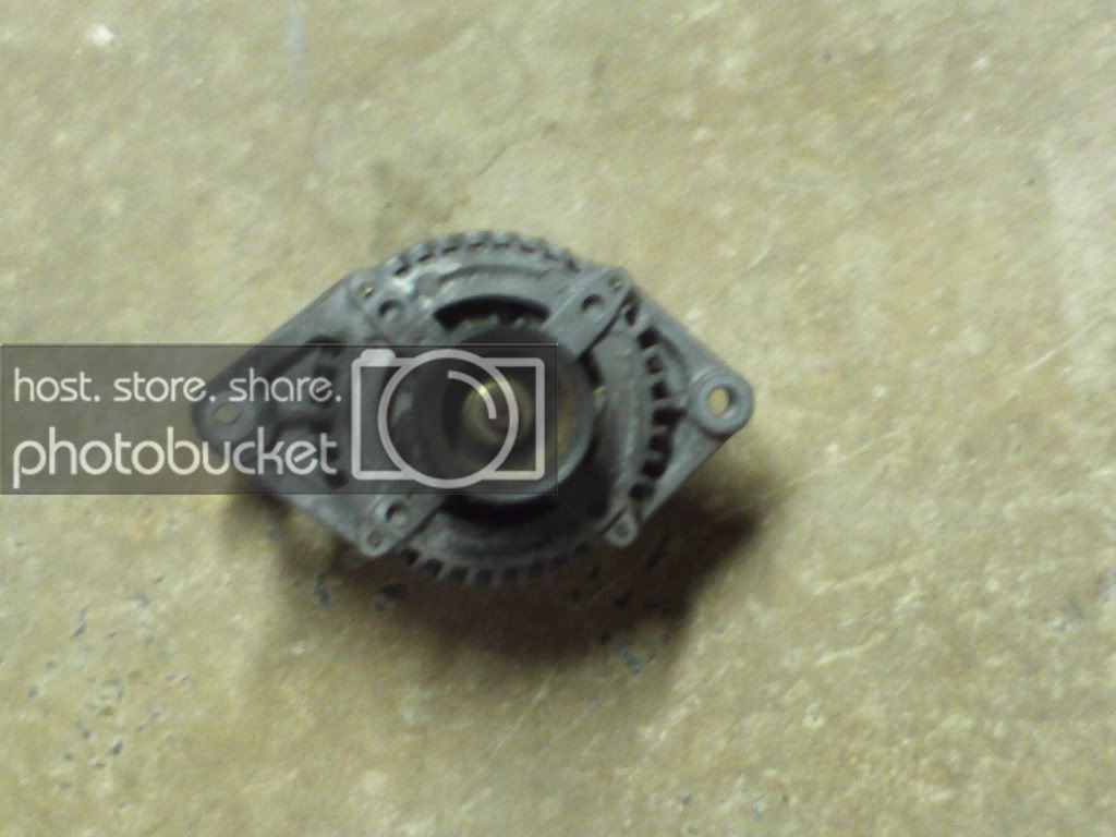

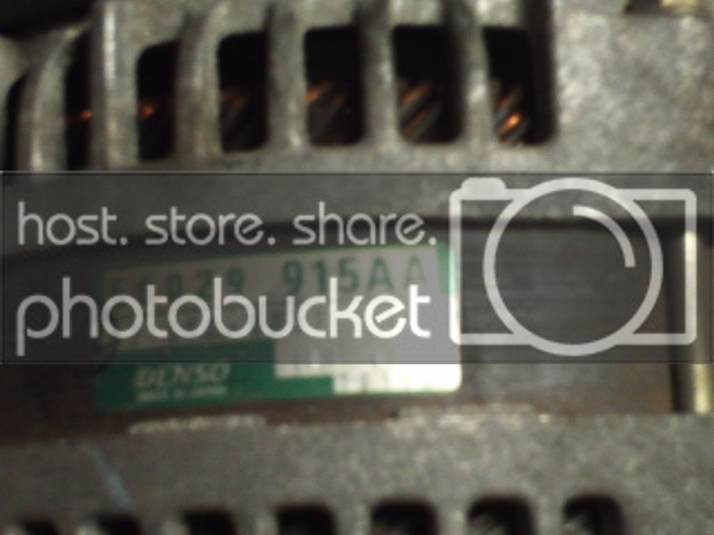

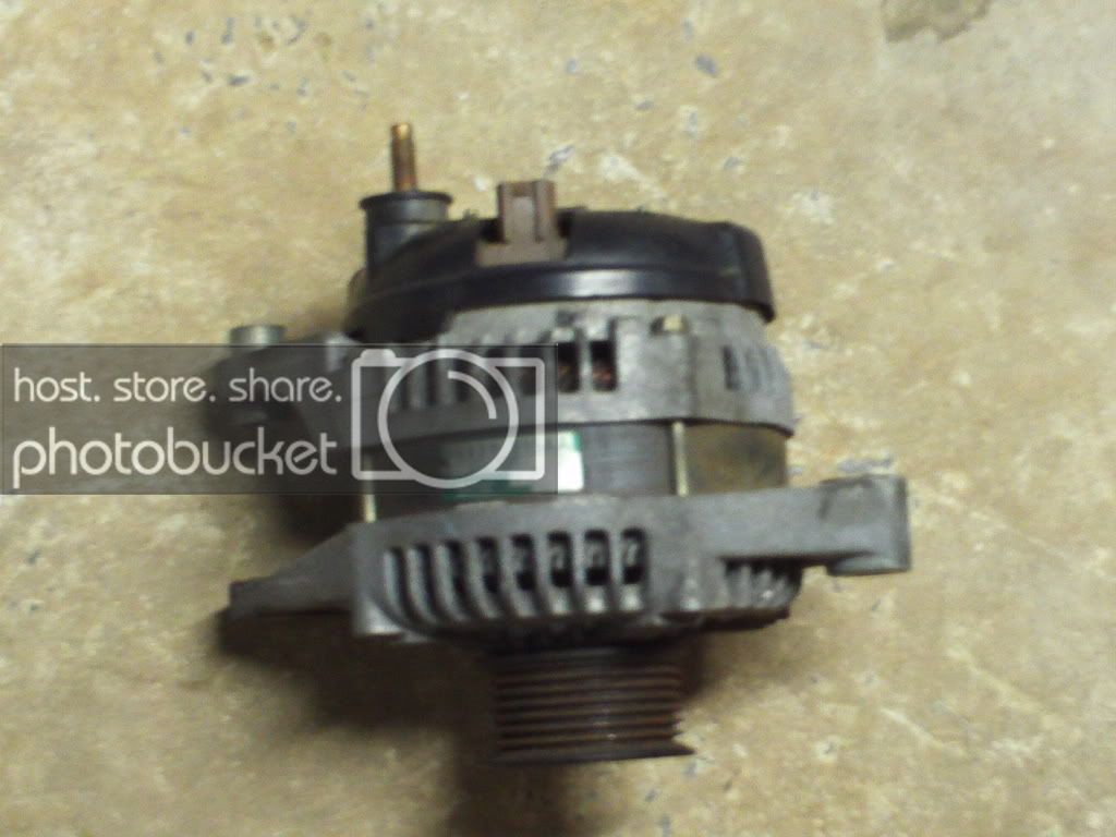

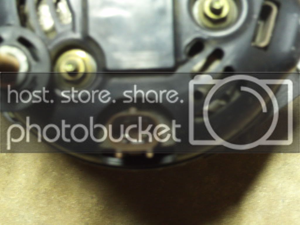

heres some pics if it helps
i have a 99 300m that i was gonna get my stock alt rebuilt when i get my money right. See if you have some places that can do that nearby. That way you maintain the size and have the added amps. mine comes with a stock 130 btw. I have a 3.5 H.O. Maybe one off of a 2.7 engine will fit? See what interpids around that year had as well.
