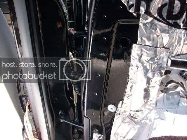

I really want to run it directly but it seems very difficult to run it through the grommet/boot in my honda accord. Its so far back its very difficult to reach. Would I hear a big difference if I ran it directly verse running it from the amp to the factory wires?
In most instances the stock speaker wire is extremely small, so running new wiring is essential. If your vehicle is as bad as you say, run the new wire like so:
- Use a really sharp blade to puncture the side of the stock boot.
- Run the new wiring through.
- Wrap the wire tightly with high quality electrical tape.
- Apply wire looming to the new speaker wire.
- Secure things with a few zip ties.
90% of the time, it works every time...
Alright thanks I have a little better understanding now but when Im running the wire through should i remove the boot completly than cut a whole etc? It seems like it's gonna be a difficult task looks like it.
There's no reason to remove the boot if you're just going to poke a hole in it. //content.invisioncic.com/y282845/emoticons/smile.gif.1ebc41e1811405b213edfc4622c41e27.gif
And yes, wiring a vehicle can be a complete pain in the *** sometimes...
