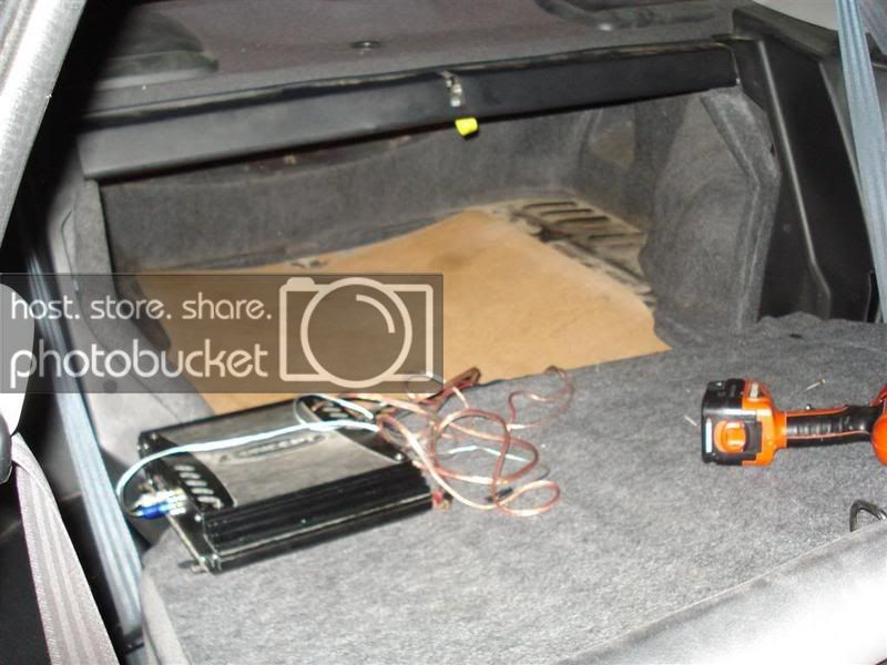

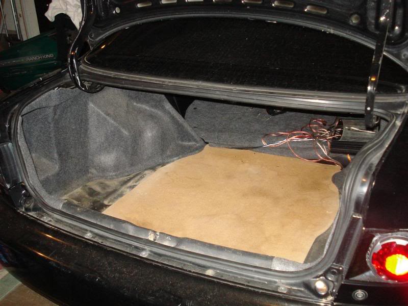

Alright guys.. now its time to move my 2 immortals to my civic.. but the biggest I could get into the trunk (building the box and putting it in) was like 5 cubes and some change.. but now I want to build it in the trunk.. where I can get some more space..
Now I wasn't sure how to position the subs to perform the best.. or at least be loud in there.. I made the first box where the sub was firing up and port back.. loud but not big enough for 2..
I could fire them up and port back but its gonna be huge, and might not perform well in the trunk with the box blocking passage to the cabin..
I could put them both on the face firing into the cabin (seat folds down) but where to port.. because I have like 34" side to side and thats no room for anything but the subs..
I was considering maybe one on the face, facing the cabin and the port on the face as well, and one firing up, as it would be one big box (heavily braced) and would fire through the same port and I would try and leave room in between walls and box so it would also pass into the cabin..
Not sure what you guys think.. I really wanna put both in, but without a wall.. trunk space matters nothing to me.. I just wont be building for a while as im traveling to wyoming to see some buddies, with some guys, and need the trunk for that.. what do you guys think?
Here are some pics of the trunk empty, and the trunk floor mat to give an idea of the shape, etc.. I will post up some measurements in a few and maybe you can help?
Thanks guys..
