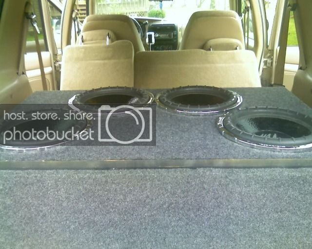

Alrite....oh and the box was pro built. I've alway been a 15" man, but I wanted to try 12"s. The setup I have been wants to do for like 3 or 4 years has been 2 L7 15"s and the 2500. I think that might make me happy.

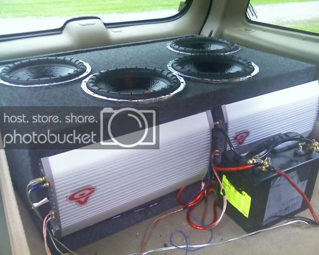

I can't tell you much since a shop built the box. It was built for Diamond D1/D3s but they said I could use other speakers. There is a giant port going across the box. I had it modified last year because I was playing C&S with that setup and it broke the port. People tell me my stuff is loud and they get headache, but I get a headache and twisted guts in my boys.

you gotta move that battery somewhere though, switch out to some small batcaps and hide them under the seats or just do a big g31 battery up front with an alt.
Do that box ^ with 6 4'' aeros between 16-18'' long and you should be **** close to a 150.

Is that 4 gauge wire? Your wire may be choking your system.Build a new box and get heavier wiring and some fuses.
not with having that second battery, if he is runnig factory alt he's only passing 100 amps or so through that 4 gauge into the 2nd battery...and the lengths of the other runs wouldn't matter what size wire he used
