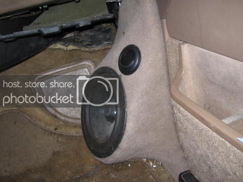

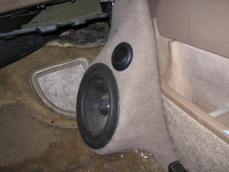

my old custom Q-logics;). Vifa PL's and RE Tweets. Ran the pl's off 150rms and the tweets off 40rms fully active. twas nice. and yes i know i needed to vacuum lol i had been working on the car all day and didn't want to.
Second pic looks like pinched power wire burned your door...
rarely can i say this to you but incorrect good sir. i didn't do the best cut on the dyna xtreme lol and it was a little to long. after doing that in mid july at 100+ all day in the sun and working on all 4 doors, the roof, the floor and such, i didn't care to fix it lol.
it wasn't much trouble and i got the q-logics for free while i worked at best buy. so i spent a total of 40 bucks to make em' that way.
WD-40 and a rag will clean that right up. Same thing happened to my doors //content.invisioncic.com/y282845/emoticons/smile.gif.1ebc41e1811405b213edfc4622c41e27.gif
