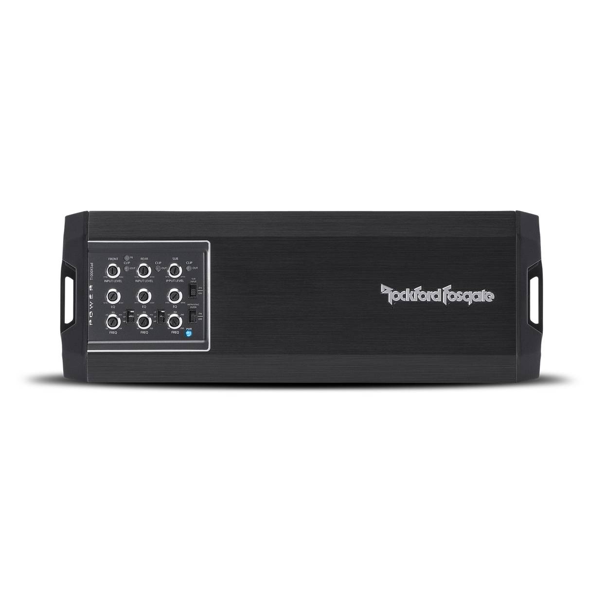

I bought a Rockford Fosgate amp (T1000x5ad) and it provides the following output options for the sub:
400x1 @ 4Ω
600x1 @ 2Ω
600x1 @ 1Ω

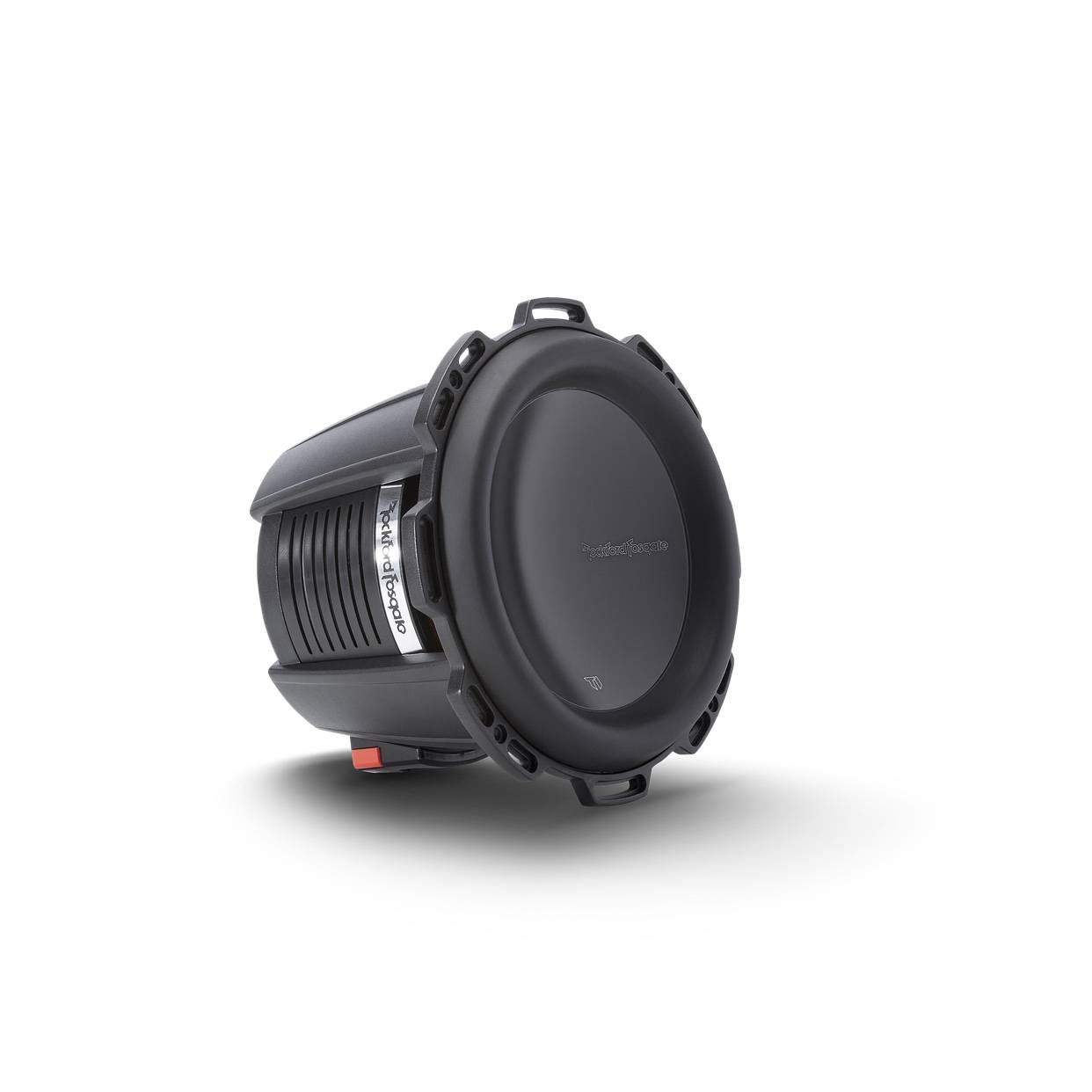

I think of putting a 10" sub which has 600W RMS
There are 2 models, the DVC of 2Ω (T1D210) and the DVC of 4Ω (T1D410)
In the case of 2Ω, I have to make a parallel connection in order to have a final impedance of 1Ω
In the 4Ω, I have to make a parallel connection in order to have a final impedance of 2Ω

Amp: (T1000x5ad)
Sub: (T1D210) or (T1D410)
Running it at 2 ohm is less strain on the amp but if you look at the birthsheet it still makes more power at 1ohm.
To the ear you won't hear a difference and that sub can handle a good bit more than 600w.
