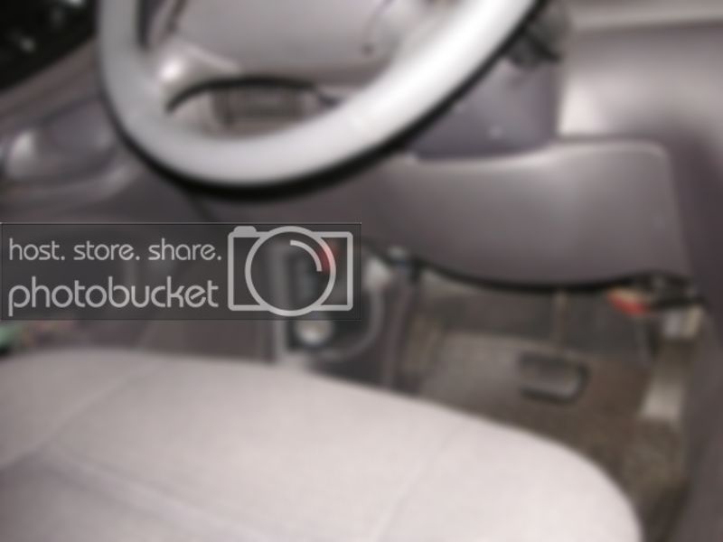

Actually, the kicks might be kinda hard too, well at least on the driver's side. Unless you make some custom kicks. I think the hood-release might get in the way...Hmm...lemme go look at my car and I'll get back to you tomorrow haha. Nice to have someone else on here with a Mustang though. You should check out ca-mustangs.com if you're not on there...

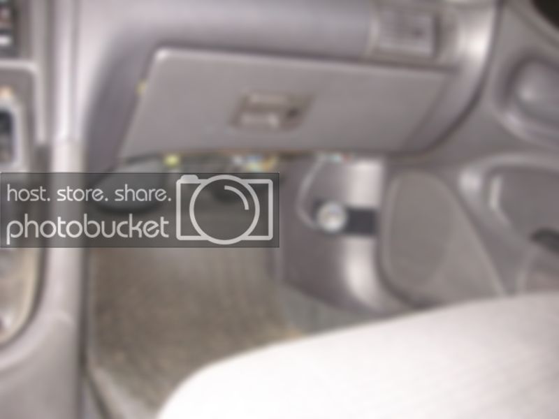

Actually I found a pic of the driver's kick:
I think they would work fine right under the release. Just make sure the passenger side is level obviously. Gonna take a little work to get them flush though. What color is your interior? You could just cover them with some speaker cloth if they don't have grilles.

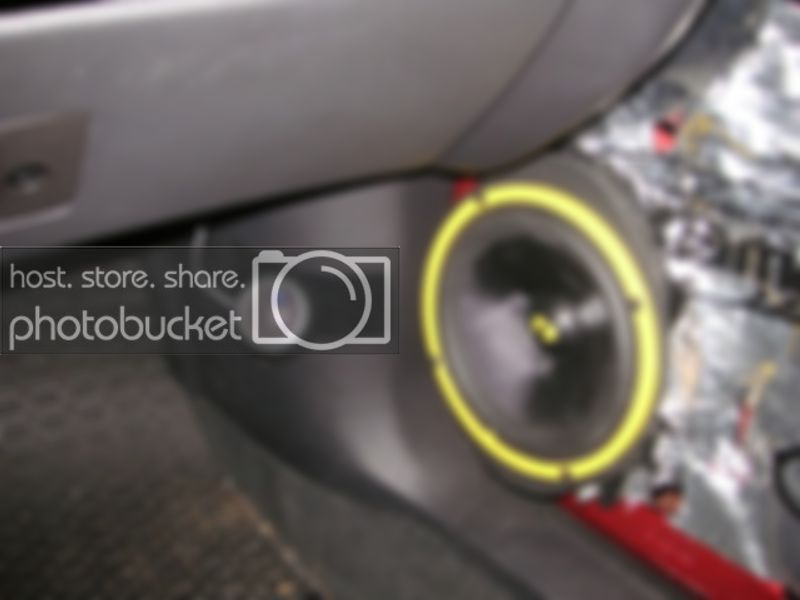

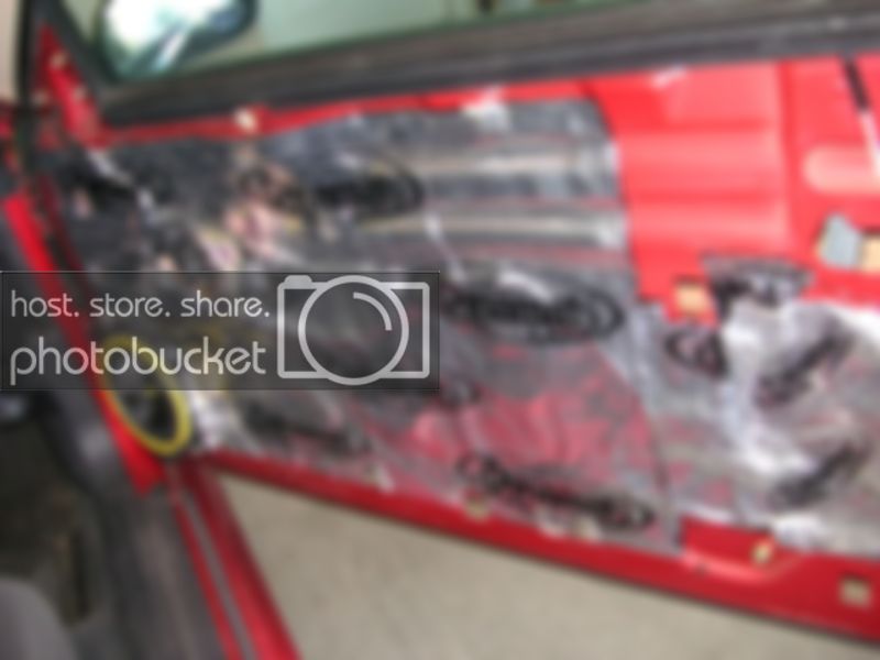

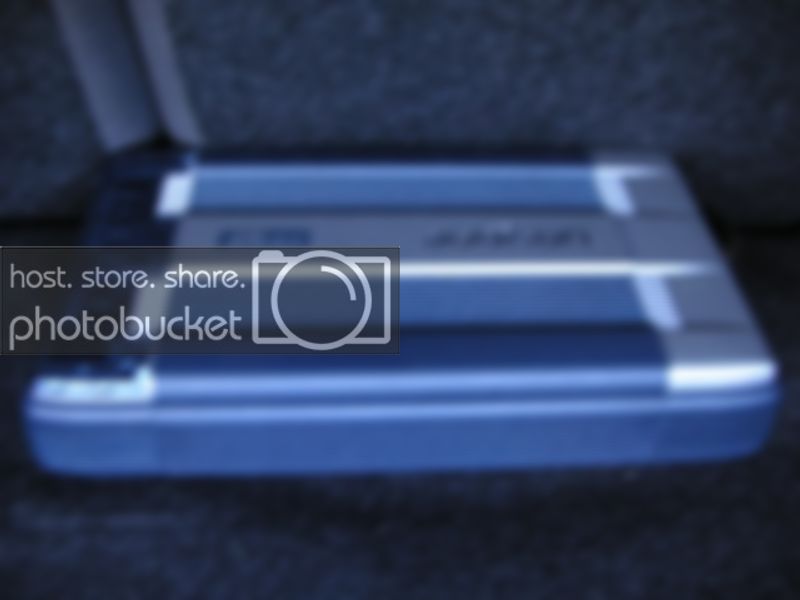

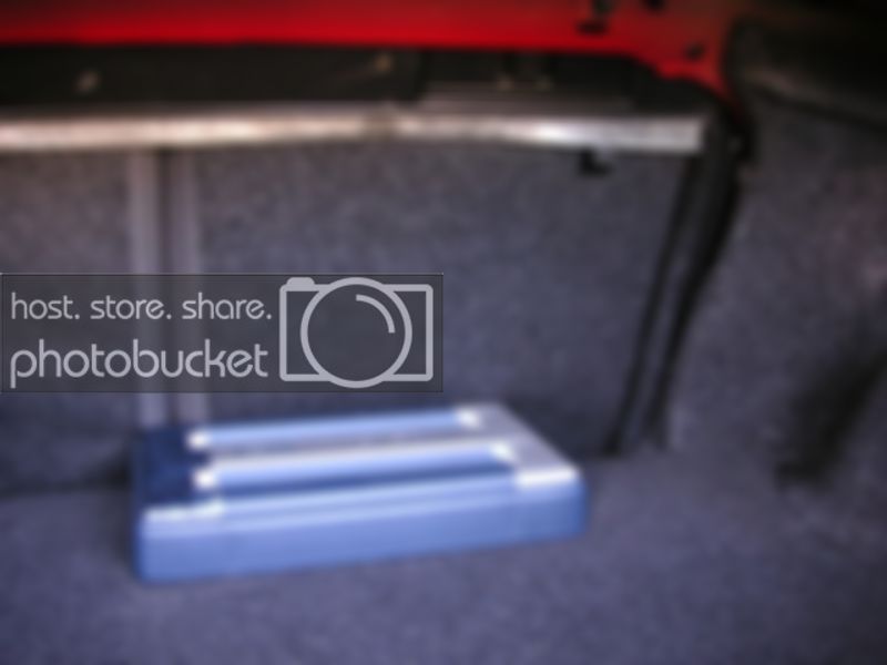

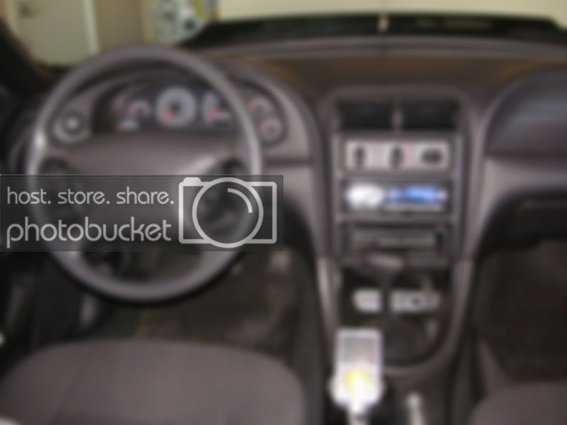

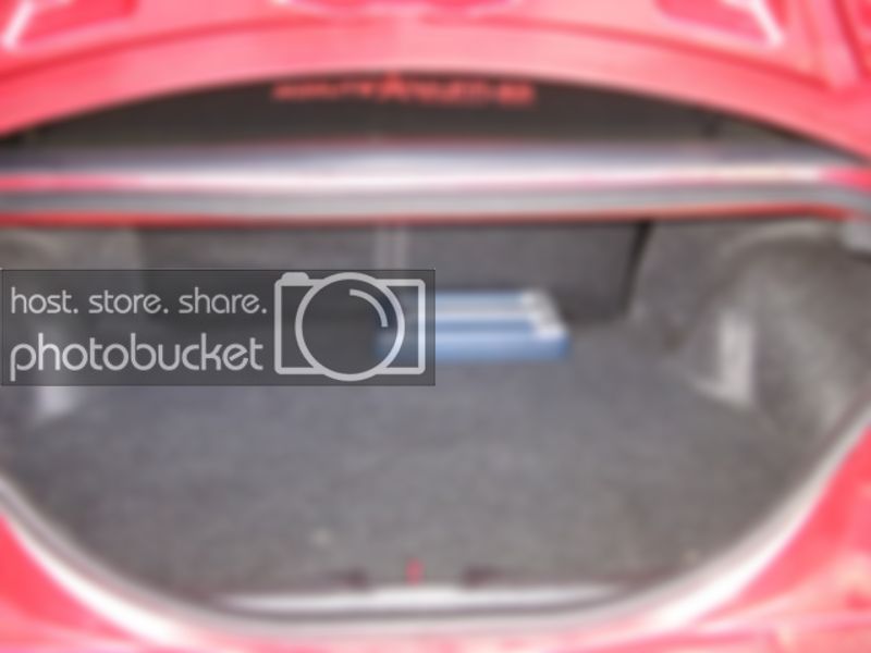

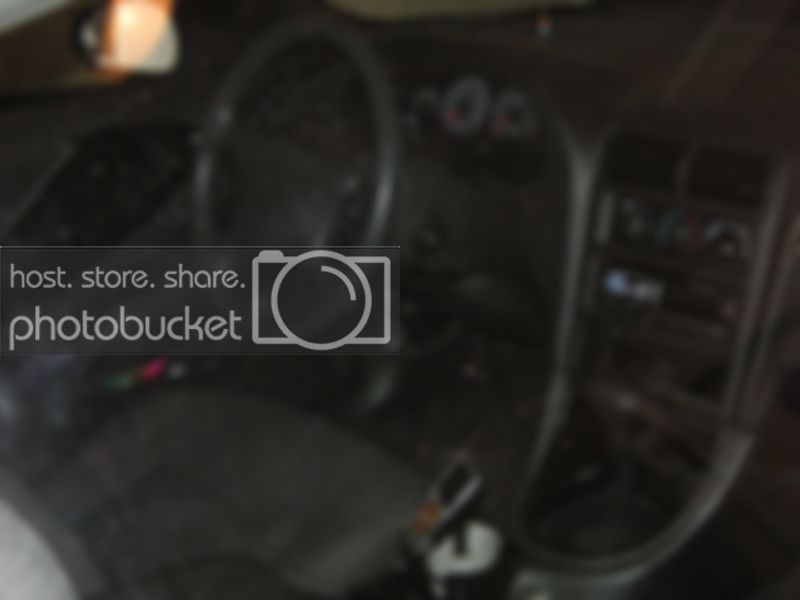

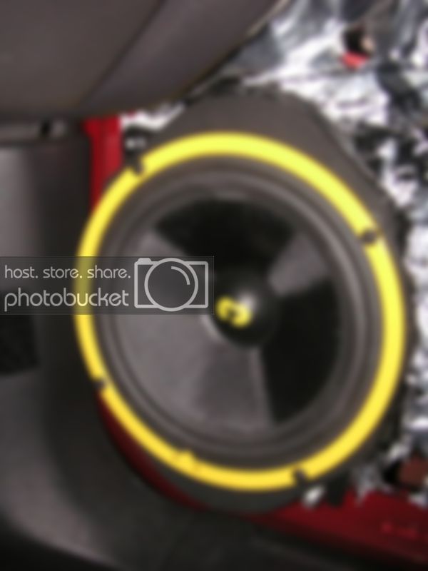

Here's some pics...
Cleanest trunk on CA.com lol
You can see it with the flash, but that is with a flash and no tinted windows. I think your 4inchers covered by the grille cloth and tints will be pretty hidden...
Yea I need more SD and its kinda ghetto, but I have plans lol..don't we all??
Nice. Thanks for the pics. Couple of questions. Where are your sub/subs? What size are those components and did you have to trim the door frame or covering? And are those tweeters velcroed on? lol
