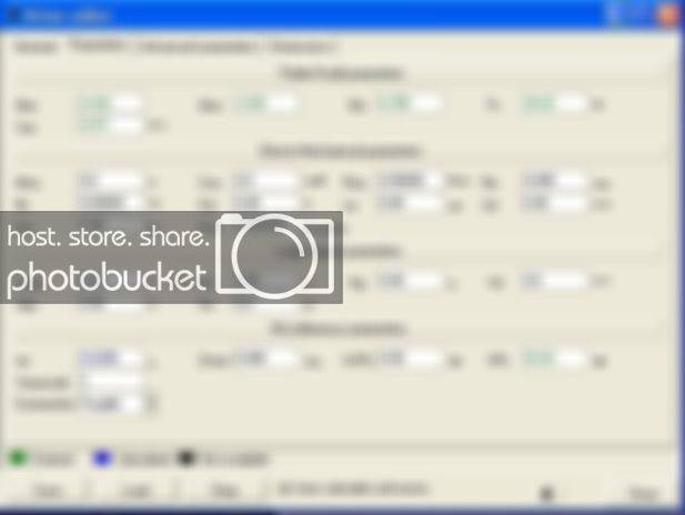

G Glock23 10+ year member CarAudio.com Elite 852 0 il Nov 18, 2007 #1 it's telling me the spec's for the qts,qms,qes are wrong but I just put in what the ID has in the PDF i downloaded from them. please help Click to read more...
helotaxi 5,000+ posts Kilroy was Here 8,961 73 South Central (New Mexico that is...) Nov 18, 2007 #2 Just enter Qms and Qes and let it calculate Qts. Its rounding error. The calculated Qts will be within .01 of what ID specified.
OP G Glock23 10+ year member CarAudio.com Elite 852 0 il Nov 18, 2007 Thread Starter #3 for qts is puts in .0138 and is blue and i cant save it
helotaxi 5,000+ posts Kilroy was Here 8,961 73 South Central (New Mexico that is...) Nov 18, 2007 #4 There is no way that Qts is that low. You entered something wrong. What are the Qes and Qms values that you entered?
OP G Glock23 10+ year member CarAudio.com Elite 852 0 il Nov 18, 2007 Thread Starter #5 0.424 = QES and 0.205
helotaxi 5,000+ posts Kilroy was Here 8,961 73 South Central (New Mexico that is...) Nov 18, 2007 #6 Qes should be 0.424 and Qms should be 2.02. Decimal in the wrong place. Makes a huge difference. Gives a Qts of 0.35
helotaxi 5,000+ posts Kilroy was Here 8,961 73 South Central (New Mexico that is...) Nov 18, 2007 #8 Delete the entry in Qts and let it calculate it.
OP G Glock23 10+ year member CarAudio.com Elite 852 0 il Nov 18, 2007 Thread Starter #9 0.350 and it goes BLUE (sorry for the delayed reply im talking to my father on IM
helotaxi 5,000+ posts Kilroy was Here 8,961 73 South Central (New Mexico that is...) Nov 18, 2007 #10 Blue means a calculated value. Calculated values will not come up as errors when you go to save. That's why I try to enter as little as possible and let the program calculate the rest. Prevents errors like this from happening.
OP G Glock23 10+ year member CarAudio.com Elite 852 0 il Nov 18, 2007 Thread Starter #11 ok it let me save it. i'll try to pull it up now with winisd thanks !
nauc 10+ year member CarAudio.com Veteran 3,665 306 USA Nov 18, 2007 #12 your Vas is wrong, its 5.71 cu ft, not .571 cu ft but that doesnt seem to matter.. i plugged in Qms and Qes into BBP and got a Qts of .351
