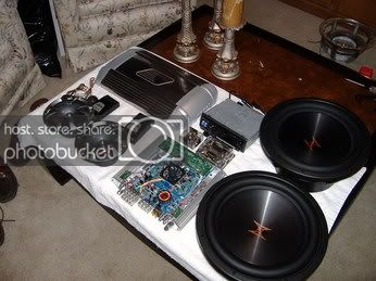

Now the Car audio...Here is my family

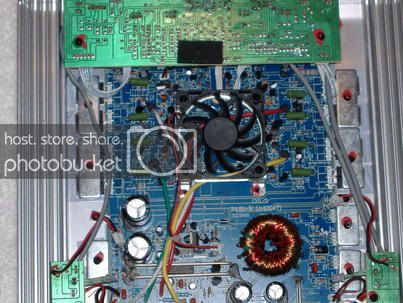

Guts of my Bastard Stepchild Amp or otherwise known as an Audiobahn A4004T

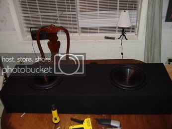

Now this is about the time I lost camera battery...So Fast forward 1 week, and now im carpeting the box...But here are the box specs... 1.5 net per chamber, Internally coated with fiberglass resin, and held together with titebond III and Drywall screws. (Alpineinstaller can vouch that I did the work while the camera was out of Commission)

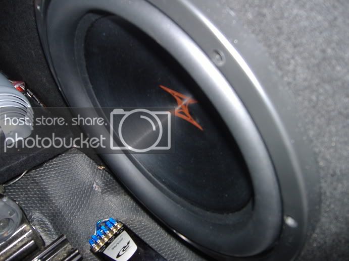

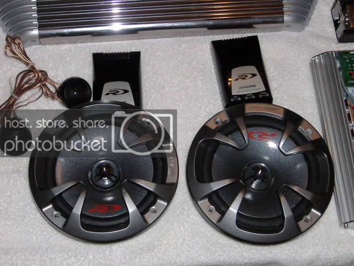

Type R Components

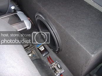

Now Installed pics!!!!!!!!!!!behind the seat

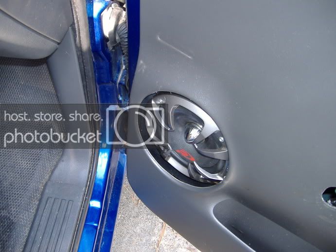

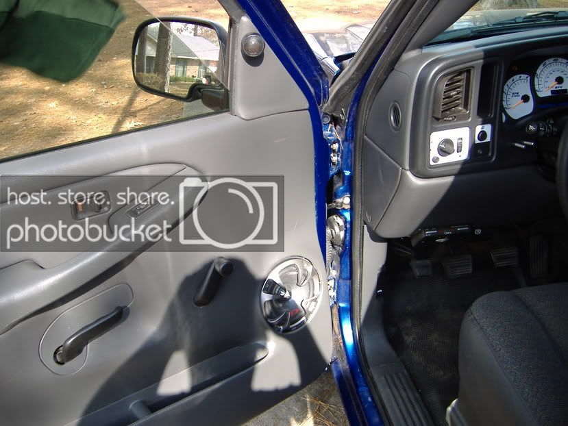

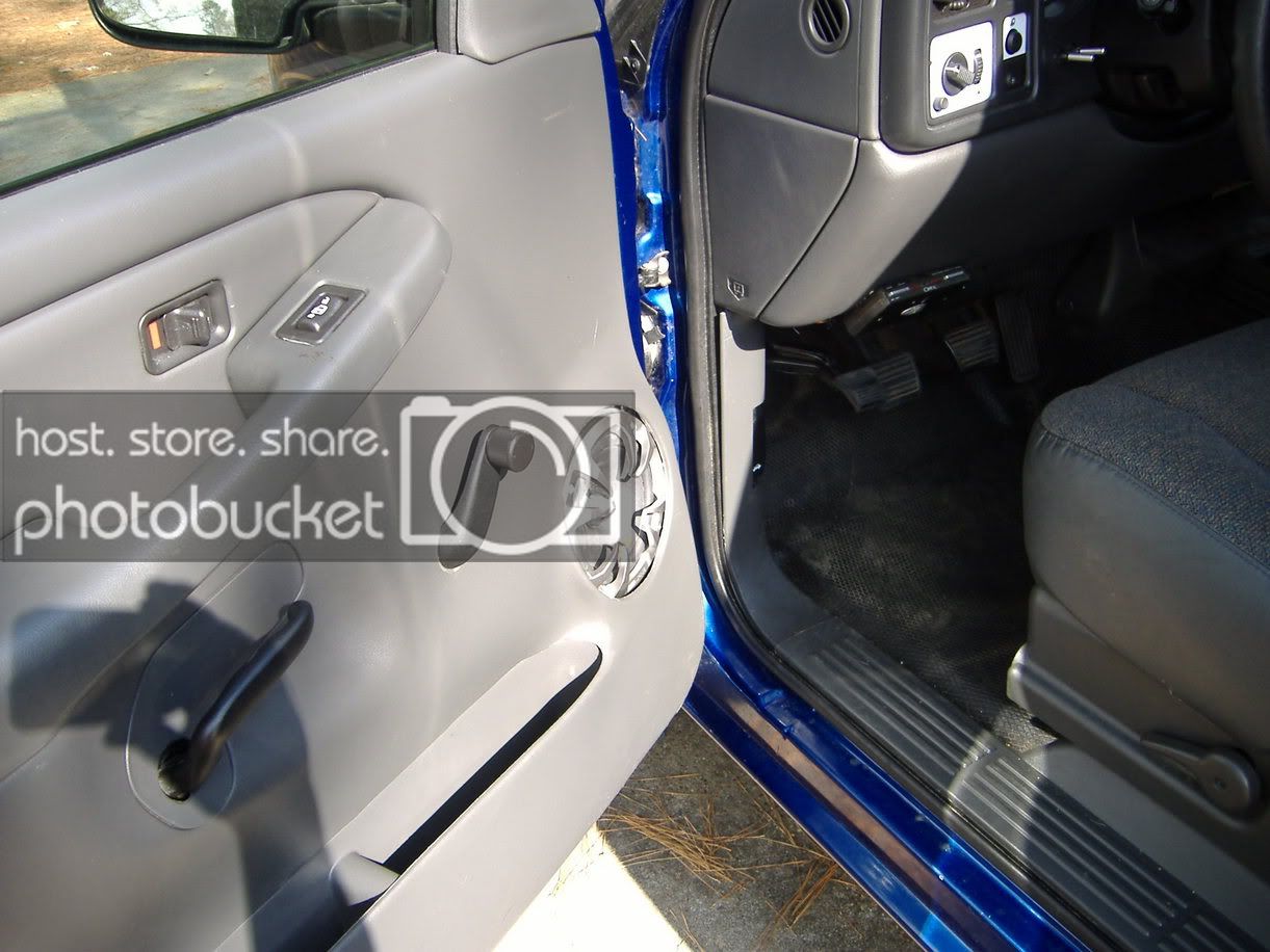

Door Pannels

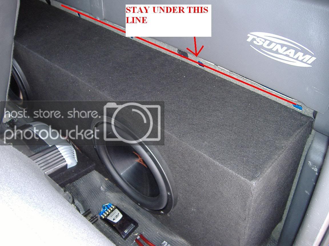

actual dimensions... 15 1/2 inches tall, 9 inches deep, and 55 inches wide. Im 5'11 and I sit comfortably, but some of my taller passengers complain. But the key to building a box in the newer chevy trucks, is to get it to slide up under that rear pannel that bumps out...well here is a picture. but overall it is still comfortable to ride in my truck, earlier today I drove 4 hours in it and I was fine.
