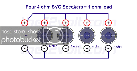

Wire the subs like this if you want your amplifier's full power (supposedly 900 watts):

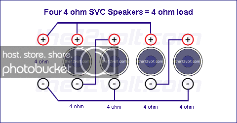

Wire the subs like this if you want the amp to see a 4 ohm load (supposedly 500 watts):
yes thats how i have them in the 1 ohm
but should i put the ends all together ? like 4 and 4 or 2 2 2 2 or it just doesnt even matter?
if you're doing what i'm assuming you just have all the ends wadded together into the amp...
put the first subs + to the second.. and then out from there to the next + then out from there to the next + and so on..'
then with the negatives.
dose not matter with that amp its a mono block having ++ and-- allows you to get more wiring in to the amp and allows you a few different ways to actually wire your subs just use some decent wire 14g ot 12g and go from one + to the other one - to ther other on each speaker to the other to the other to the other then to the amp
